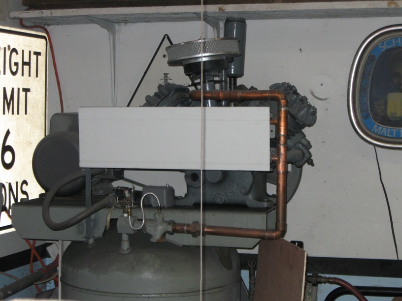

    Joined: Feb 3, 2006
    Posts: 516
    uc4me
    It'd be cool but for the time and headaches involved I think you'd be better off finding an older reciprocating compressor....heres a pic of mine, its a V4 Brunner, you don't even have to raise your voice to talk to someone when it kicks on
