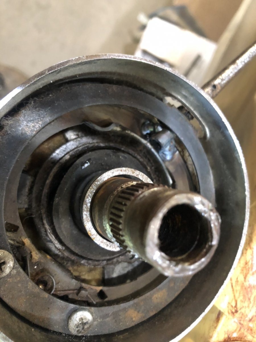

    In a misguided and pointless attempt to clean up (even a little ) the rusty blinks stalk I instead broke it. Not the steel stalk, but the fragile, delicate little sheet metal holder/self cancelling plate screws into. Ugh. 3 hours later I have it welded back together, drilled and tapped the stalk and the little bung it goes into on the plate for a 10/32 stud to reunite the two and back together. I swear I’d be driving it right now if I didn’t do stupid stuff like this...

    Notice I also buggered up the threads on the shaft? That was fun to chase with a tiny three sided file too...

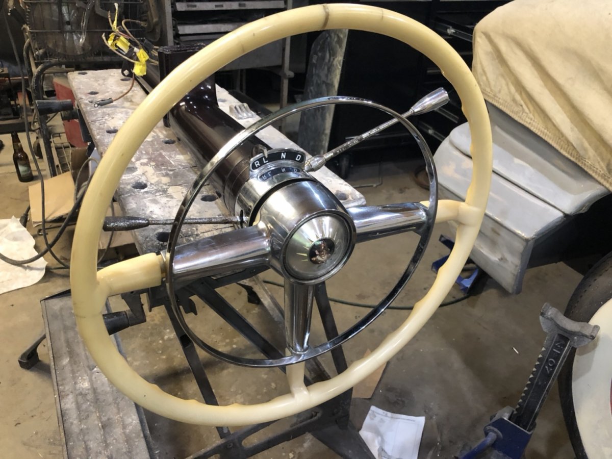

    Behold, the glory, the CLASS, the STYLE , the smooth power of the 1952 DeSoto FIREDOME wagon! How much do we LOVE an ivory steering wheel an matching radio? I KNOW!

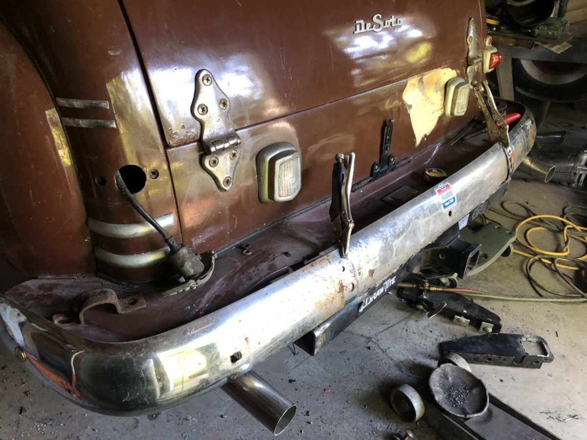

    Matching the front there’s a ‘49 Chevy bumper out back, narrowed a bit, and a Drawtite frame hitch in progress.

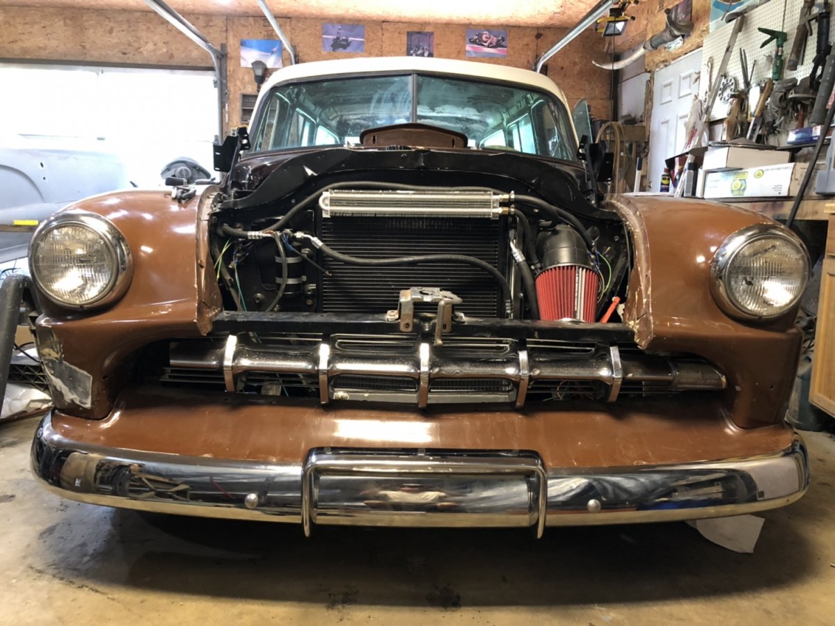

    The front bumper arrived today and I hung it along with the new license guard from Speedway. Less is more.
