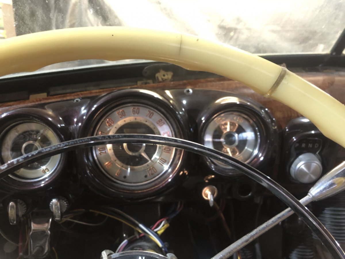

    flynbrian48
    Hahaha! The speedo sweeps to that, not zero when the ignition is on. I have to call "Instrument Repair Services" and see if it will reset to zero when the gauge is calibrated. The stupid clock, that I spent $200 on, ran for a day and quit, so that has to go back.

    If your speedometer cable is to long it will put pressure on the speedometer magnet and press the speed cup
    causing the needle to stick. Check the bottom end, it should stick out from 3/4's to 1 inch., no more. At the top it should stick out 3/8's of an inch passed the ferrule. Unless that is that is it was converted to electric?

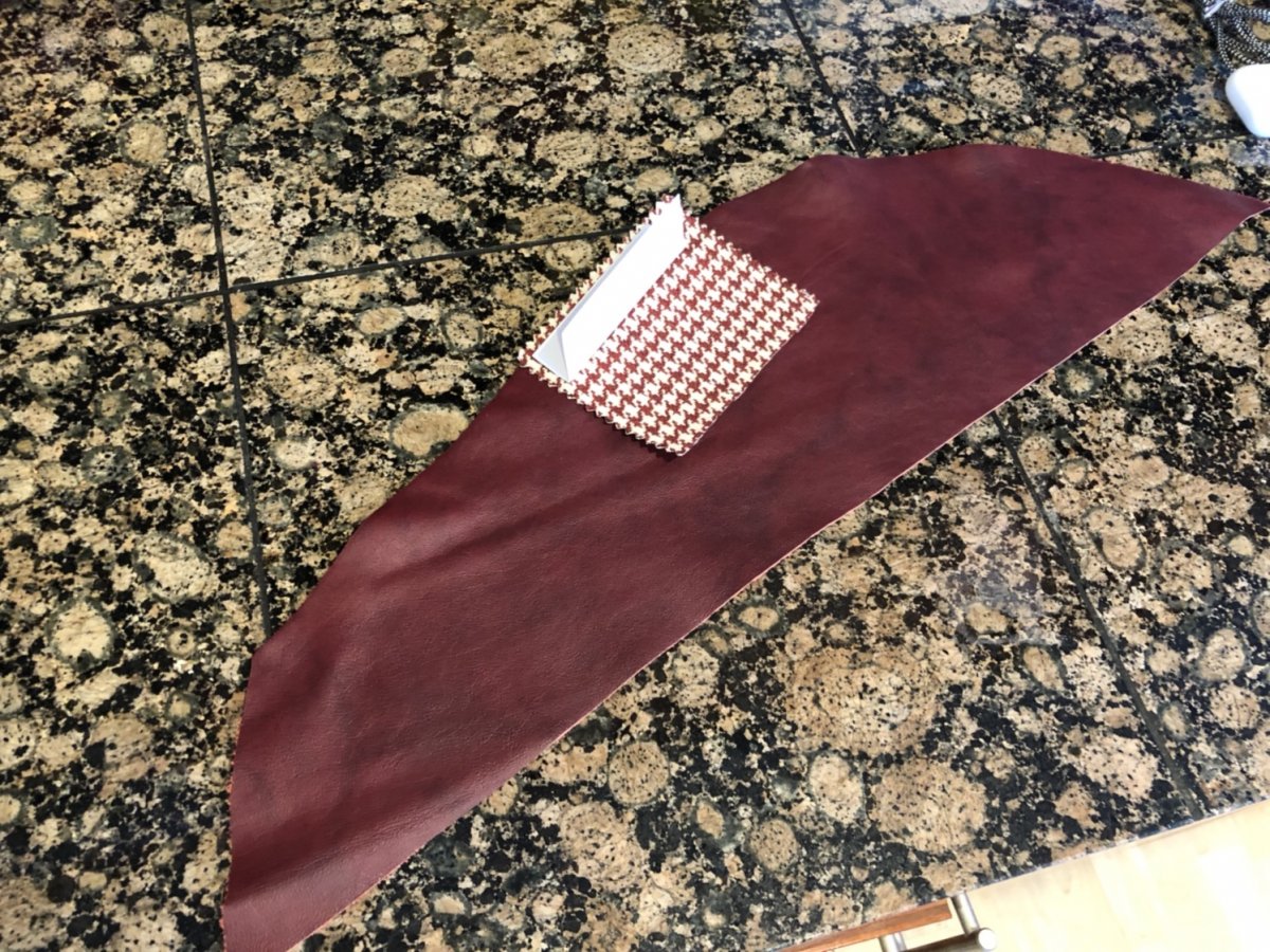

    To the upholsterer we go! It took a while, but enough cows finally died to get leather... 9613E6EF-4F3E-4E34-AD14-FC727545CC20.jpeg 3C056F20-76E7-4EBA-96B1-3AFF80AFCE3B.jpeg BCFB7DC8-5E61-4822-8AA8-E1AE15840E05.jpeg 043869EA-32F3-4840-8390-C5F894A9C9E5.jpeg

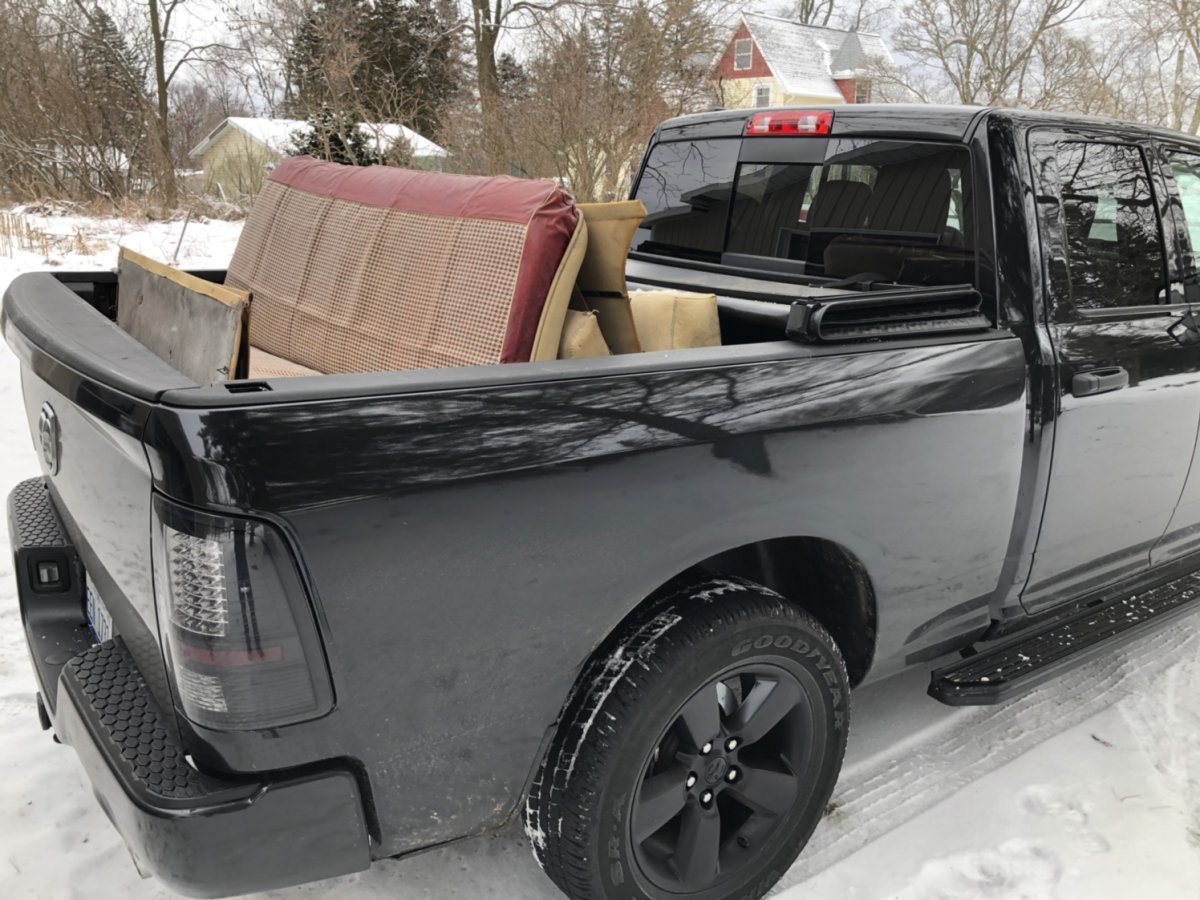

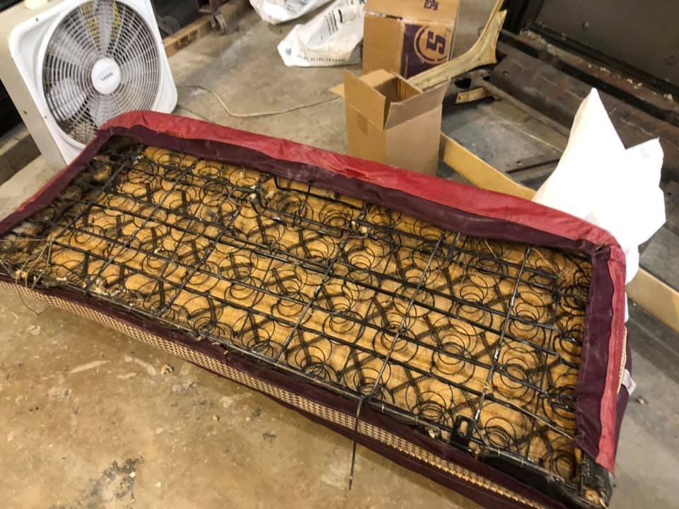

    4 hides, 5 yards of fabric, off to the upholstery shop we go.

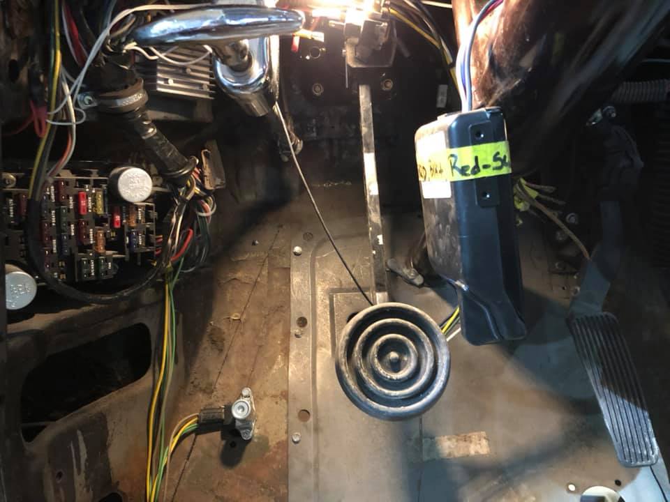

    The guy doing our upholster called and he's gotten started on the seats, and would need the kick panels and the sun visors (which I'd completely forgotten about). So I had to get busy and make kick panels, which meant I had to spend an hour under the dash looming up the harness out of the fuse panel. It's a job I was putting off, but it had to get done. I started sanding door jambs to get them painted before the headliner goes in. He's going to come to my shop, set up and make that and the carpets. Busy, busy! E2F8E9E7-CB94-4DD5-B513-6E201FA8CC9D.jpeg 3094E821-DD0D-45C6-8439-2E79B64D0D72.jpeg

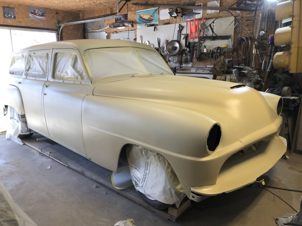

    FINALLY! I got primer in the wagon! Only one small issue, how did I not notice until JUST now that I missed filling this rocker molding hole? [emoji849][emoji23]. Just trying to stay humble I guess...
