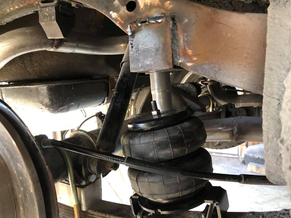

    We're going to be towing with this car, so the rear suspension had to be up to the task of a full load of stuff in the car, and the 600lb tongue weight of our trailer. I didn't want air shocks, in fact I couldn't use them because the tailpipes are too close where they kick over the axle, and the leaf overloads I'd put on the Pontiac wagon didn't seem to add much capacity, but they did make it ride terrible.
    The answer was these air-bag overloads, intended for a late model pickup. They came with brackets intended to hang them from the frame rails, as the leaf springs in all of them are outboard of the frame. It was a pretty simple job to use the upper bracket on the bottom, so the fitting clears the spring. A simple angle iron bracket on the frame rail locates the top, there's a locating pin in what would have been the bottom mount of the bag, I drilled a hole in the bracket that the pin fits in when the suspension is loaded. They're from a company called "Airbagit", the "kit" was inexpensive, the stuff looks like good quality, and best of all, I can keep the low stance, air them up with the included on-board compressor and ad load capacity when we want it. 0111EB4A-F9E2-4C8B-B8F2-70A72A1021AA.jpeg F6A37991-470B-4DA9-89C9-A5EF73D57CDD.jpeg

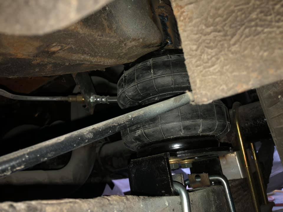

    I got the bags plumbed to the switch on the dash, but the kit didn’t have enough line by another 5 feet to get back to the compressor. So, I ordered 20 feet, and set the car back on the ground. The little box on the frame is the air bag pad, the gizmo is the dash mount switch and gauge for the bags, it'd have been great if the kit had contained enough air line to get from the bags, to the gauge, and back to the compressor. This car isn't that big... IMG_3089.JPG IMG_3088.JPG IMG_3087.JPG

    I finished up the air-bag overload springs today. Unfortunately, there’s a problem with the compressor, it runs but not from the switch in the controls, it has to be “jumped”. They’re sending a new one. Meanwhile, it’s holding pressure, the picture is with 50 PSI, about an inch and a half over static, but we’ll only use them with the trailer(s) hitched. I made some insulators for between the bag and upper pads with an old tire and a hole saw and longer locating pins that don’t fall completely out of the bracket if the car is raised. I was concerned they might come out with extreme suspension travel. I feel better about them now.

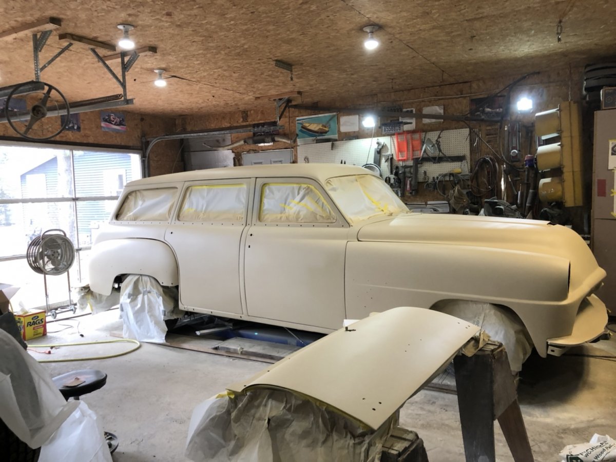

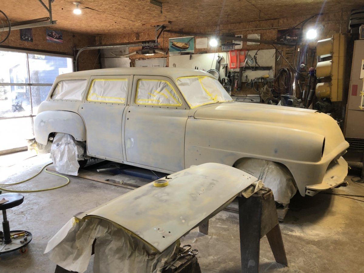

    I thought I’d get the final coats of high build on the wagon, but of course found a couple places I wasn’t happy with. By the time I got those ready, the car wiped down and seams blown clean, the roadster covered up, it’s time to quit. Tomorrow...

    I shot two double wet coats of FeatherFill on the wagon today wit my new, ridiculously cheap HF gun. ZERO overspray, all the material goes on the car, not everything in the shop and the floor. I covered the roadster with plastic, no dust on it at all.
    I love this thing!

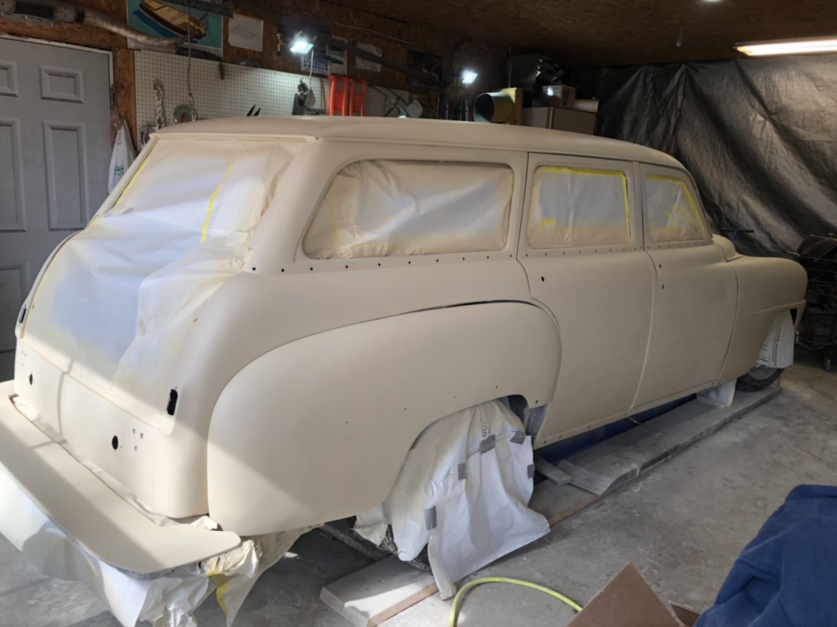

    Well, I’ve been around the car correcting the tiny imperfections the guide coat revealed, fixed them, went around again, fixe a couple MII found, shot some primer on those spots. I’m done. Now to clean up a bit, curtain the shop with visqueen and get some color on.
    I decided that I’ll paint the roof the dark garnet color of the lower body and do just the window frames white pearl. Someone in our vintage trailer group tows with a ‘53 DeSoto wagon tu-toned that way. I proposed that to my wife, who said, “That will make the car look lower too.”
