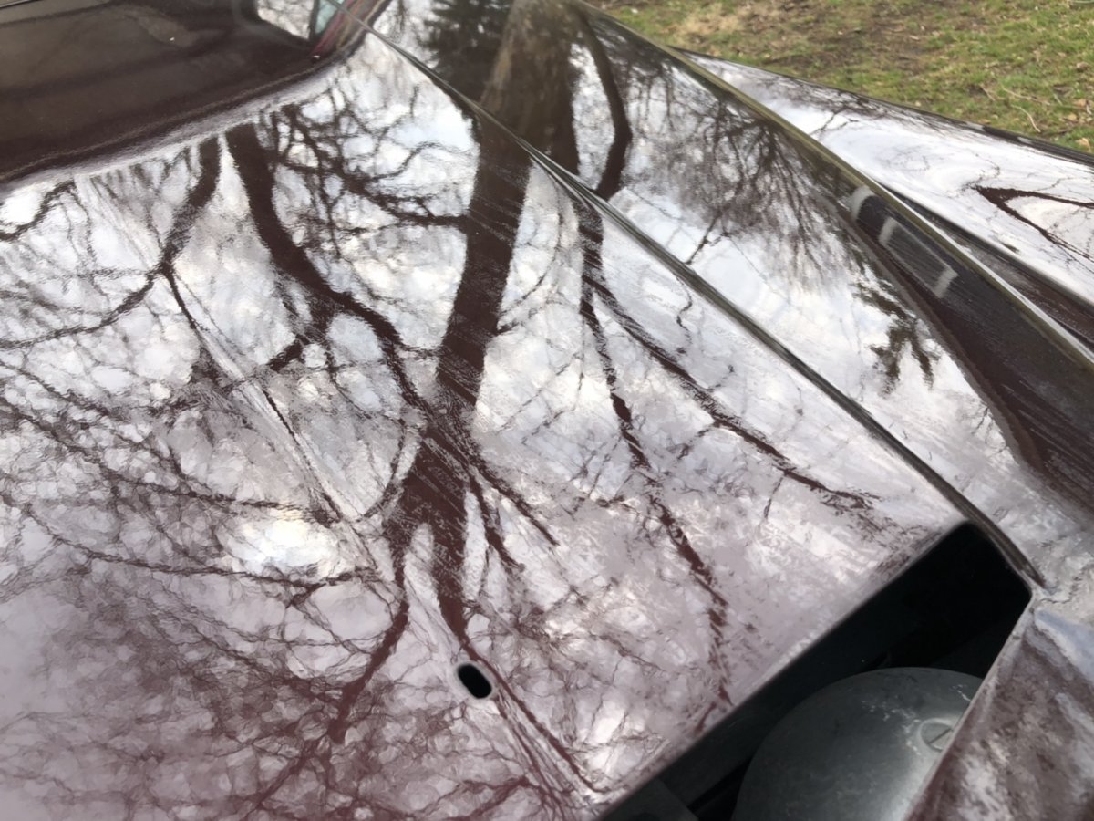

    Crap. When I pulled the mask film, it adhered to th clear on the roof and hood. So, I’ll be polishing it it for sure. A disappointment, but it’ll be better cut and buffed.
    Now I know what happens when you mask 4 day old clear...

    This was the worst. 1200 grit, quick pass with compound and will bonnet took it down. Dodged the bullet here...
