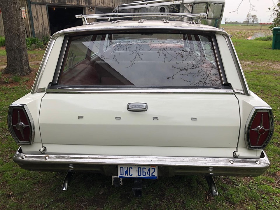

  23. flynbrian48
    Joined: Mar 10, 2008
    Posts: 8,637
    flynbrian48
    I (briefly) considered making some hidden hinges for it before I painted it. I had to make all new hinges for the tailgate of my son's '65 Ranch Wagon, they were pot metal and had broken into like 4 pieces each. It wasn't too tough to reproduce them with some 3/8" boiler plate, bronze bushings and shoulder bolts from the hardware store. This would have been more challenging, as I had no patterns to go by, not near as much gap between the body and gate, and I'd have had to cut notches in the gate for clearance, so I followed the "If it ain't broke, don't fix it" method. I'm getting used to them, although they stick out like a sore thumb, no matter what the finish is. 60010385_10219789275824991_1819370411696062464_n.jpg

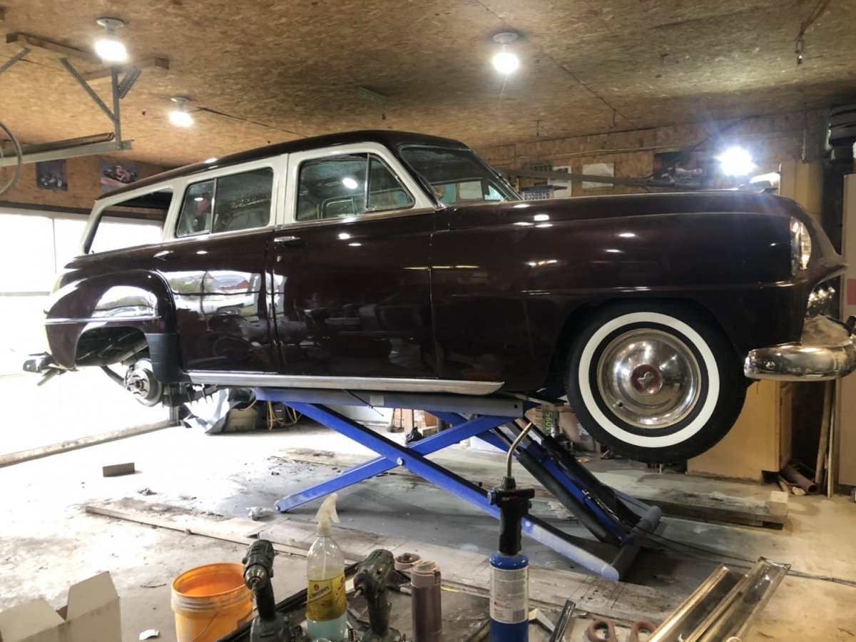

  26. flynbrian48
    Posts: 8,637
    flynbrian48
    It’s out.

  28. Nostrebor
    Joined: Jun 25, 2014
    Posts: 1,321
    Nostrebor
    It's amazing how much the bumper changes lightened up that car. It really is coming out nice!
  29. flynbrian48
    Posts: 8,637
    flynbrian48
    I think the single best body mod I did. I HATED the originals, largely due to the silver paint the PO had covered them with.
