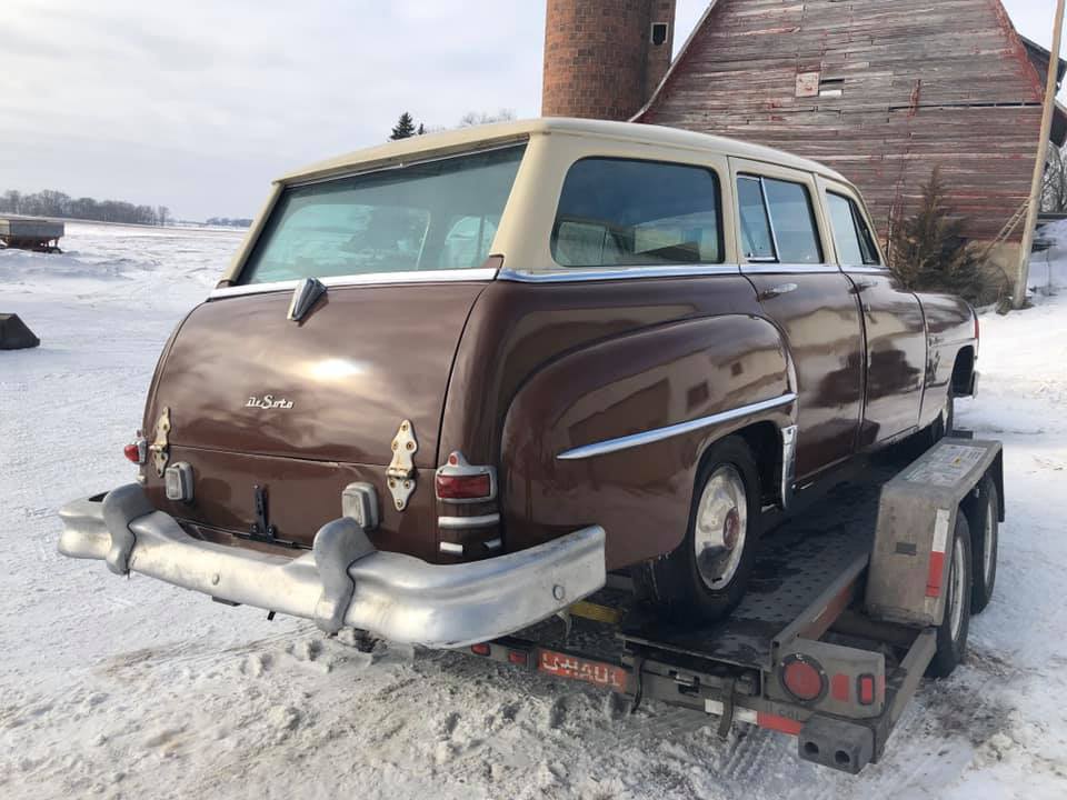

  1. To me, the '49 Chevy tail lights look somewhat similar to the stock lights on this '50 DeSoto Woodie Wagon. I like the overall look, and I don't see anything wrong with the painted tailgate hinges. Screen Shot 2021-04-24 at 9.18.43 AM.png

    It's just my opinion, but I think that the Chevy tail lights look better on Brian's car with the slanted C (D???) pillar (and entire rear of the car) and the stock tail lights look better on the woody with the nearly vertical D pillar.

    This car had tiny horizontal lights just above the bumper in the quarter panel. The pot metal housings are WASTED (like every piece on this thing), hence the switch to the vertical Chevy lights. Which I mounted higher, like the earlier DeSoto woody in the photo you shared. They required a little trimming and a little fillet (I used Mar-Glass) to make them fit the somewhat flatter contour of this car compared to the Chevy fenders. I think they work. The back up lights are '46 Ford front park lamp repops with 1157 bases, I have red LED bulbs, so they're now additional taillights. In addition, I'm putting an LED light strip intended to go beneath a pickup tailgate on the stainless window channel at the top of the tailgate opening. It's gonna look like runway lights...

    I also looks like the woody had bumpers that were not as imposing as the Stock ones on you car. I sure like what you did with the bumpers. Big improvement

    Yes, the '49's and '50's were much more "restrained" than the '51's and '52's. Without them, the car has really, for a MOPAR of the time, very crisp lines. I particularly like the line of the top, which is flatter crowned that it's GM and Ford contemporaries, and the canted C pillar. Without the toothy grill teeth and extra gingerbread, the front end is as clean as any custom Merc to my eye. Less turns out to be more.
  8. Bryan, The rear bumper swap looks like what they should have done at the factory, the huge bumper the car was born with looks like a after though, what you have done makes it more pleasing to the eye, you sir are a man of vision. HRP
