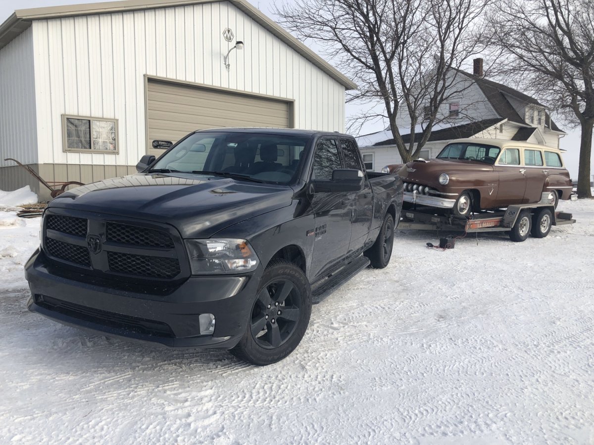

    Got it! Three on the tree behind the 276 too!

  18. Are those the OEM hinges for the tailgate?
  19. ... That's a big ass back bumper! ... ;)

    Yes, they are original ....
    Yep, but it is factory stock rear bumper.

    We're home with it, it's in the garage. I went through through the parts tossed in the back to see what we had and what we'll need. The chrome die cast parts are all horrible, which is why everything is painted silver. I'm not going to worry about it yet, we'll focus on getting it mechanically done and the interior first. The body is SUPER solid, the paint job is a very amateurish one, but it's solid an relatively straight. The 276 is gonna be available, so, hot rod engine anyone? I think it's a fluid drive, the clutch pedal says "Safety Clutch". The column shift is all apart, no lever, so I can't shift it, but it seems to be in neutral. I put a battery in it and jumped solenoid, rolls over, oil is clear. I'm not going to do anything with the engine but pull it.
