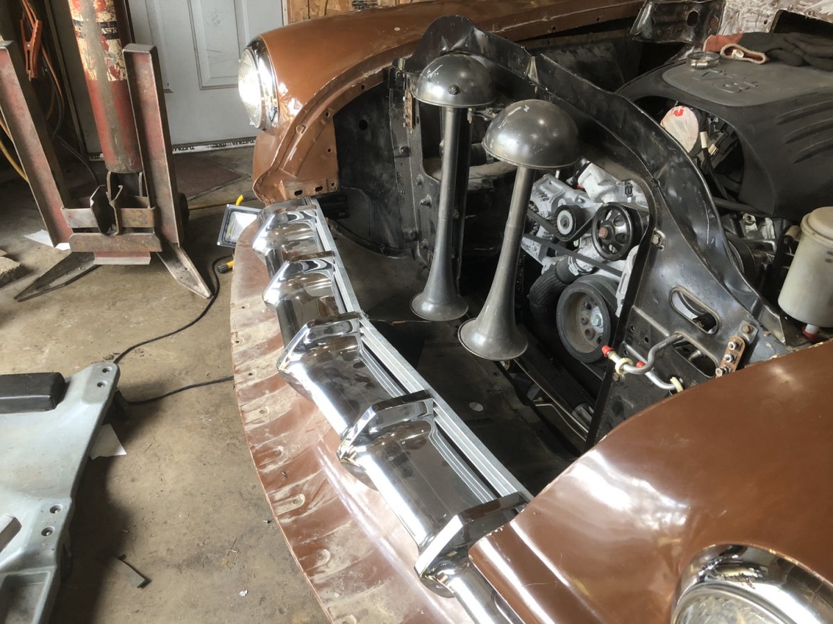

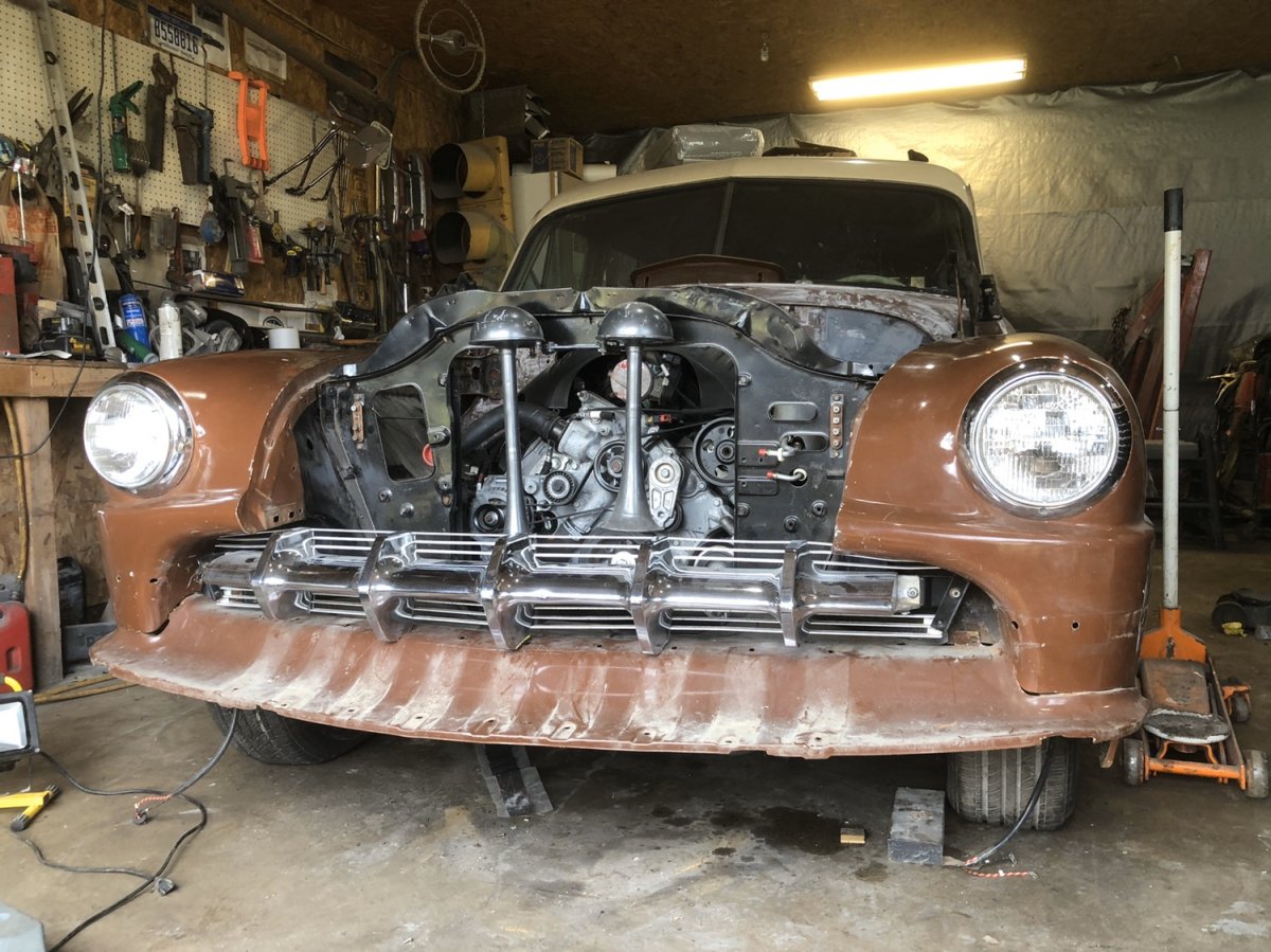

    flynbrian48
    Here's the '59 Imperial grill I'm going to use instead of the roached original grill teeth in the wagon. I never liked these Mercury grills... There's my extra dash too. I'm going to use some of the stuff on it, the trim, radio delete, and speaker grill cover. 91342295_10222801057797658_5542884719756050432_n.jpg 91301149_10222801058157667_4642239264719896576_n.jpg

    ‘59 Imperial grill. How’s that grab ya?

    Certainly better than this... 81459239_575128066493612_7636733473293598720_n.jpg

  24. It works!... are you going to "lighten up" that front bumper as well?

    Lighten up, as in, I'm not going to use it. ;) A buddy of mine from Windsor has a '55 Dodge (I think) front that'll look much more better.
