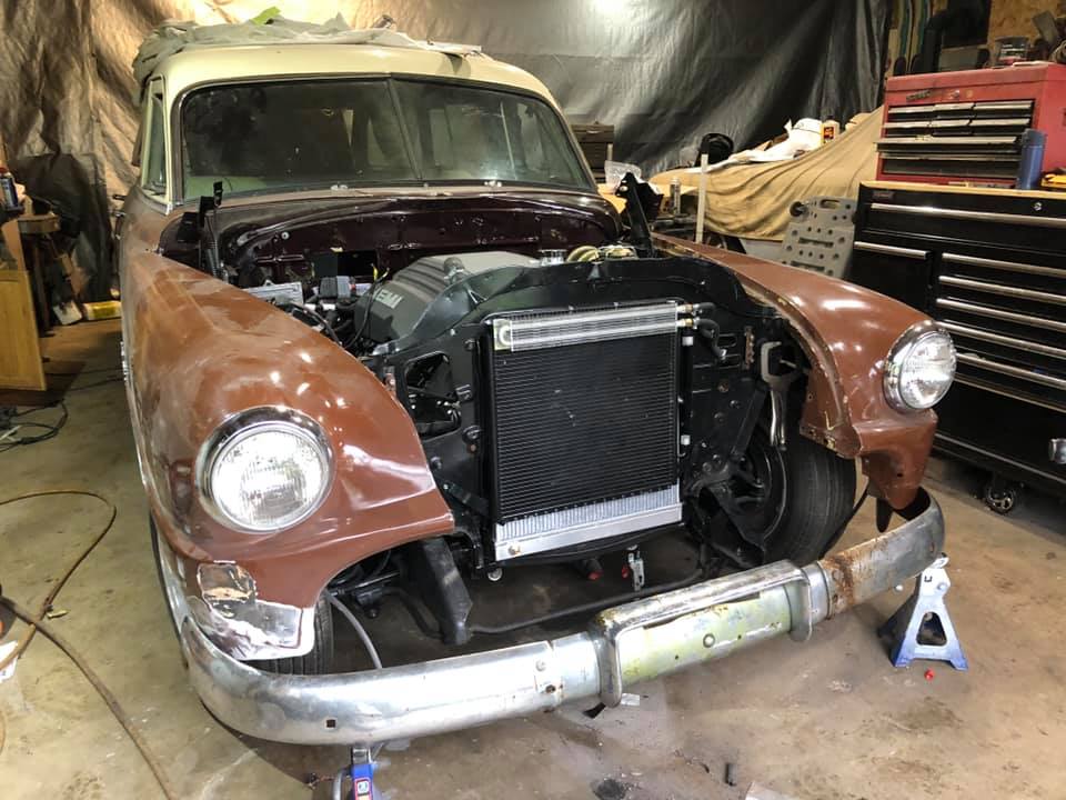

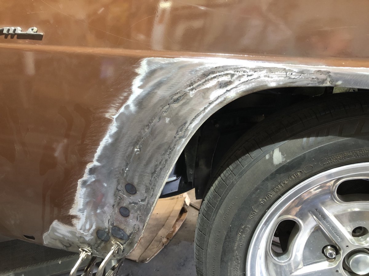

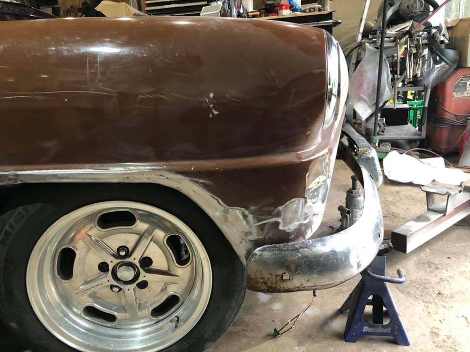

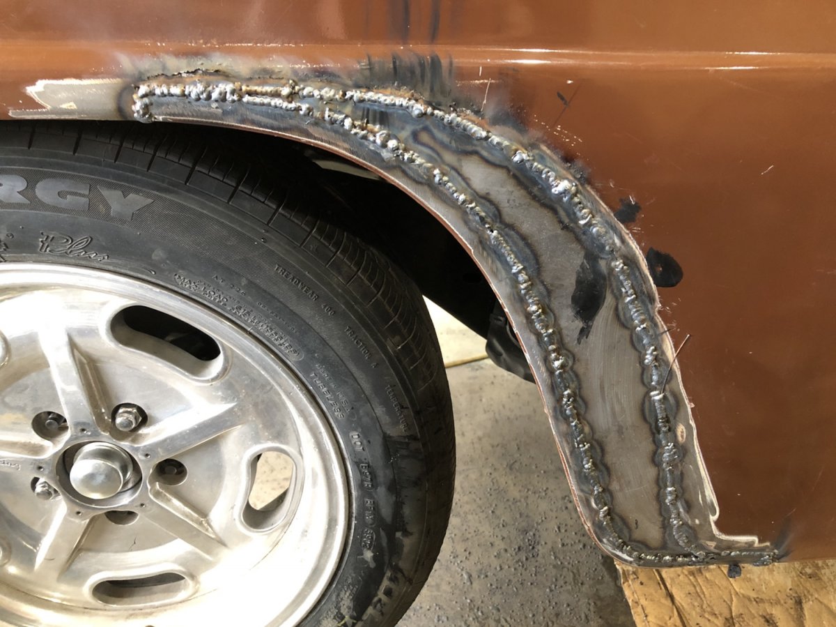

    Latest on the wagon: evidently, I’m incapable of accuracy while measuring. Somehow I got the spindle centerline wrong in the suspension, and the front wheels are a skosh further forward than the should be. The core support IS correct, but I have an extra inch of wheelbase.
    So I moved the wheel opening. Front lip an inch, the fear I brought forward 2 1/2”, to tighten the opening up around the wheel. I’m also filling extra holes in the fender where the trim mounted, not using the original teeth and fender spears.
    I got a wiring harness and fuse panel from Speedway and have that started. The car came with a new, correct linen wrapped harness in a box, but half a dozen in line fuses under the dash is not up to par...

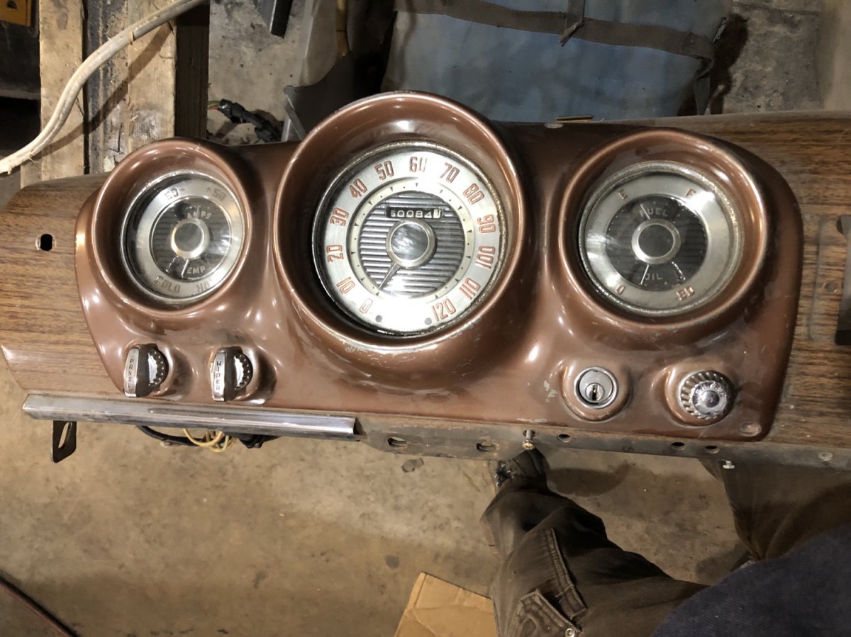

    The original gauges I sent to be restored, after you guys talked me out of modern ones that don’t fit just right. Cost is about the same.

    Who are you using for the gauge rebuild, and what will it entail?
    Thor1 and loudbang like this.
  9. flynbrian48
    Joined: Mar 10, 2008
    Posts: 8,632
    flynbrian48
    Instrument Service Inc, in IL. Electronic speedo, ammeter to voltmeter, water temp to electric, new fuel gauge. About the same as new gauges. I think these are ‘54’s, I like them better than the ‘52’s.

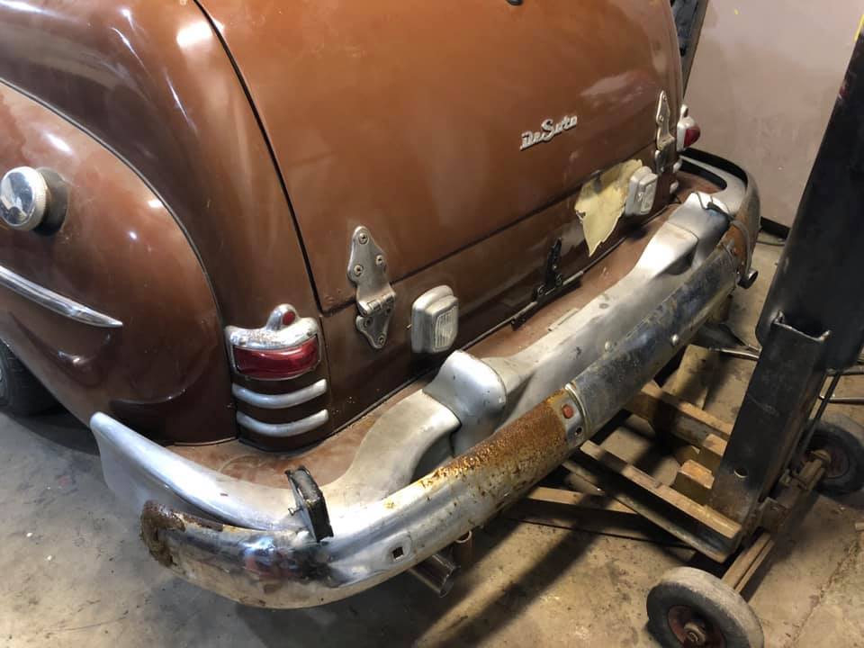

    Hideous bumper problem solved. 49 Chevy bumpers, front, at both ends. Available cheap from "Chev's of the 40's". Buh-Bye big ugly bumpers. 98425419_10223429749834566_4664915648365723648_n.jpg 99011040_10223429748714538_3429210435834871808_n.jpg 98159460_10223429747754514_7989770327506812928_n.jpg

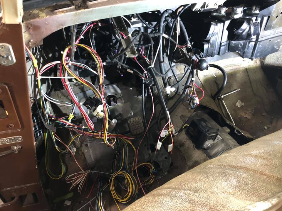

    Now, the pink wire with the black strip goes to the yellow, or the dark blue with tan stripe? 98330214_10223441951499600_5856893588402601984_n.jpg
  13. Ohhh I don’t envy you....
    loudbang, Thor1 and chryslerfan55 like this.

    What is the width of those bumpers, fender to fender? I like the looks of them, might consider them for my car if they are wide enough.
    chryslerfan55, Thor1 and loudbang like this.
  18. flynbrian48
    Posts: 8,632
    flynbrian48
    I'll measure for you later today, but I can tell you the front fits "As-Is", although I'll have to trim the apron, and the rear tucks around the rear fenders without a recess like the Chevy and Pontiac wagons. I'm using two front bumpers because the rear of this DeSoto is rounded, and the GM "Tin Woody" wagons are flat, so the front bumper fits better. It also has a shorter "tail" that wraps around, which is what I HATE about the DeSoto's. Plus the chrome is wasted on 'em...

    I got a little more done on the wiring today. Happily the car came with a new original style wiring harness that has a schematic, color coded and number on every wire and a key do I could sort out and identify the wiring to the turn signal switch in the column, it'll be easy to splice into the Speedway harness for the GM style column. 101575076_10223583300913247_1468516796733587456_n.jpg 101680855_10223583411556013_5405050543393472512_o.jpg
