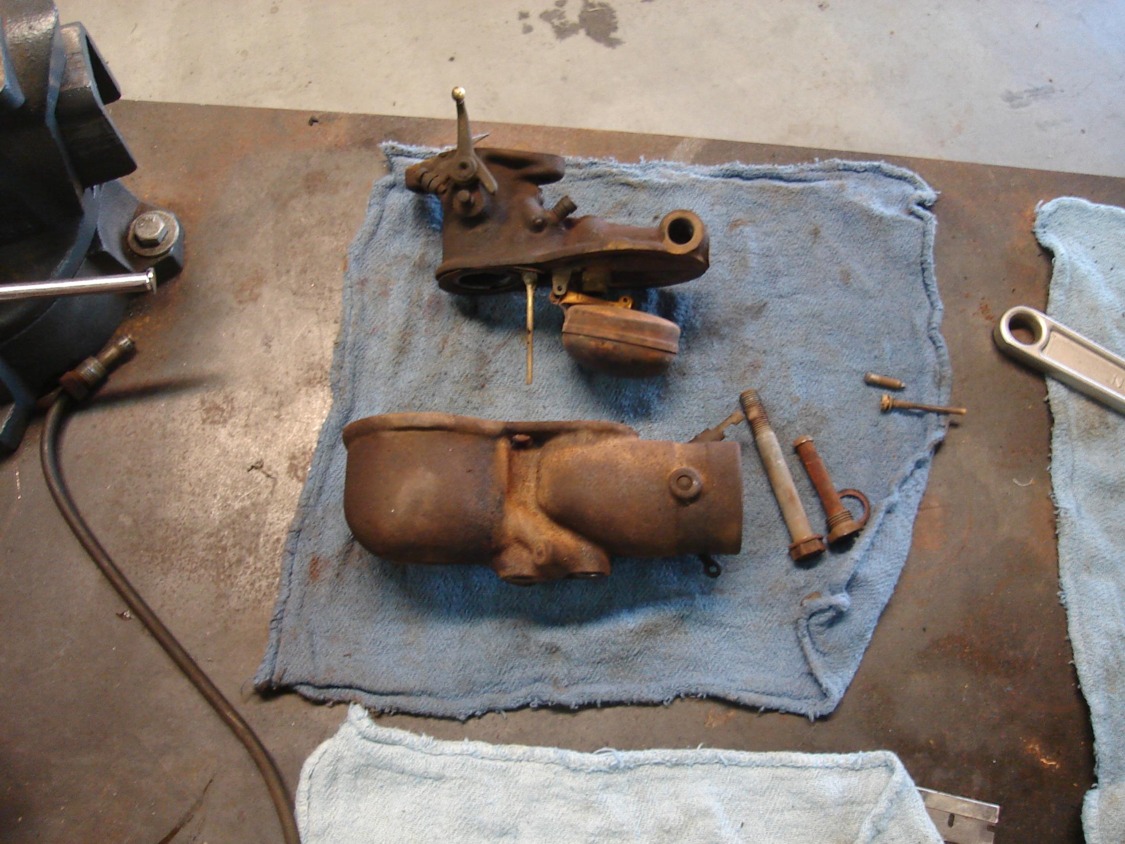

    Just got done messing with the pickup again. I decided to pull the carb and see if I could swap it with another. Once i pulled it off, I realized they were both Zenith's, but slightly different. Note the fuel inlet on the 2 carbs. Anyways, the fuel line did not want to snug up on the new carb, so I dissasembled the OG thinking I could use the top. Well, once apart, I noticed a cracked sleeve inside. See pics...

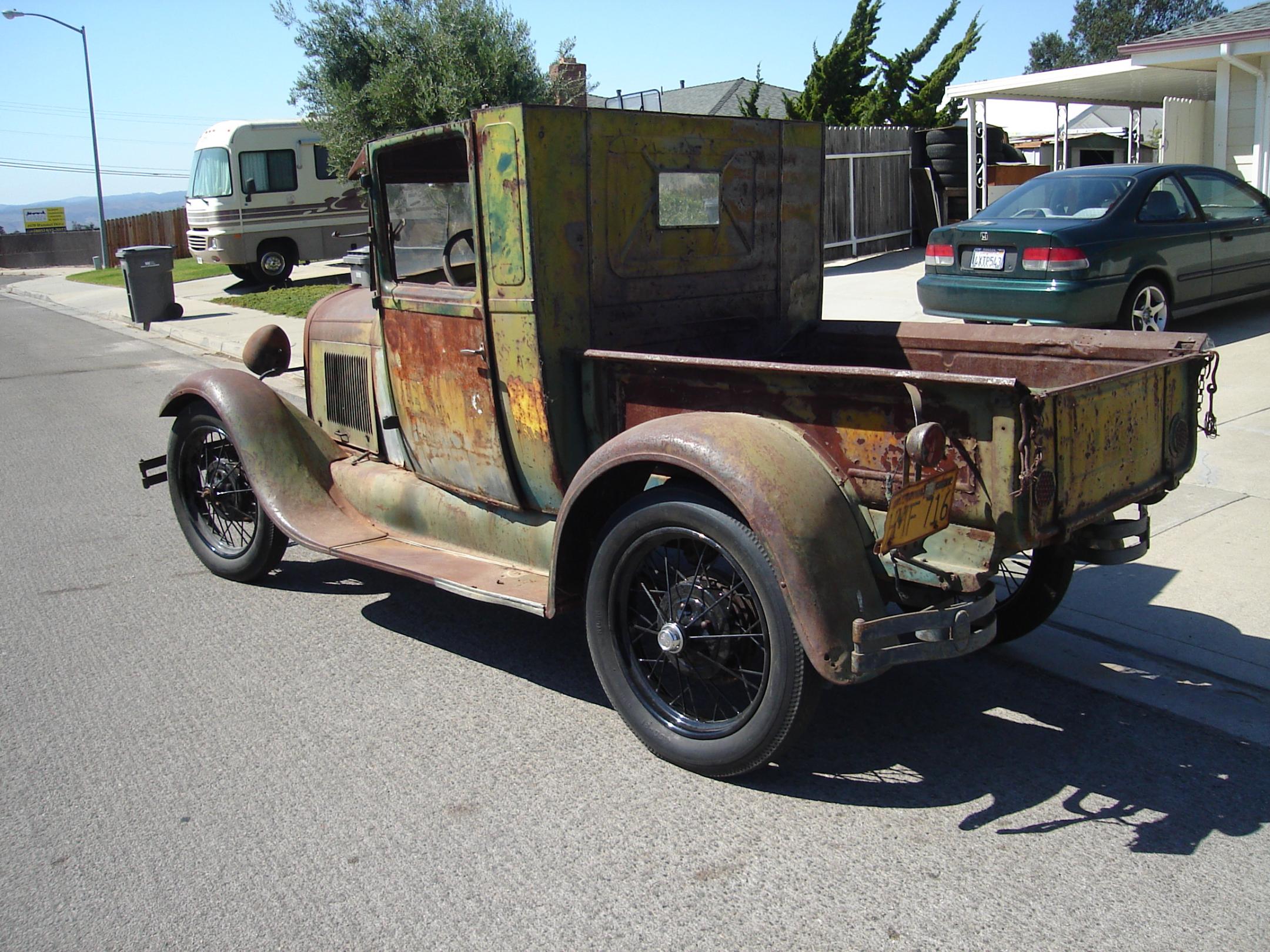

    So I took my coupe over to the brake line shop, and we fabbed up a fuel line for the new carb-sediment bowl. Also, I just put a small hose clamp on the choke cable. Brake line, now thats a good idea! Heres what it looked like today...

    And this is what happened! She ran pretty damn good! Still some bugs to work out I think, but WAYYYY better than this weekend. Im going to drop all my fluids and clean everything up. What are you guys running for engine, ******, rearend oil? Anything special?

    That cracked "sleeve" is actually your "removeable" venturi. I can see how that would create some issues.
