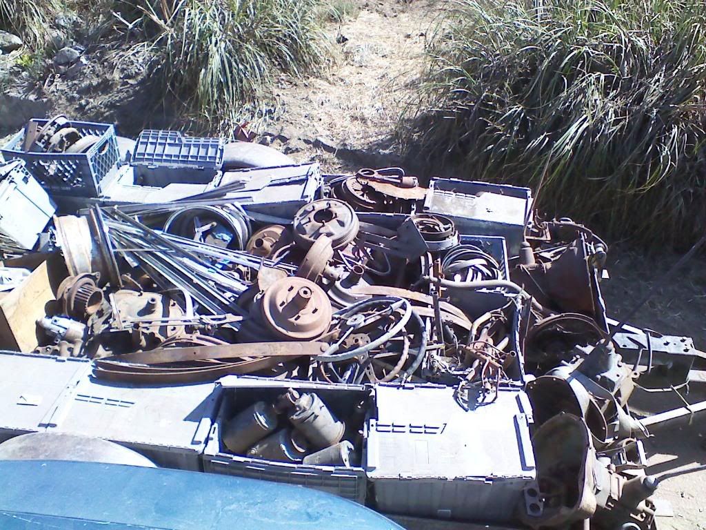

  17. Got another parts cashe yesterday outta Los Osos. The pics below are what was left from a restorer of Model As and early flathead V-8 ford powered cars/trucks. Lots of drums and odds and ends mainly model A but a couple of wide 5 and double A brake drums also. Still have not gotten through all the crates. Mainly stock stuff, no speed parts yet :eek:. PM me if you see anything that interests you.-Weeks
