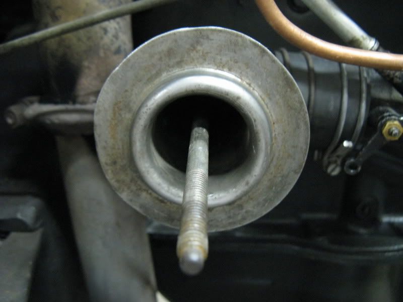

    Built myself an air breather last night out a 62-64ish briggs & stratton farm engine breather. the breather originally would have been standing straight up but i have turned it on its side. i can still fit a side panel if i ever decide to run them.
    Cut 3" out of the tube and welded it back up
    extended the carb end so a coupler could be clamped on
    cut two openings in the lid, then i tacked a nice woven stainless mesh behind them
    Some rad hose and clamps, very solid!
    I like the fact there is a little velocity stack
    Test fit
    Painted, but still need to find foam element for the inside and make a stainless bottom to seal the lid.
    I like it!
    a new fuel line is in the works btw..
  25. BCCHOPIT
    Joined: Aug 10, 2008
    Posts: 2,601
    BCCHOPIT
    looks cool but I would keep the foam out when I had my stock carb on I could not beleave all the gas that spit back I would hate to see your car with real flames
    Bill
  26. A-Wall
    Joined: Aug 6, 2008
    Posts: 488
    A-Wall
    well i was think of having a drain hole well before the foam, but we'll see, id rather have a paper element but i think im going to have trouble finding one.
    ive had a foam fire before with one of those edelbrock triangular mesh filters, it was not fun at all. it was a huge back fire that caused it.
  27. Ya know, stock model As never even had an aircleaner. I have been told when you put a maze or any type of restrictive filter on the carb it causes worse gas mileage? The stock carb also has to be modified in order to run efficiently/properly also. Just what I have been told. Anybody else have fact or fiction. I see modified for air maze stock A carbs on the bay all the time. I would be leery also of foam as the A carbs always seem to leave there mark after you shut the engine down.
    I really like the whole set up and I would run without an element personally just the stainless you put in their already. Thats a real nice piece you put together and looks in place and spot on. Can you still get the hood on/closed? Hey also whats that filter cover from?-Weeks
  28. A-Wall
    Joined: Aug 6, 2008
    Posts: 488
    A-Wall
    well see how it runs i guess, i just dont like the idea of driving it home along a field with a crosswind of field dust from a combine. the cover is from a briggs.
  29. I hear ya on the dirt deal. I have a box full of stock carbs but will probably never use them myself. I just had to have a downdraft with my engine and a real 97 on it also. I plan on running a scoop with a small stainless insert inside it, even pointed forward. I patiently wait to see vid or hear ya enjoying your truck. I have learned a bit from your build and questions also. Thanks and props on the work you have done so far.-Weeks
