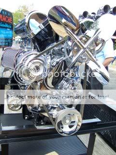

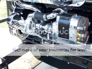

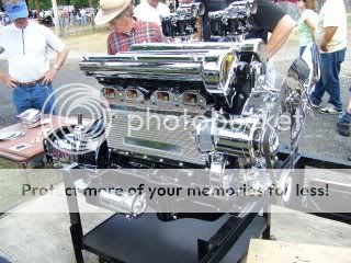

  6. Is that a Riley with dual/double Winfields???

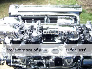

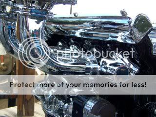

  7. All I get is super shiney boxes lol. Dang Bill thats some serious loot on your trailer. I bet they got more in the chrome bill then I got in my whole build.... well almost. Awesome is all I can say.-Weeks

    over head cams

    That engine is a Hal with dual overhead cams, the head and all the parts will make the banger run like an Offee. I have one in a box that i have never ***embled mine will take a lot of $$ to get running. The head is a work of art but you really need to do a lot of work to an A or B to make them live with this set up.--TV
