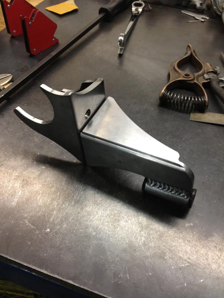

    So after mocking up the rear end with the leaf hangers Gary provided me with, i realized Im far from the height i was thinking of.. I was stuck for a couple of days wondering how to get the rear at the height i was picturing..
    So i took Gary's hangers, and modified them a tad... Made the leaf hangers adjustable.. This should work out well being able to adjust right height and spring rate at the same time..
    Spent some time on the lathe after work, and came up with some mounting studs to use Cory Taulberts early bung ends..
    After mocking up the frame to the desired wheel base, I bored out enough material to slip the sleeves for the perches through.. the bones are off a '46 lincoln.. Heavy duty!

    I was able to get full weight on the front and clamp the spring into position.. This clocked the perches correctly so they dont bind, and i was able to set the caster and mark the mounting location of the wishbones through the frame..
