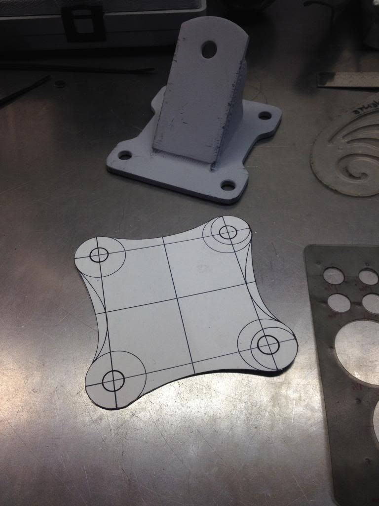

    I purchased some biscuit style mounts from ch***is engineering, and while poking around on their site, saw they make pre fabbed motor mounts for nailheads. for $40 i said what the hey and bought a set. The biscuit mounts are damn nice, but i wasnt really happy with the block mounts. Also, all the guys gave me grief at the shop for buying premade mounts.. So i said **** it and started a template for the base plate.. Im digging the asymmetry of the sides, but not happy with the arches on the top and bottom, so i took some of the arch out before i cut them out.. Was running out of the shop after i cut them out so wasnt able to grab a photo of the base plates.

  21. Build looks awesome, keep the updates coming.
