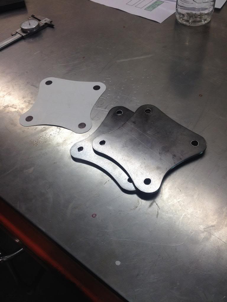

    Was able to clean up the base plates today at lunch.. Just paaaaaatiently waiting for the adapter to show so i can get the motor in..

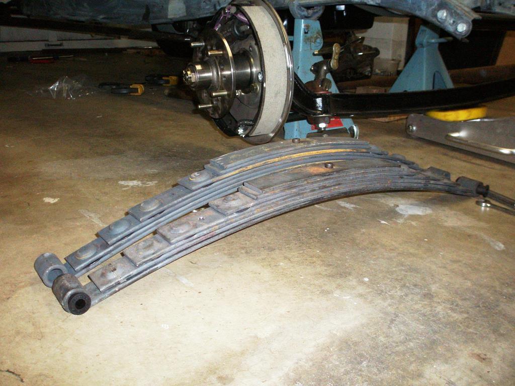

    ok, so now that i have most of the weight on the front, this is where my front shackles land (angle wise).
    Opinions on shackle angle? Panhard or not? Doesnt seem to be any lateral movement, and i think i set it up the best i could during mock-up to have 45 degrees on the shackles with full weight on the suspension. ideas??

    I'm doing a '32 ch***is with '32 heavy axle right now and had a similar issue with the shackle angle. I started with the 31" Posie with the "L" suffix (lower profile spring). My shackles looked similar to yours and the more component weight the more they flattened out. Probably would have given a harsher ride. So I got the 31" spring without the "L" suffix and it came out much better. The higher arch of the spring means it's slightly longer and brought the shackle angle more in line with the 45 degree desire.
    Here's what the two springs side by side look like to show the difference....

    I wouldn't panic yet. The front still isn't fully weight loaded and springs do settle a little once you hit the road, so it may lengthen some and bring the angle closer to 45*. Re***ess after it's all done and you've been driving a few months. As it sits now it's really pretty good.

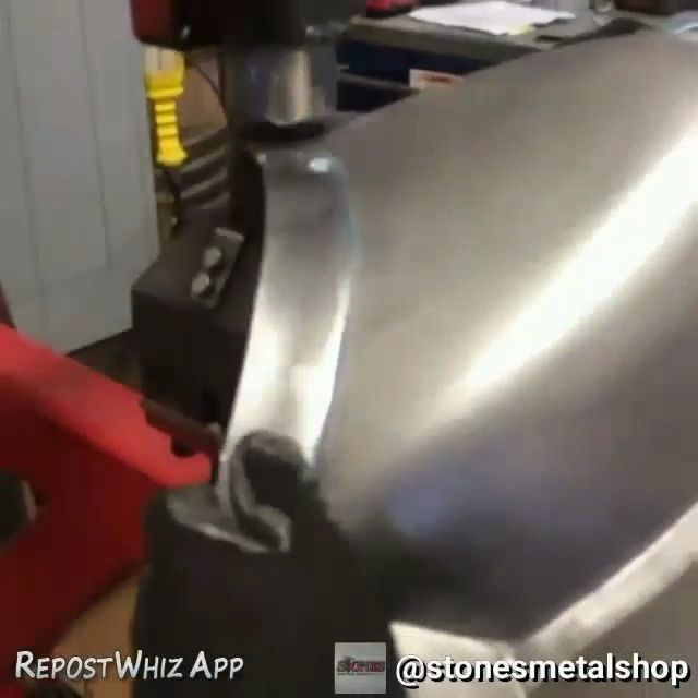

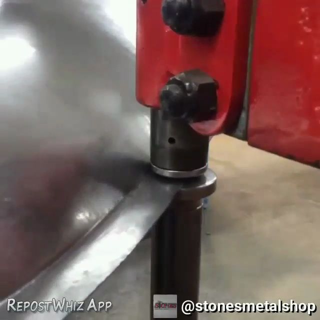

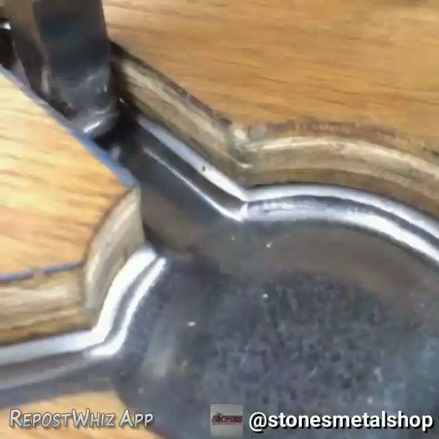

    Being a car guy, I've been incredibly fortunate to run into many people who share the same p***ion.. One guy I can't be more proud of to know is Brian Stone from Stone's Metal Shop. Brian and his crew, hands down, are some of the most talented folks in the industry. Somehow, i ****ered Brian into helping me out on fabricating the floors for the roadster.. Guys, please follow the metal magician Brian Stone from Stone's Metal Shop..
  22. Red Wakefield
    Joined: Nov 30, 2008
    Posts: 103
    Red Wakefield
    from Pasadena
    Brian knocking out the floor and ****** tunnel on the Wakefield Roadster!
