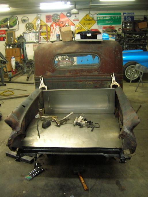

    Well, I took a little break after the pileup working on the Sea Hag because I got busy at work.
    It has been rainy and shitty here lately so there has been nothing to do but work on my pile out in the garage.

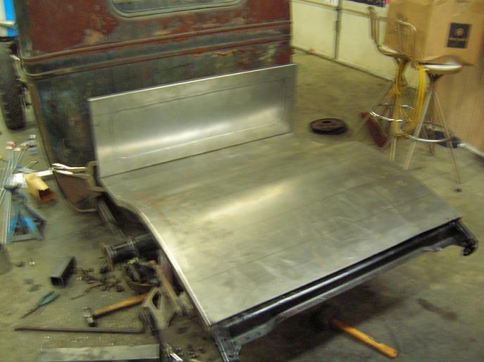

    I got a sheetmetal brake for Christmas last year but never made a stand for it so job number 1 was to do that so I could bend a 4 foot wide piece of 18 guage steel.
    I wanted the bed floor to be one piece so I used the brake to bend 1 inch flanges on the edges, and I used my shrinker and stretcher to make the sheet follow the contour of the frame.
    I have the lines marked out where I am going to roll beads in the floor if I could ever get anyone to come over and help me hold the sheet and do it.

    I carefully measured, and then guessed how high I wanted my bed front to be and cut out a piece of steel for it. I rolled a nifty recessed panel in it with my handy new bead roller. I then bent the 1 inch flanges on all 4 corners. It is going to get supported by some 1 inch 16 guage square tubing.

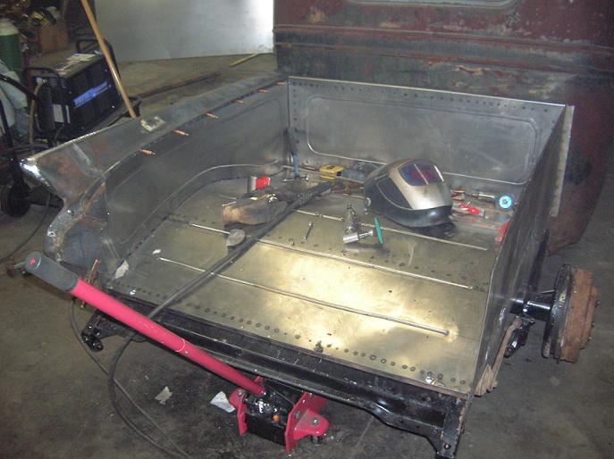

    I got my help over Friday night and it cost me about a case of beer, but we got the beads rolled in the floor. I also cut out a few support bars that go under the floor out of 1x1 16 guage square tubing and welded them to the bottom of the bed floor. I bolted the floor back down tight and cut a side piece for mock up purposes. Those little cleco's really help for this sort of thing. Sometimes it is the tools that make the job possible.

    With both sides cut and clecoes together, I marked on the panels where all the edges were so I could take the panels off and roll a nifty design in them with my handy dandy bead roller.

    I rolled my bed side design in the panels, which again cost me some beer for my helper Russ and his boy Jeremy, Jeremy did all the helping while Russ stood and watched and drank the beer. Ha Ha Ha
    I drilled a shitload of holes in the side of the panel and then I spot welded it to the bed floor. I wanted to give it a "factory" type look.

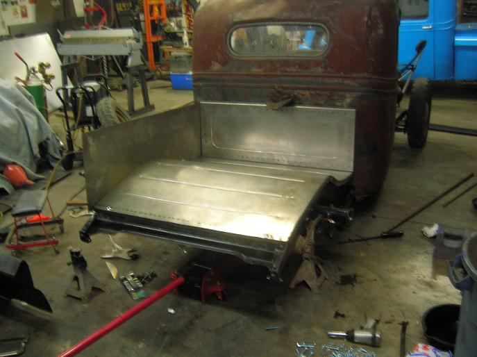

    I dollied out the edge of the Lincoln quarter to match the top of the bed side.
    I clecoed it back on and welded it in place filling all of the spot weld holes that were in it from when I removed the trunk lid lip.
    Now the thing looks almost "factory". Ha Ha Ha
