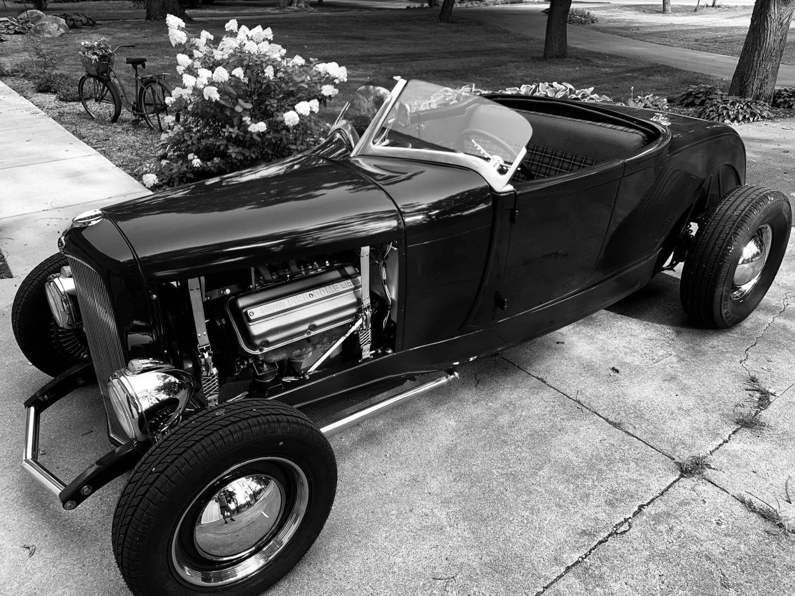

    I gave up trying to keep hubcaps on the Wheel Vintiqes steelies on the front of the roadster and put Spiders on it. The little nubs on the center evidently aren't quite pronounced enough to hold the dog dish style caps I have. The original Ford wheels on the rear have much more defined hold down lugs. It's not from cornering, because they'd fly off going absolutely straight down the road. F80BD854-1A8D-4318-AC04-6F03BC8D9FE2.jpeg
    LCGarage likes this.

    That's interesting. I had my caps on my GMC modified by wheelsmith to have the correct ring on them. My wheels are wheel vintiques and have big bumps on them and the caps are extremely secure. My wheels were built in 2012.
    I wonder if the bump size was changed over time or it was something else?
