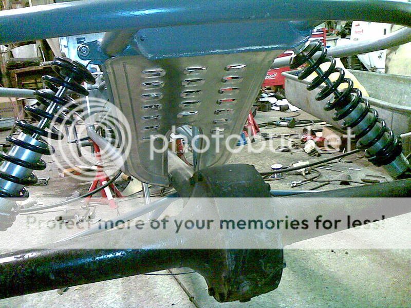

  7. I got the frame back from blasting and start to ***ebly , first i painted the frame with 2-component epoxy , and used brush , because this aint gonna be a trailer queen , and i´m going to race it in the ice-track and some field races at summer... So no fancy pancy here!
    Engine is now dressed up , and allmost ready to fire it up first time in 50 years , it has been long time this puppy had been hybernate , so it´s time to wake it up.
    Rear has coilovers from strange , with 2 way adjust for different kind of tracks :)
    I put in some louvered aluminium plates to clan up the frame:
