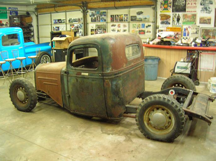

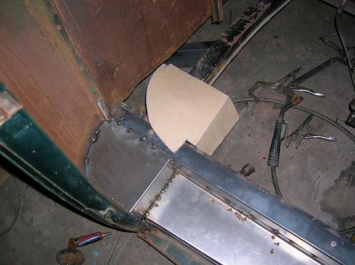

    Well, since the lander found itself a new awesome home, I was able to move some stuff around in the garage to make it look like I was actually doing something.
    The Rocket Queen was progressing nicely, then I got to thinking, Guns and Roses was such a glam band in the beginning. They were all about drinking, coke, hookers, and that goofy drummer even gave himself a stroke with some heroin. They ended up being gritty but a little too polished. Now scarry larry can probably understand why I am changing the name of this truck to the "sea hag". The sea hags were true rockstars, they didn't give themselves strokes, the went all the way and a couple of them even died true rockstar deaths, alone in the gutter on the big horse, even though they never toured in a bus, they lived the life out of the back of a shitty van. I think Sea Hag is a more fitting name since this thing is going to remain unfinished and rusty. Again the whole purpose is just to drive it to Bonneville next year.

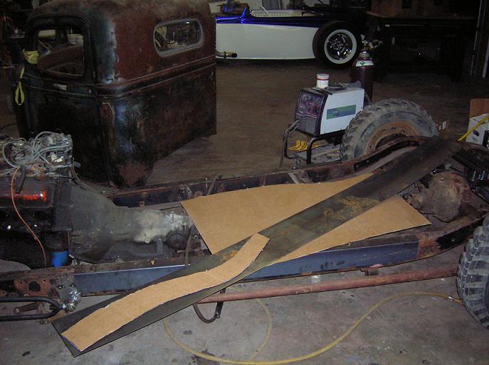

    I started throwing the floor in it by attaching sheet metal to some channelling plates made out of 16 guage steel with a 2 inch lip on the top and a 4 inch drop down the sides.

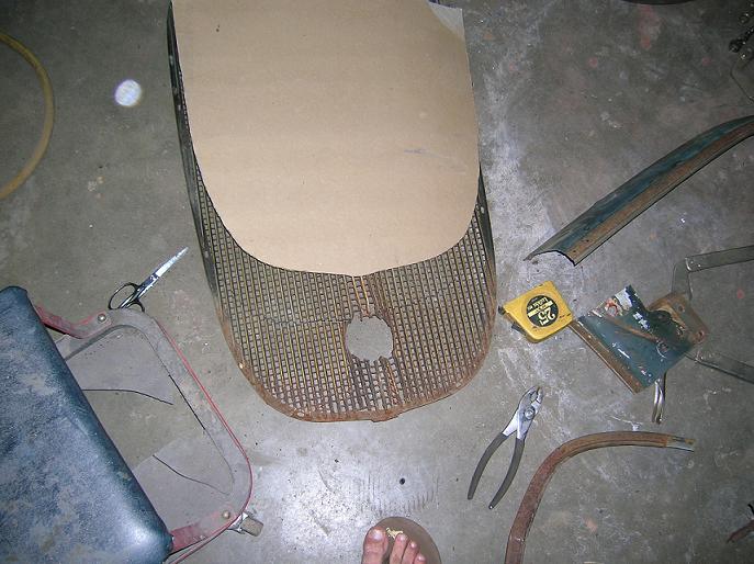

    I shortened the grille 6.25 inches so it didn't drag the ground. Those chevy grilles are long!

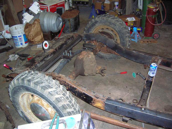

    I boxed the rear of the frame and hung the Ford 8 inch rear from a model A front spring on some speedway brackets. It is held in place by some 36 Ford wishbones. I am waiting on my new plasma cutter before I finish the frame so I can notch it in the front for axle clearance. I am getting a new bead roller so the floor is going to wait on that so I can make it look a little nicer with some beads in it. I am moving up in the world! ha ha ha

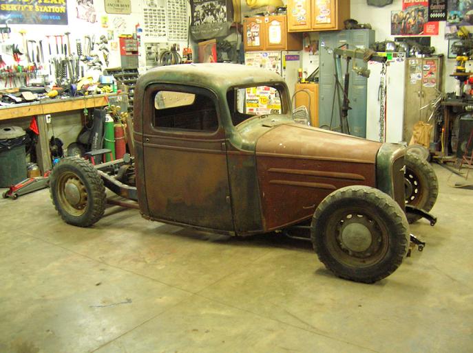

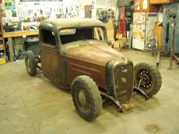

    Thanks guys, but so far this has been the easiest thing I have ever attempted. Ha Ha Ha
    Here is a shot from the front.

    How are you planning to match up the hood corners with the grille?
    B:confused:B
    I'm a liking it a lot.
  13. Plowboy
    Joined: Nov 8, 2002
    Posts: 4,281
    Plowboy
    The hood is a little flattened out from laying around. I don't have the radiator in the grille and the grille bolted down yet. Once I do that I will make it all line up.
