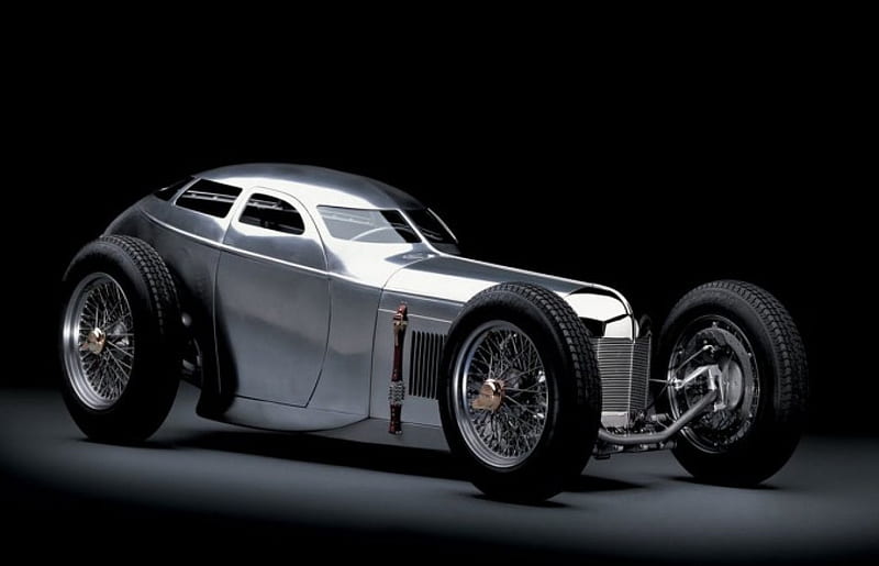

    About the first week I was in the violin shop a Strad came in with the top loose, that happens every hundred years or so because we use half-strength glue on the top. They taught me how to make a pattern off the instrument (the Dushkin Strad), I did so and copied it to the millimeter to the best of my ability. It turns out that my first violin is an aberration..the masters said it was THE best sounding violin they've ever heard, and a member of the Indianapolis Symphony begged me to sell it to her..I let her play it for six years, then started lessons m'self. Now I have just been promoted to Second Chair in the Hanover College Symphony Orchestra with the same violin. Every pro who has played it says it is THE best sounding violin they've ever heard..I can't take much credit as I just copied the measurements, thicknesses on the Strad that came in the shop, and I got lucky on the wood, it was real, real old and had SO much flame, grain the master said, "It can't be bent," (for the ribs). He broke two I had carved, but my metal working experience, and loads of patience got the job done..I just had more patience with the bending iron, sort of like bending tubing with a torch. But it was just real scary carving the scroll (and the rest of the instrument) as it is all...subtraction. At least on my clay sculptures (cast in bronze later) I could add if I had to. Here's one of them, it's quarter scale, took 2,000 hours.
  19. I’ve seen that ride in person and had the chance to talk to Mr Naff for quite a while about that car and his daughters 32.
    Pics can hardly do it justice.
    As far as tools, a pullmax would create the belt line. However. You can also create body lines with hammers only.
    A pullmax P6 here locally was just sold with tooling for $3500.
    Deals for equipment are out there. Ya just have to be lucky and ready when they pop up.
