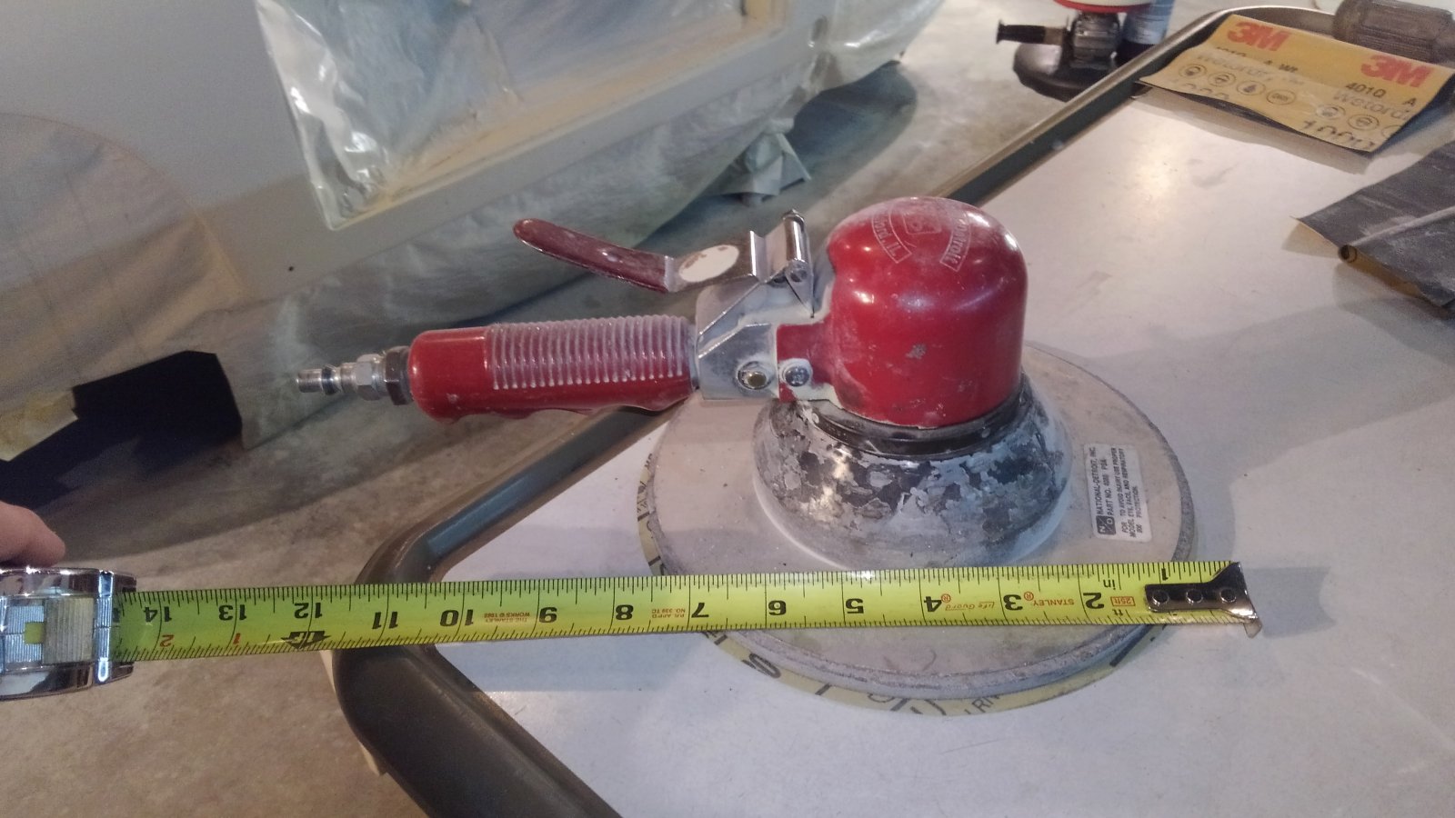

    Call me ol'School... But an 8" with a box of 40 / 80 grit depending how crappy the finish is...
    Plus if you've never used one to make shit flat... You will be amazed!! Haven't used my airboard in decades... Except onc KIMG9338.JPG e in awhile in a tight spot...
    milwscruffy, ekimneirbo and texasred like this.

    lostone
    from kansas
    My step dad was a body man for 50 yrs and swore by 1 of these. He used a board file too but 85% of his work was done with a 8" sander.
    Said the same thing too, you could make anything flat with it.... And he did too. Always impressed me with how he could manipulate it.
    Did some amazing body work with just that and fast too, sadly I never picked that skill up.
