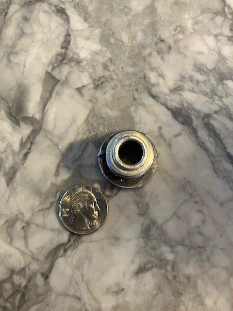

    This is the threaded part of my speedometer on the back of the transmission...I am going to go with a GPS Speedo so I want to cap this off. It LOOKS like it's 18 threads per inch (if my math is correct) and I measured 0.823" in diameter in between the threads...
    I have no idea where to find a cap for this.... Is this a pipe thread? What am I looking for?

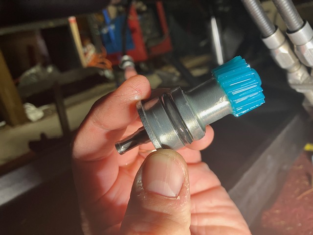

    Thanks for the tips. My "crutch caps" will be here tomorrow and I plan to use those...but now that I have it back together and bolted up there isn't much room at all from where the ladder bars attach. I could weld it closed, I suppose.
    Should I remove the plastic speedo gear from inside? What about snipping this cable off completely?
