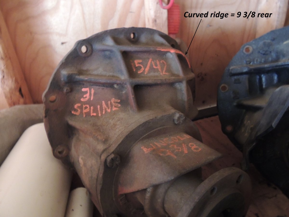

    Before you buy those gears I would ask where they came from and if the top rib on the pumkin may have a curve on it. Good chance they came from a 9 3/8 and the guy thinks its a 9". Could you just get larger rear tires ?
    Was pokin around on Facebook Marketplace and came across this. Probably not what you need, but maybe he has something else layin around.
