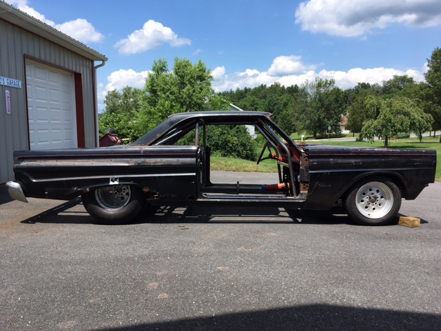

    My prostreet 64 falcon was moved back about that much. They cut the firewall right where the section behind the hood starts to go down under the hood and made a flat sheet metal firewall. Keep in mind it will all but eliminate the cowl channel for the fresh air to enter the heater, wipers don't really have much room and shortening the pedal hanger is going to be needed. May not be a concern of yours but just giving you the heads up. Mine is set up for a motor plated 460 and c4. Also, it really screwed up the hood hinge area the way they did it. Not a big deal if you are going to run a "pin on" hood. BART.

    Very cool, thank you. I'm thinking of cutting under the cowl and move it back, not affecting the wipers, heater, etc... I'm thinking a flat panel or recessed like a box. Just getting ideas. Any closer pics of your front end minus fender aprons? I have a MII steering.[​IMG]

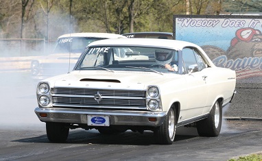

    Mine was done by a ch***is shop outside Maple Grove years ago. The previous owner was in over his head after getting the bill for the frame, cage, stretching wheel openings, strange 9 inch with ladder bars and coils and the front rack and pinion steering that is based off the mustang II. The car is getting a 393 Windsor, G-Force 5 speed and a Detroit Locker with 5.25 gears for the street. It has 29.5X19X15(If I remember correctly) tires on the back. I see you're not too far from Hershey. Isn't Denver by Cocalico/Anville area? I also have a 66 fairlane GT that my parents bought in 1967. Needs a complete makeover though.

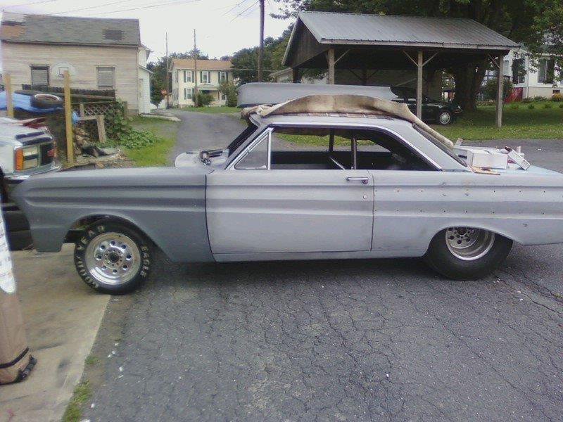

    One of the first comet setbacks
