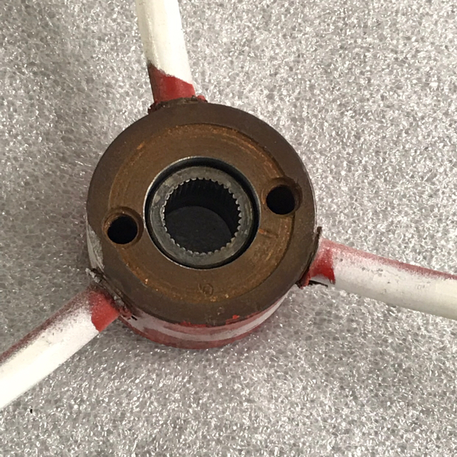

    Anyway, back to the subject at hand, it is indeed off of a Buick, I plucked it from the car myself. The diameter on the spline was about 3/4"...it was a 1" jam nut holding it on.
    I wish there were, but the center hub covers about half of the holes on the plate :/ I have already designed an adapter in CAD that would work just fine and built like a brick sh*thouse, but it would cost about $450 to CNC mill. It would be made of the same hardened aluminum as the Grant spline hub adapter. I design stuff all day long, this is no stretch for me....just dropping the duckets to do it :p

    could you smooth the spline and the hole in the whel and machine them so you could use a square key,kind of like a cam gear?

    I like what Delaware is saying here. Can you weld a plate or something to the back of the wheel? If not, maybe the idea of a keyway might do it? I am trying to put this same wheel on a late model column(1989 tilt) and it won't work for me either.

    This thread popped up in a search and I wanted to do the same thing. A 55 Buick wheel on my 51 Chevy. The splines are different. 11/16-36 and 3/4-36. I cut the hub out of the Chevy wheel, turned it down, milled out the Buick hub with a .001 press fit and Dutchman pinned it. 3 months of planning and it’s on the car. It should be noted that the horn set ups are totally different and to the best I can figure not compatible. I’ll have to use a dash ****on. [​IMG][​IMG][​IMG]
