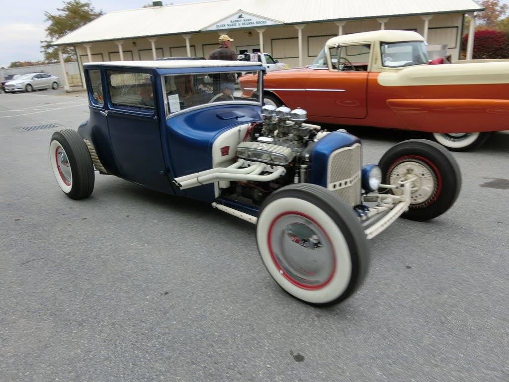

    Yeah the suicide front suspension hanging way out front in the breeze belongs on a 70s style T bucket.
    I like the stubby look lol
    loudbang and 31chevymike like this.

    I think you have your dates off a little bit. Suicide suspension is traditional and has been around for a very long time. One of the first so called T-Buckets was Norm Grabowski's and it was built in the early 50's. I believe the first magazine it was in was in 1955, and it did have a suicide front suspension. norm didn't come up with this on his own and copied an earlier design or at least that is what he always said. Like suicide suspensions or don't that is completely up to you, but they are a big part of Hot Rodding and have been so for a very long time.
    Jet96, Stogy, Ron Funkhouser and 2 others like this.
  19. loudbang likes this.
  20. Another reason for the suicide suspensions, especially the T-buckets were to correct the clearance problems with headers being too close to the tires. If the axle was underneath the grille shell where it normally would be, the steering would be greatly affected. These front ends were cool, as long as the rod appears in proportion.

    When most people think suicide front ends they picture the real long stretched out T's of the late 60's onwards. Those cars had longer wheel bases as was the style. The key is to keep everything nice and tight like the Grabowski car pictured above.

    Oh I know suicide front ends have been around since the 20s mostly on race cars. The ones like on the kookie car are fine, they're tucked in at the front. It's the ones where it's stuck so far out front that you could put another engine between the axle and grill.
