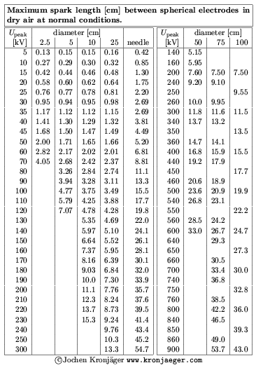

    I disagree, the amount of voltage it takes to fire a plug is dependent on gap size, cylinder pressure ect. If anything a bigger electrode would be a better conductor as in less resistance. The reason it takes more to fire an old plug is the wear on electrodes increases the gap. Multiple ground electrode plugs still only spark to one electrode at a time. As gimpy said just increased life.

    There's a very nice chapter about ignition systems in the book "Four stroke performance tuning" by A. graham Bell. It's been years since I read it, but you may find a more elaborate explaination in there. English isn't my first language, so I can't quite explain it all as well as I'd like to.
    I do agree spark gap, cylinder pressure etc. has a bigger impact on voltage requirement, but electrode shape etc. is also important.
