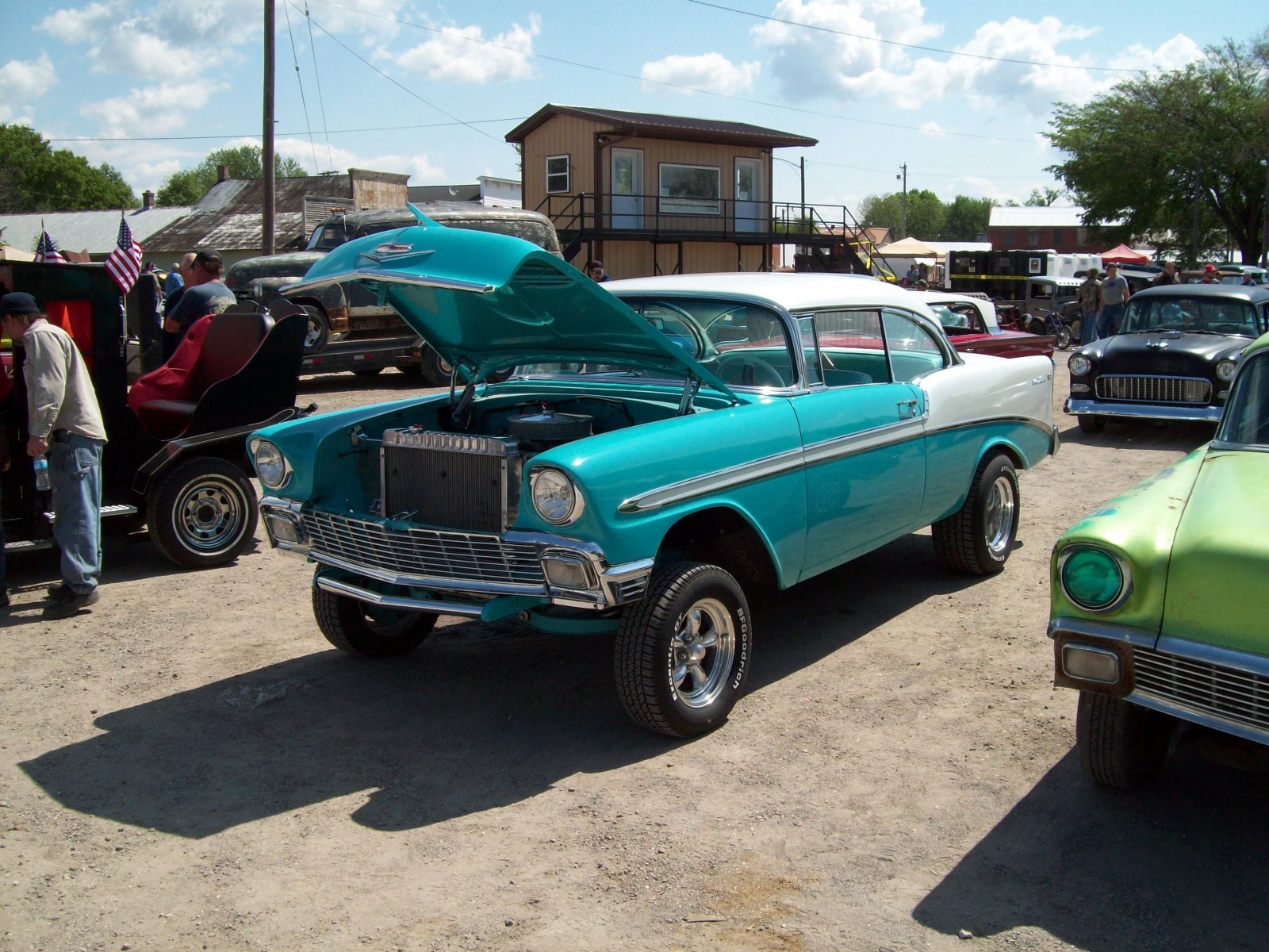

    I saw this one at the Rust Revival a few years ago.
    Gary
