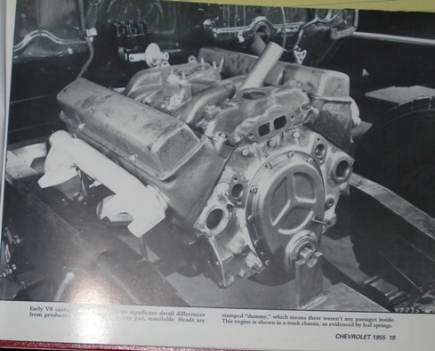

    This is a photo from a collection by a long time GM regional parts manager.Shows a very early small block in a 53 Chevy truck done being done up by GM engineering.Notice the differences in the block and the later production 265's.

    ^^^^^Could you post/type the words that are writen below? Do you have any photo's of the 55 test car vehicle that was fitted with 54 sheet metal so spy camera's would not get a glimps of what was coming.

    The caption below the photo says it's a pre production 265 engine,the heads are stamped "dummy" meaning they have no internal passages,the leaf springs means it's a truck.
    This is most likely something mocked up by Chevy engineers in a "skunk works" lab for a "study". It appears there is no X stiffening stamping on that truck firewall,is so it would be a 1948 AD truck cab.So the truck was a few years old at that time ???
    The introduction of the V-8 was a big deal. Chevy was always a very conservative car with no performance image and now it was going to compete head to head with Ford in the entry level V-8 class.
