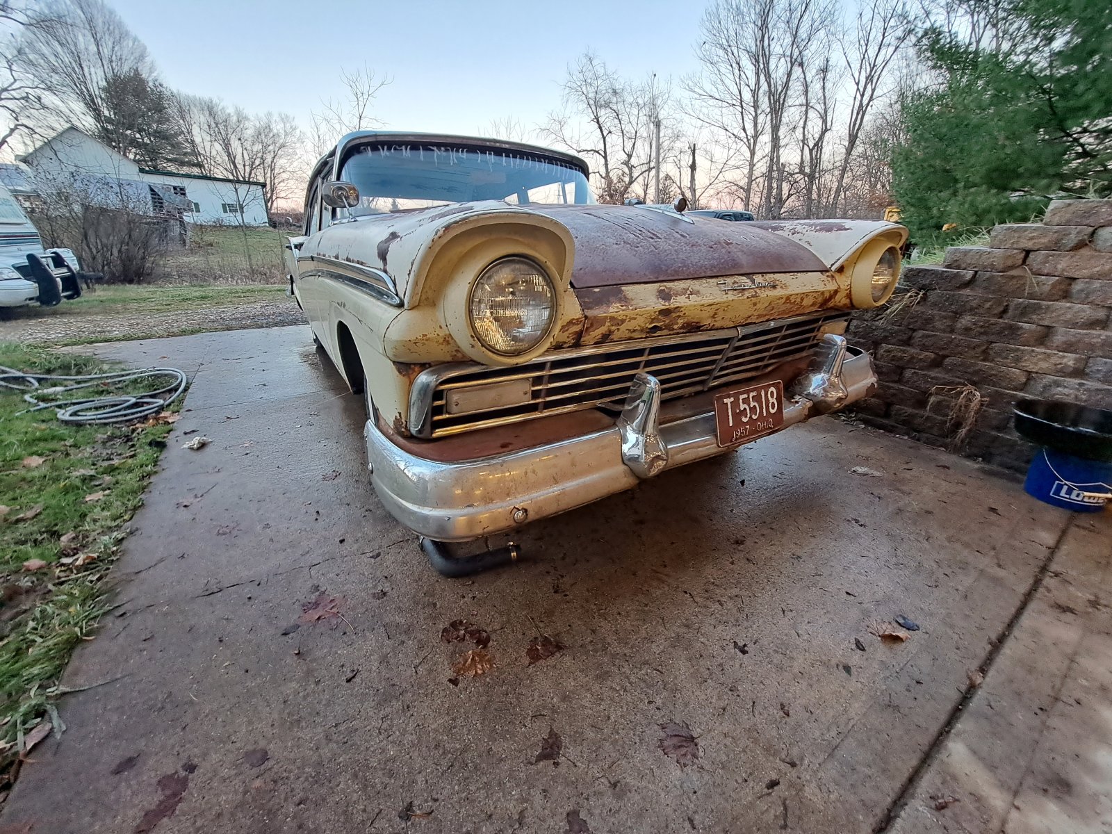

  15. it WAS coolant, after i drove it some the just water became coolant, the core is fine, the gasket where the heater valve installs wasnt sealing properly, a little more rubber cement and making sure to seal the outside aswell, no more leak!
    it drives really great, backroads are amazing in this thing, forgot about a part of the road you need to slow down on, bumped my head on the headliner! ooops! did some CLR treatment to it while the "coolant" drained, i need to flush it with more flush, and for a lot longer... 20231119_170611.jpg 20231119_170322.jpg 20231119_124157.jpg 20231119_132625.jpg
