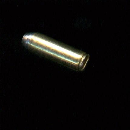

    A look at the bullet, minus the base washer.

    Try a color pic for clarity...

    Maybe anudder one...
