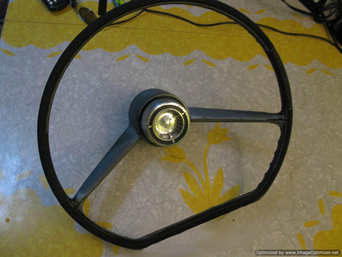

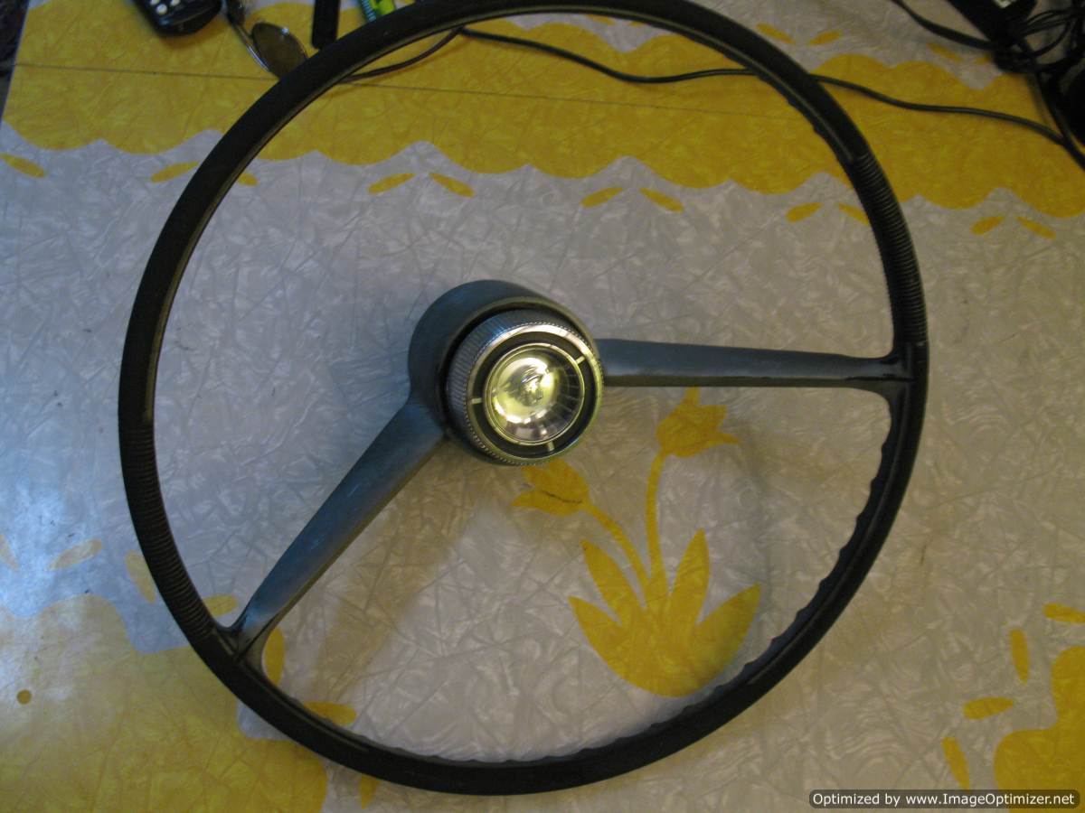

    Using my non-existent photo chop skills, I'm pondering what to do with this wheel. It's a 60-62 or 3 Pontiac standard wheel which is that same ones that would have been used in the SD cars. I've adapted a '63 Mercury deluxe horn ****on to it. Here are a couple examples of what I'm thinking for the bottom. What do you guys think, flat or curved?
    I was thinking of just chopping the bottom and leaving the top normal and painting the wheel white with the "GRIP" sections on either side black two tone.
  2. Dog Dish Deluxe
    Joined: Dec 23, 2011
    Posts: 777
    Dog Dish Deluxe
    from MO.
    no opinions on this subject? The wife didn't hesitate at all and said the first one. She didn't like the flat section. Guess that means chicks dig the inversion thing.

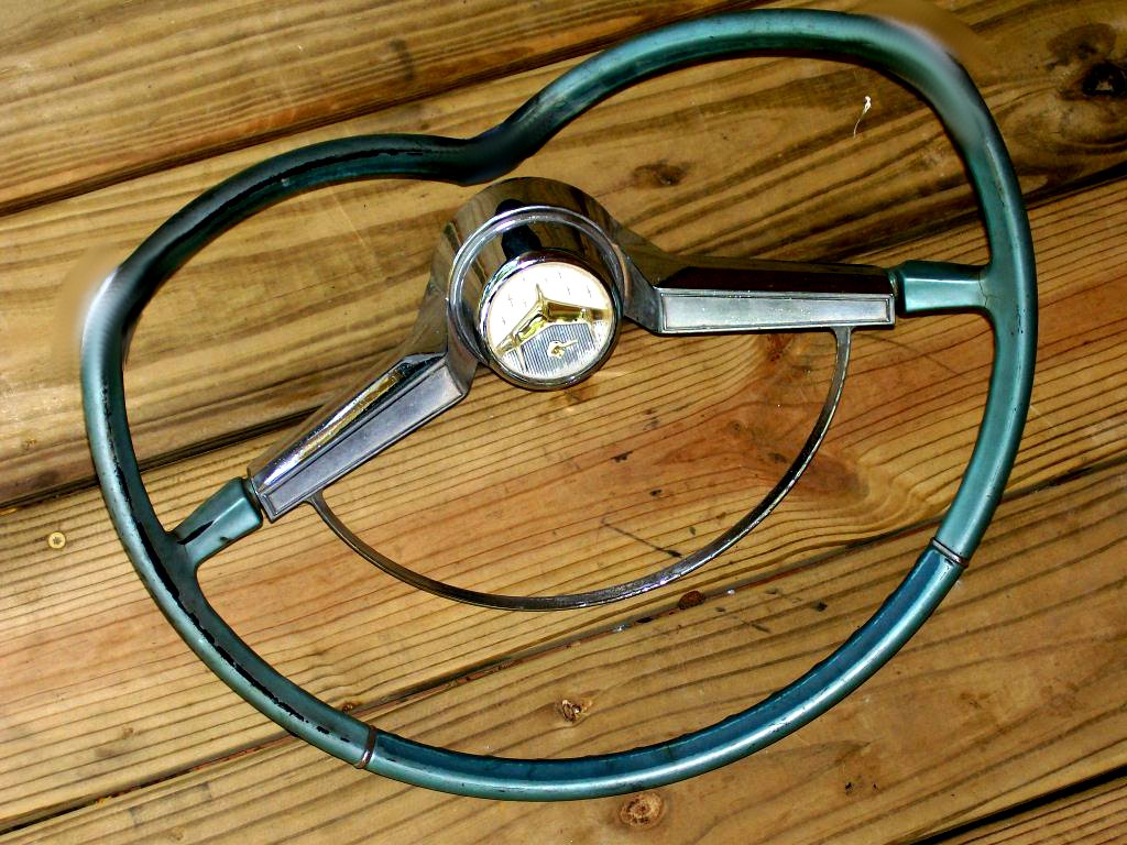

    Thats awesome slime, you're doing a great job. A lot of guys don't mind the little stress cracks but some do. It takes sooooo loooong to fix all those, it's one helluva process for sure. Heres a couple "mild kustom" wheels that I'm working on. The black and white one is a '58-59 Poncho standard wheel with a '64 Lemans/GTO horn ring. It was a total pita to make that horn ring funtional on that wheel (used parts from 5 or 6 different steering wheels) but I think it was worth it. (it's sold already) The other one is just one that I've started messing with, all I've done is the horn ****on so far but is should be pretty neato when it's done.

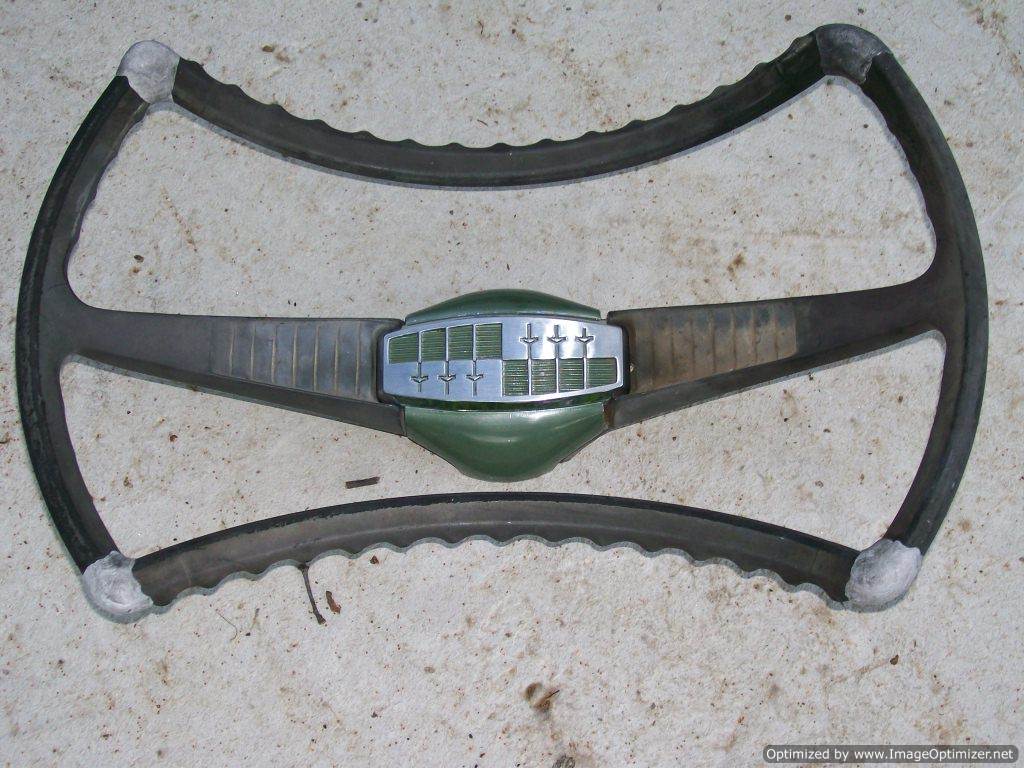

    Finally getting around to working to some chopping and welding action. Heres the latest:

  11. Dog Dish Deluxe
    Posts: 777
    Dog Dish Deluxe
    from MO.
    I tried to photochop the corners to give the overall effect but the pic ****s. I got the corners filled in last night so I'll work on sanding them later. This is my favorite one so far, look cool as hell in person.
  12. Dog Dish Deluxe
    Posts: 777
    Dog Dish Deluxe
    from MO.
    Here's a little better pic of the "Lunar Moth". Made up another of this style also. I inverted the sections at a little more of a radical angle on this one. Debating on whether to get rid of the finger grips or not.
