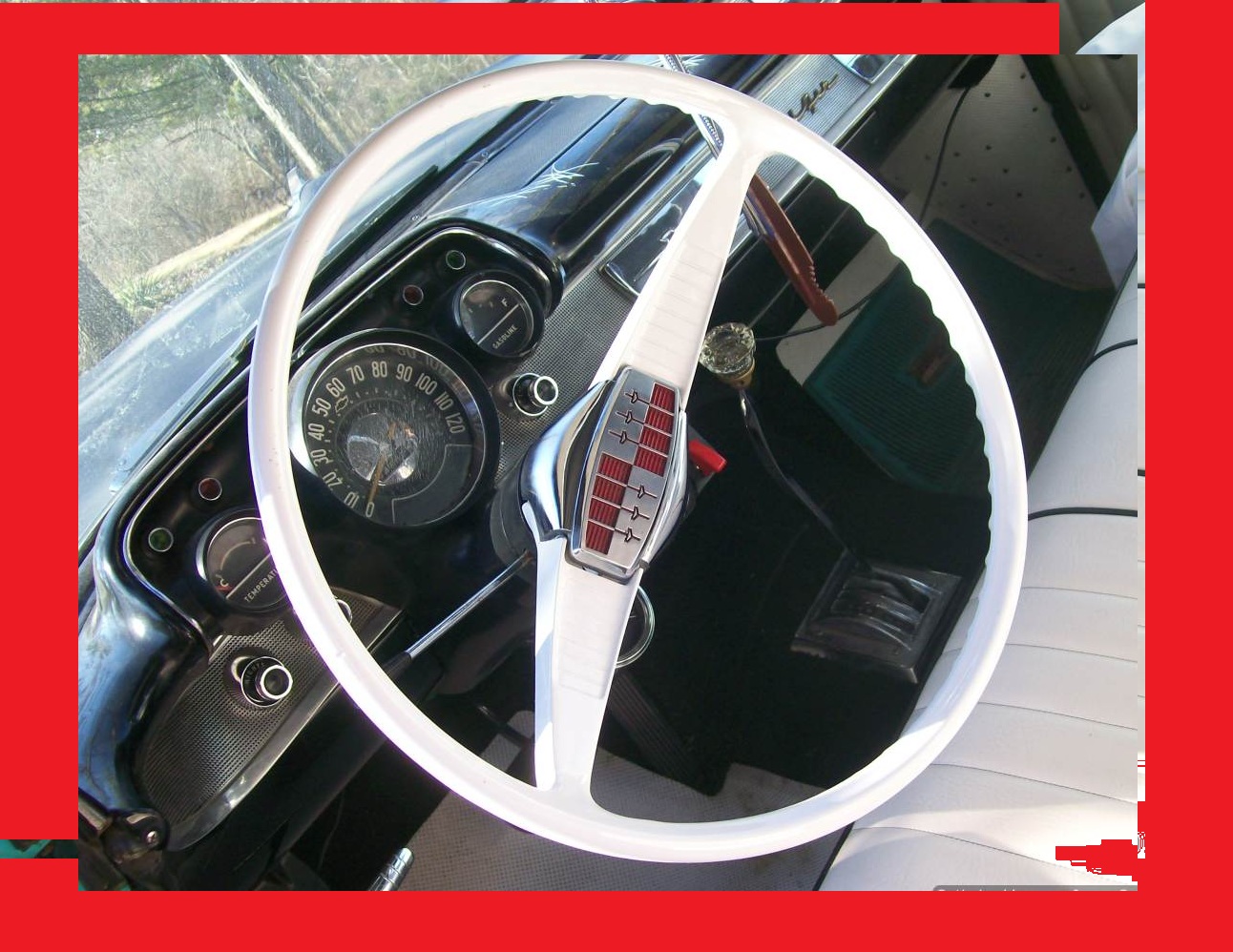

    Kustom. :cool: On a different note, I thought the design of this white wheel was really awesome and that people would dig it. Now that I'm building a couple more and decided to sell this one, it seems like nobody likes it. Oh well, if not than I'm gonna just keep using it because I think it's awesome.
  7. Slimegreeeeeen
    Joined: Jul 1, 2006
    Posts: 1,241
    Slimegreeeeeen
    I seriously doubt that nobody wants it. I must confess, though I think the one in your avatar is killer with that square horn section. You're putting up some serious eye candy.
  8. Dog Dish Deluxe
    Joined: Dec 23, 2011
    Posts: 777
    Dog Dish Deluxe
    from MO.
    Actually sold the white one last night. I couldn't agree more with you about the wheel in my avatar pic. The '58-60 horn ****ons on those wheels are killer looking but super hard to find in good condition. I have a few and I'm in the process of making another wheel like the one in my avatar right now that will be for sale. I even dig 'em when they're still round.

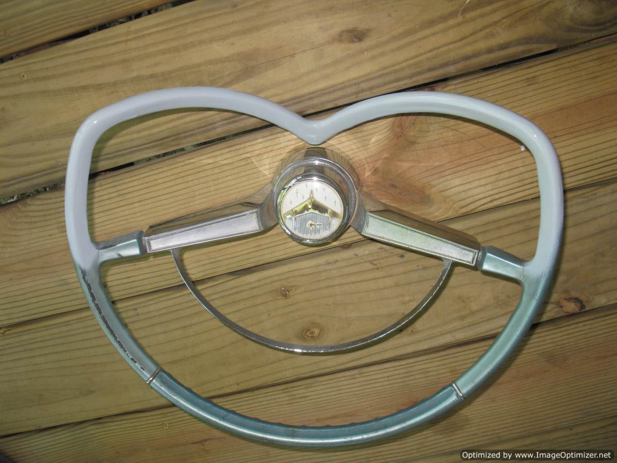

    Heres some progress on the "Moth" got the top section sanded out and in primer. The 'point' in the middle was a pain in the *** but I think it should be pretty cool when done.

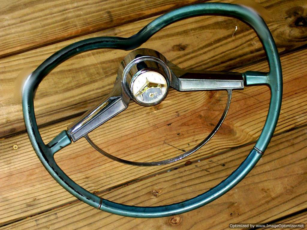

    Still not sure what direction to go with this wheel, it's one of those things that has me kinda stumped as to what would be kool. I sold the "Lunar Moth" wheel yesterday, but was thinking of doing the "vee" shape on the top of this one. Wutchall think? Might make it look like a pretzel.
  18. Slimegreeeeeen
    Joined: Jul 1, 2006
    Posts: 1,241
    Slimegreeeeeen
    If you don't do it, who will?
  19. Dog Dish Deluxe
    Posts: 777
    Dog Dish Deluxe
    from MO.
    Guess I'm the only one crazy enough to do it. Better get back on it! :D
