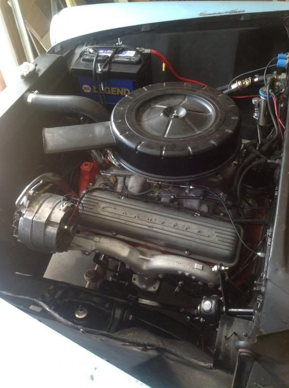

    Here are some pictures of some of what I've been up to. First a couple of the engine; hopefully, I've got everything worked out and she'll start tomorrow. The silver circle you see on the firewall is the insulation inside: I put an A/C bulkhead in the factory heater delete plate and the paint was drying when I took the pictures:

    Well, I got it running and driving. I drove the wagon around the block today. I still have a soft pedal to work out and several small things before I can drive it everyday, but at least it moves. I've been working by myself, so when I run into a problem, I have to work through it. I'm supposed to drive it halfway across the state in three weeks; we'll see if I make it!

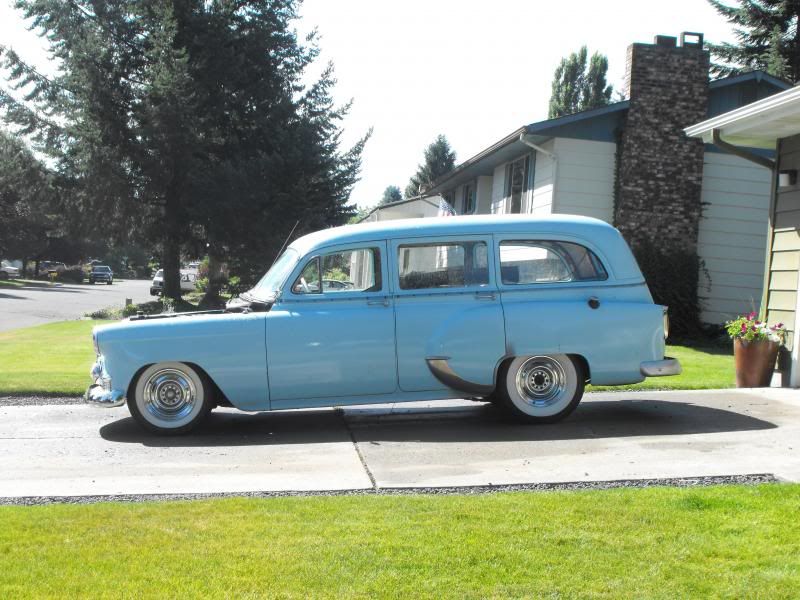

    An update; I started driving it a little this spring and it ran like ****. Turns out the cam in the 307 went flat. I bought a rebuilt 350 with 305 heads and an RV cam and swapped in a fee weeks ago. I got it running pretty well this week, then had to chase down some ****** fluid leaks. Today, I got all of that worked out and bolted on my hitch. Thursday morning, my daughter and I are headed out camping pulling our tent trailer behind the wagon. This afternoon:

    Hooked up my tent trailer and took the wagon camping this weekend; she didn't skip a beat!

    It has a hood, all new rubber, and door panels now. I have the back torn apart to carpet the cargo area. The only thing left inside is the headliner and windlace, which I have. We’ve driven it a lot around the Eastern side of the state.
