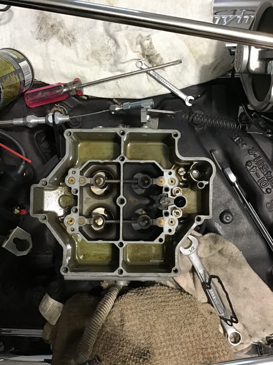

    457AF329-6E6B-4B06-A72B-B95BBABB9EF9.jpeg heres the carb, you can see how black the primary’s are from fuel

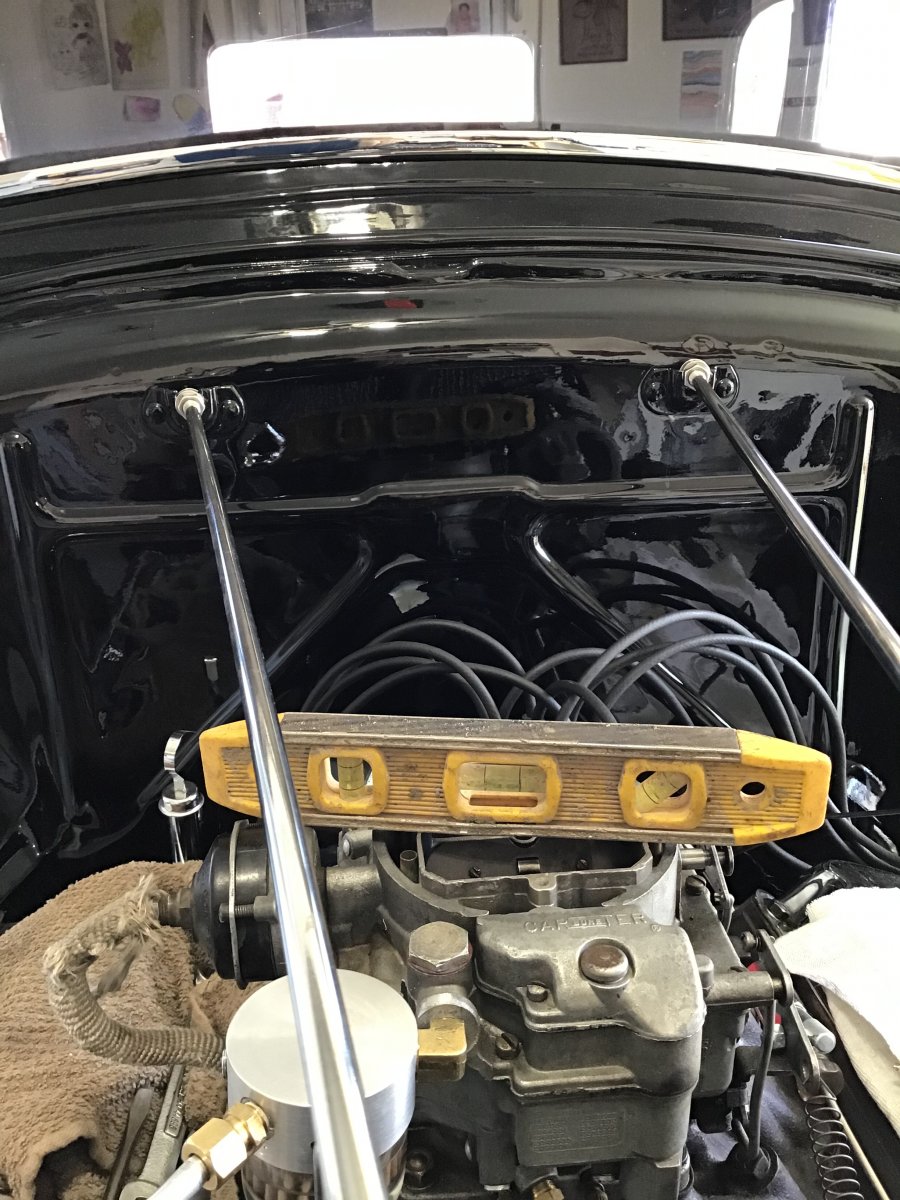

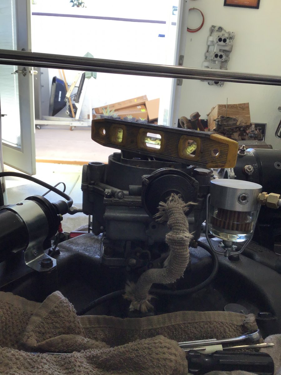

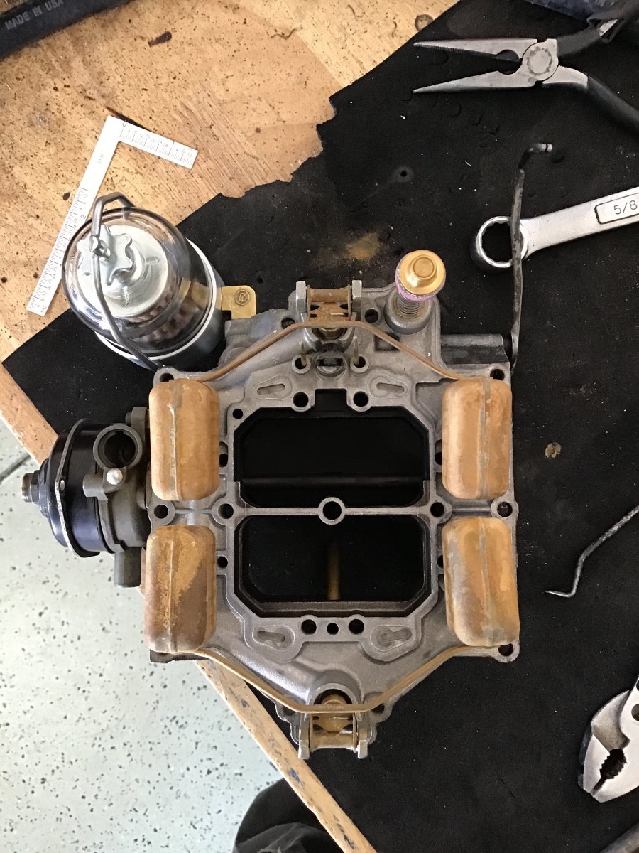

    Just a suggestion, put a straight edge on the air horn, top casting to see if it is warped

    2FC338D2-8068-4D00-8604-948D1CD86EE5.jpeg 3E0012ED-9355-4694-8785-38C86E0F93AC.jpeg EF210361-1860-4EC5-8F46-B7E389D8A40C.jpeg 148C48DD-B6F4-4FC2-8A6E-AC2DF562DC2A.jpeg
    I reinstalled everything , check air horn, it leans more to the rear but I think that’s engine placement?

    I think Bert was suggesting that you check the flatness of the bottom of the carb lid, where it seals to the carb body.
    As mentioned above, I'd check the needles and seats, but in your picture above, the primary floats look way high; the secondary floats look about right. I'm not sure, however, what the factory setting is. You may want to pay extra attention to how clean your primary idle air bleeds and p***ages are. If they're at all clogged or scaled up, weird things like nozzle drip can happen.

    I've worked with these carbs over the years a lot. I agree that the front floats are too high. I have always
    had them level with the top horn. It was always more important to have float drop set low enough to
    fill the bowl, rather than how high the float sat. Bob

    Floats are way wrong, make them level to the top when upside down. the secondaries are kinda ok but the primaries are way too high.

    Ok so here my floats, with gasket off. Primary are to be set at 1/8 and secondary at 1/4. Should I level em off, just to try something different, cuz like this, my venturis are taking a leak in my carb! C9B97A13-6447-4381-BE22-029046159D17.jpeg EB81DDC3-3705-40C9-8637-0CB92CEB3570.jpeg 763B064E-CA35-4B5E-A470-99A823C869A6.jpeg
