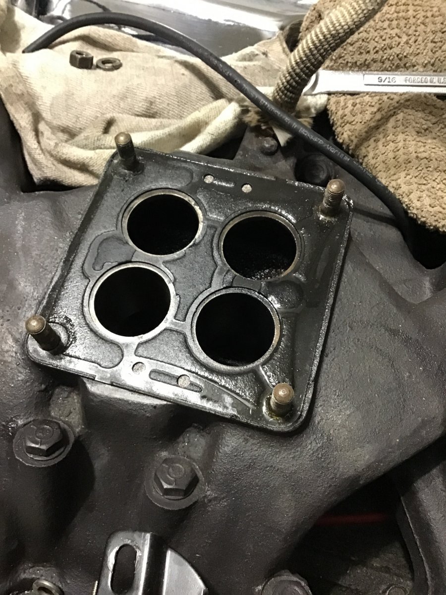

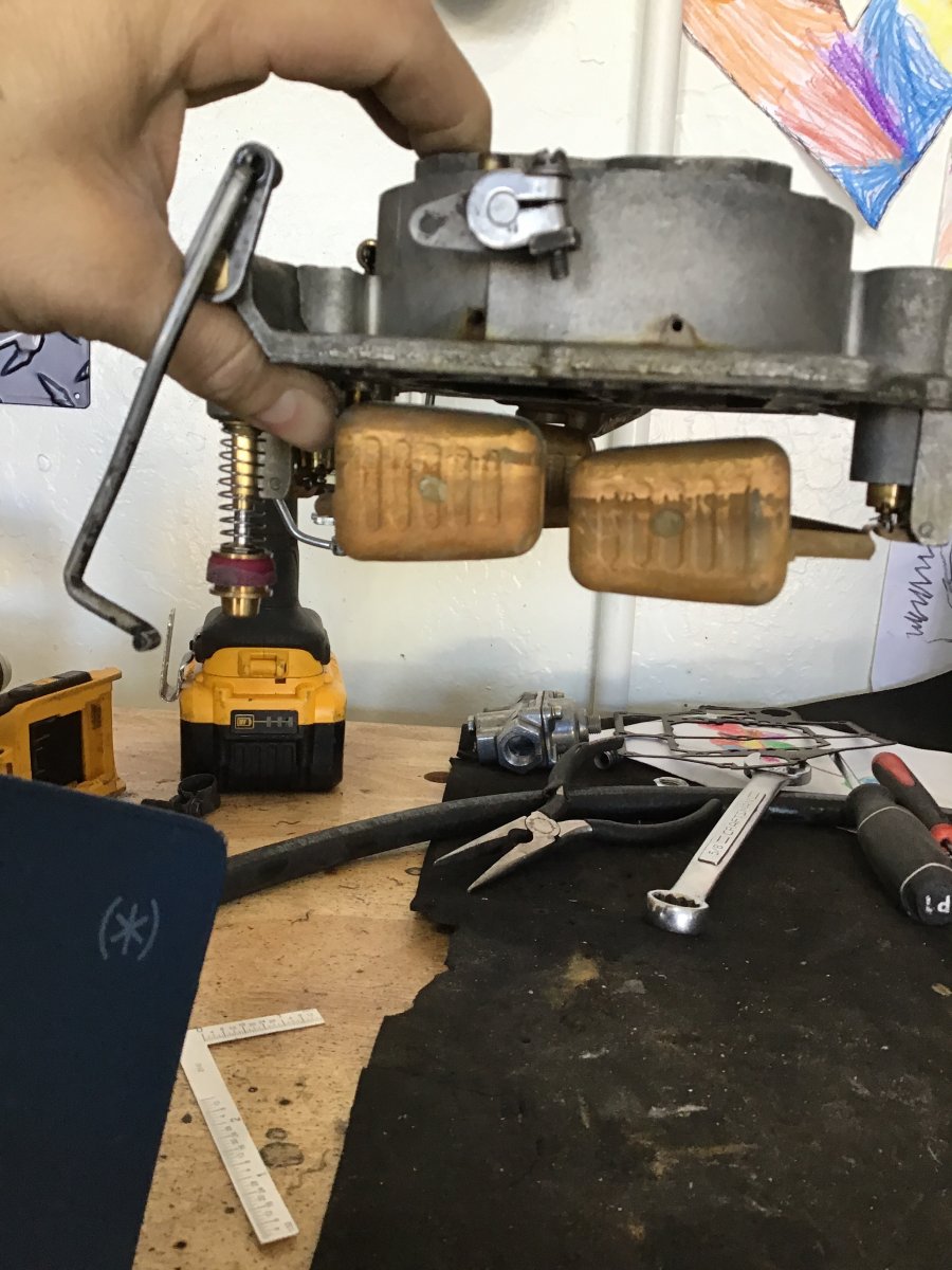

  4. footbrake
    Joined: Sep 3, 2009
    Posts: 152
    footbrake
    Floats to the left are way too high,they'll spill over every time.

  6. deathrowdave
    Joined: May 27, 2014
    Posts: 5,105
    deathrowdave
    from NKy
    The photo of the top in the correct position , floats down as stated you primary or floats on the left side are bit way to high as stated . Always check with a drill bit or know size round stock

    I recheck my floats per everyone comments, I used a 1/8 and 1/4 drill bits. The bits verified the current level

    Carter measures the float vertical height at the CENTER not the end of the float, raise your front float to about where your rear float is and you should be good to go. Once you get it running without fuel running into the engine then you can tackle the idle circuit.
    I've done bunches of them even have the original Carter float level tools.
