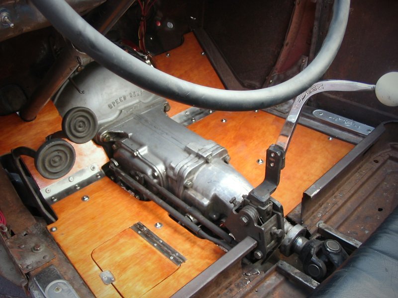

    The three, four or five speed shiftier's. heck even the automatic shiftier's in your hot rods or customs, you gotta get the car in gear somehow.
    The one in our Ranch Wagon is a modified handle to was originally in my old 63 1/2 Falcon Sprint and had laid under the work bench since the early 70's, I cot the shifting part off and adapted it to the T-5 transmission. HRP

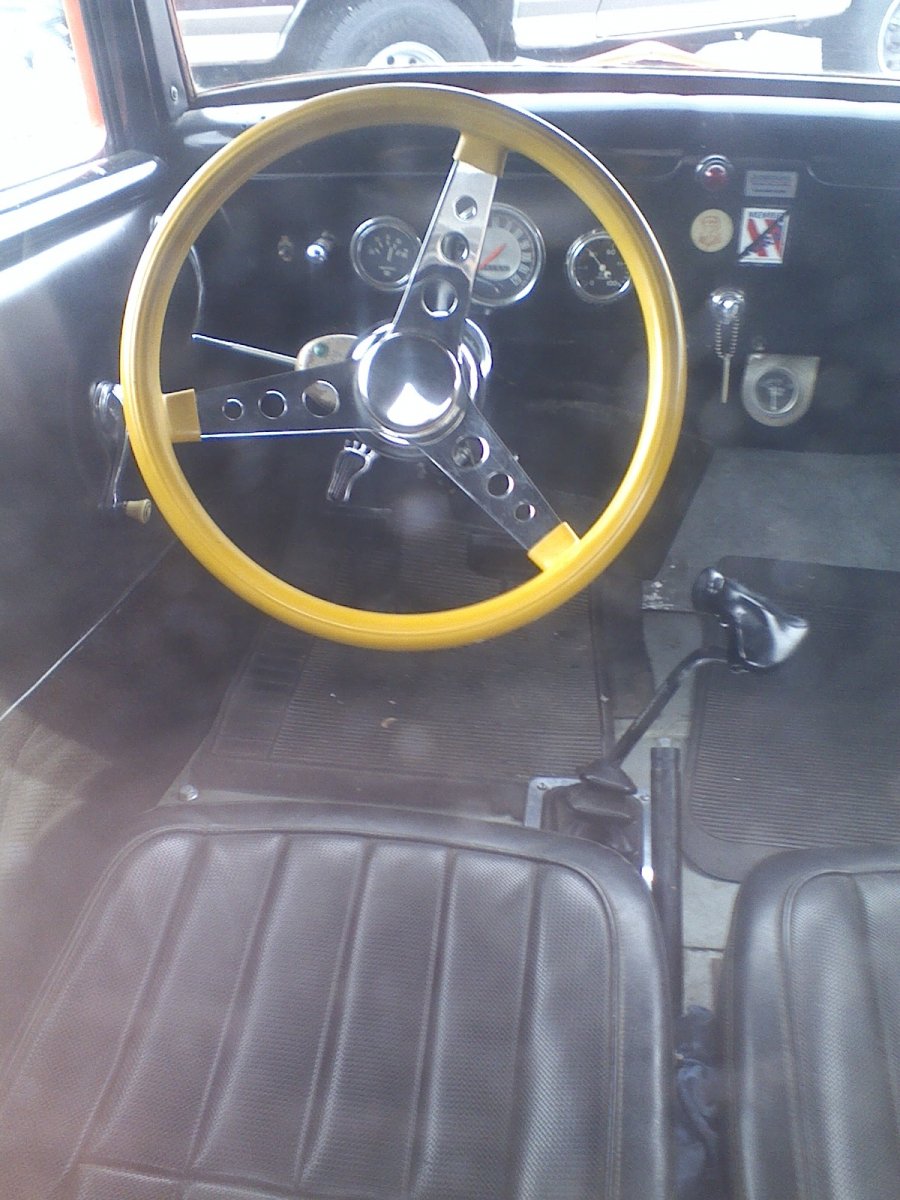

    When I was in the pre planning and mocking up stage I bent up some steel rod thinking it would be more utilitarian in nature but as the build progressed I new I was headed for more of a 60's style and opted for a traditional hot rod shiftier in keeping with the look. HRP

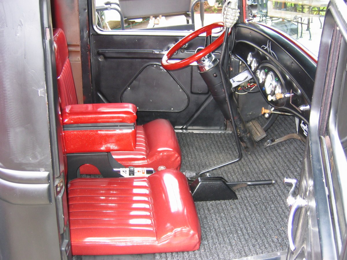

    Can’t see it too good in this pic... but it’s all I got. Here is the outside shifter on my T racer. Made up from Model T e-brake handles. One is a lever to hold the car in neutral and the other shifts the 2 speed rear axle. All reshaped and shortened prior to nickel plating, and topped off with a special made zebrawood shift knob stained to match the maroon upholstery

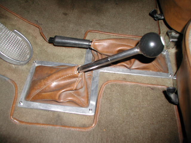

    Back when we first got the channeled coupe, the Hurst lever was directly under your leg. In a shade tree version of what DD Denny did, I used a m***ive vise to perform a double bend surgery on it. Now it hugs the side of my leg perfectly: FE405B62-C4B7-415E-94B6-36D91FCB3F99.jpeg 8E46FC31-55AE-4D3C-8CD3-95DBF6D1E3B3.jpeg

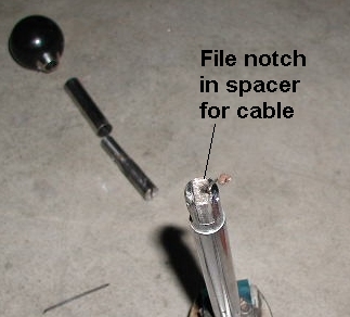

    I built a tall shifter ***embly for my T-Bucket with a Turbo 350 transmission. The spring loaded gizmo on the p***enger side is the reverse lock out ***embly. There is a cable that runs to a knob on the floor by my left leg that I have to pull in order to get into reverse. I was running out of space under the car, so I installed a cable operated neutral safety switch behind my seat. I use an old cut gl*** house door knob for a shifter knob.

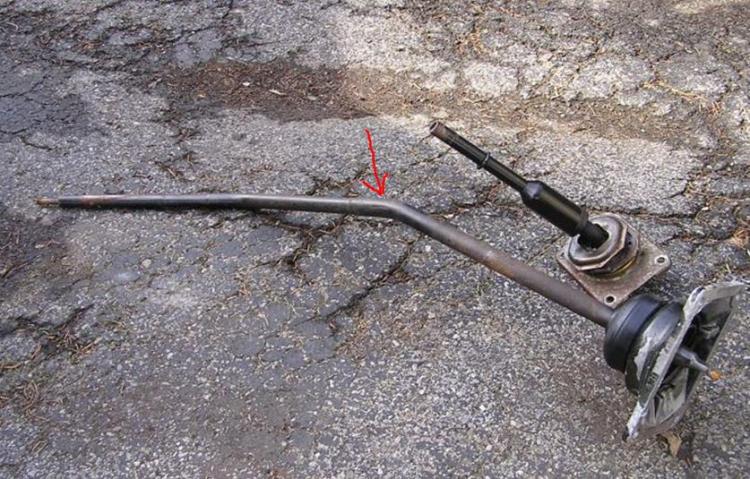

    When I put the T5 ****** in my 51 pickup I bought a shifter off Ebay. Seller wasn't sure what it came off of, but thought it was probably a large truck. It was very long and had two bends (hard to see them both in the picture) so I cut the lever at the first bend (see the red arrow) and welded it to the Camaro T5 shifter (after converting it to a short throw).
    The remaining lever was pefect, allowing it to form around the seat.
