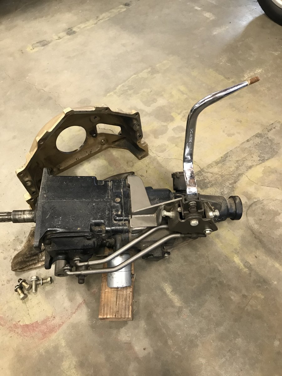

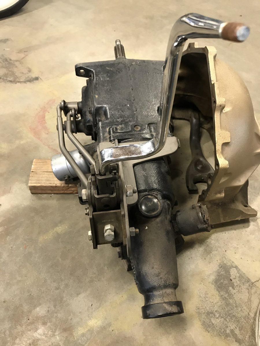

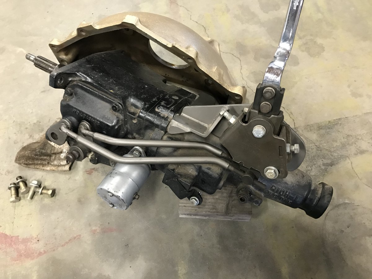

    I actually bent that handle like that and had it rechromed. It was a long handle (maybe for a truck application?) The shifter mechanism was a $10 swap meet find, I bought it because it had the long bolt on handle that I thought was unusual, especially for a 3 spd shifter. The knob was right where my hand falls when sitting normally, that was how I planned the new brackets and rods. I had Dodge van bucket seats in it like Dave Shuten had in his green ‘32 sedan.

    Now that is some nice work. HRP

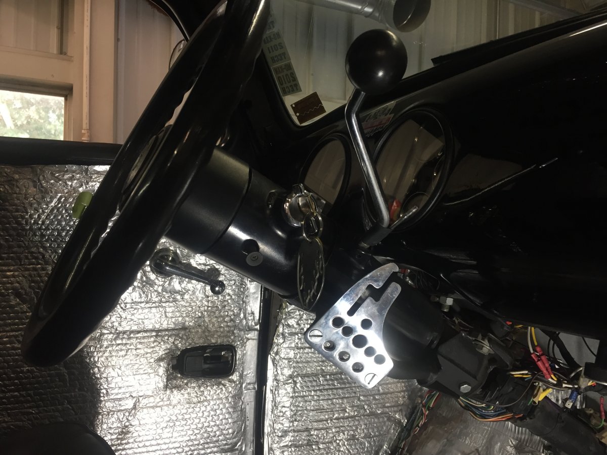

    Here is the Z gate column shifter I made for the old truck. If you look close you can see the pin on the shift handle that fits into the the Z gate when you work it through the gears and down into low gear of the turbo 350 transmission. You slap upward once into second, and then slap it again into drive. This keeps an old man from missing a gear at the drag strip. IMG_0417.jpeg

    Now that is a slick piece, I really like the idea behind it. HRP

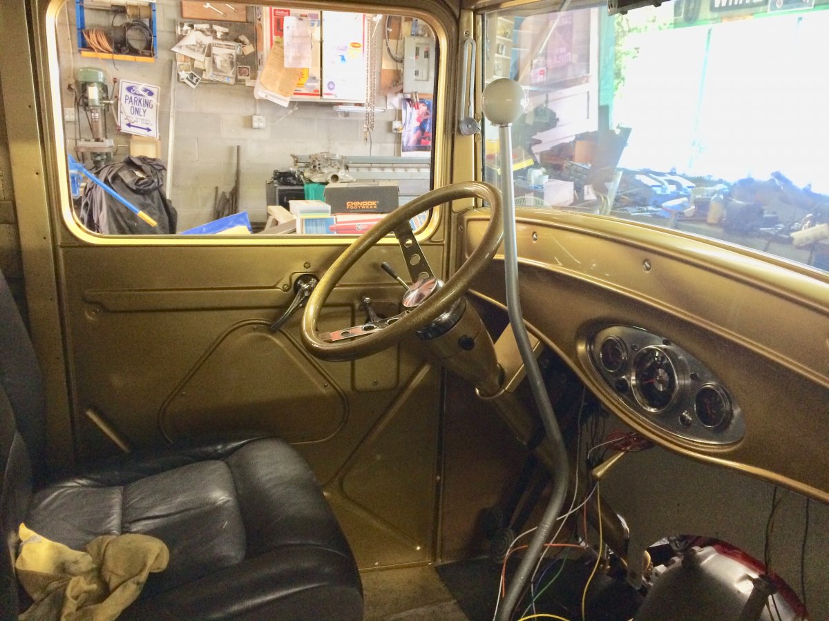

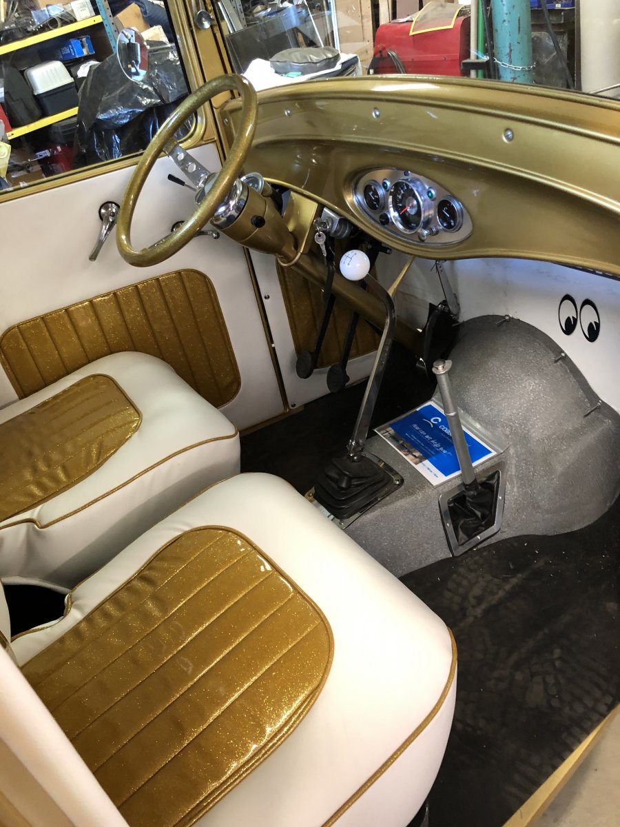

    I have two; the tall one that I fabricated, and my first one from when I was 16 years old. On both I use an old Hurst 3-speed knob.

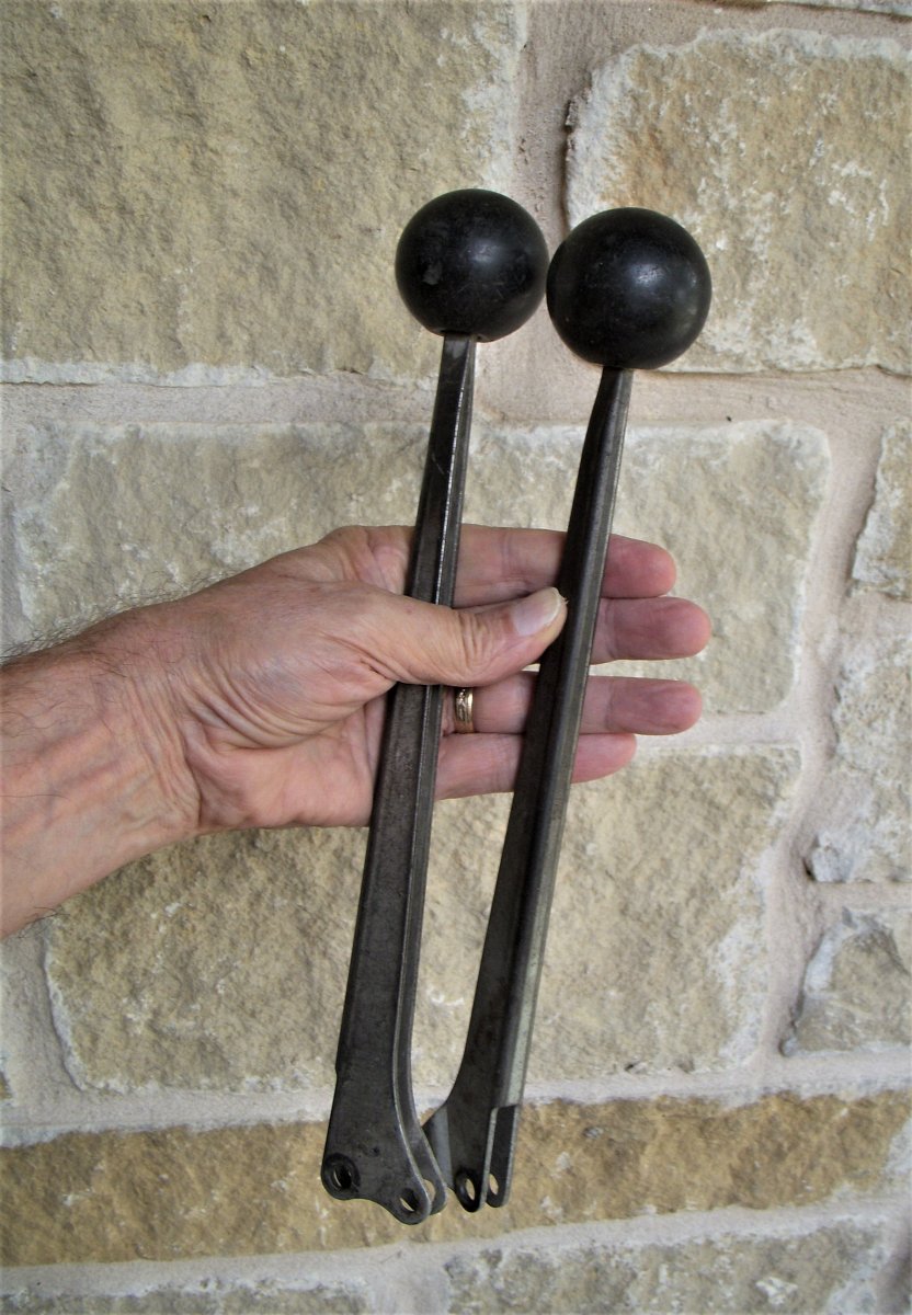

  23. I'm always on the lookout for possible shift levers. I Picked up a pair of forklift or heavy equipment levers that look like it wouldn't be too difficult to weld an adapter in the slot on the bottom.

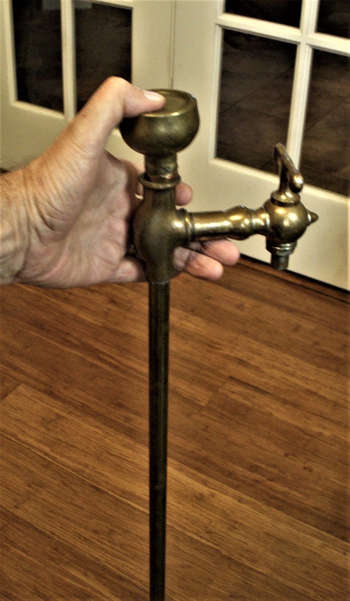

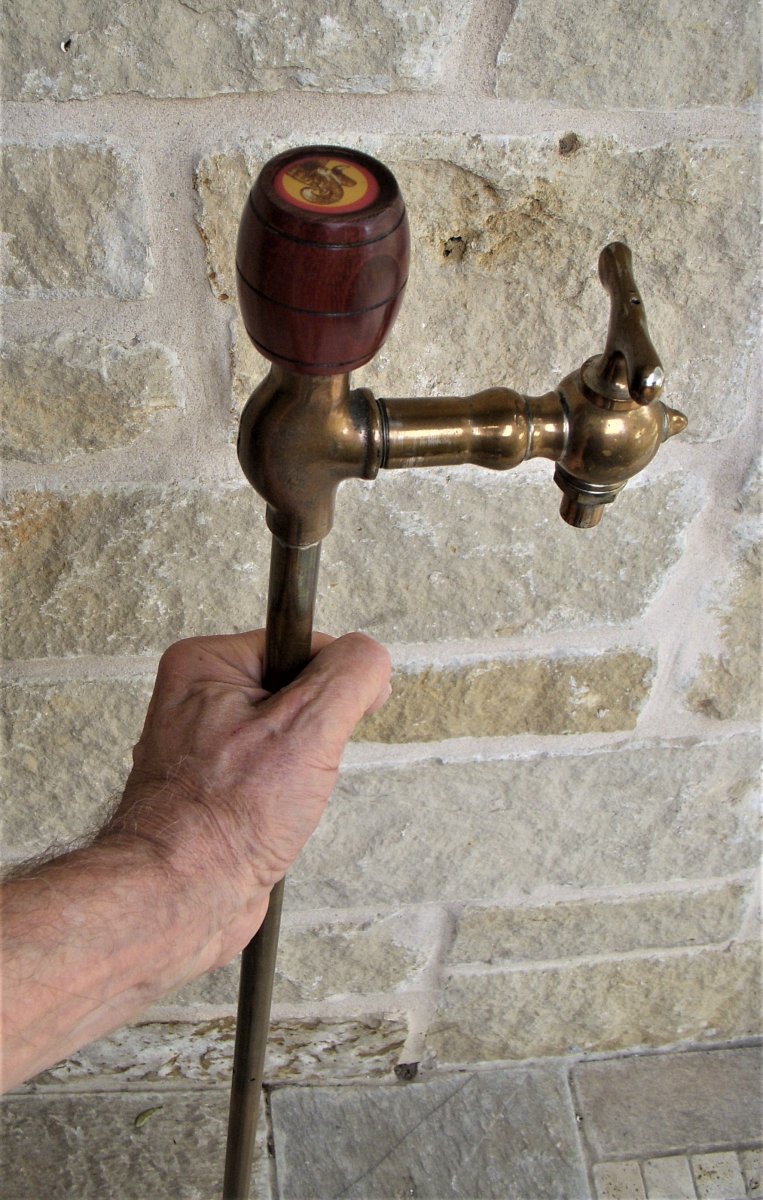

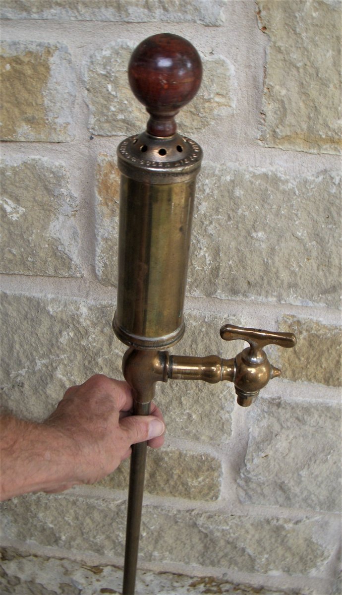

    And I have this really old beer tap that can be configured as a lever many different ways. It's fairly solid and so is rather heavy with the pump on it, though.

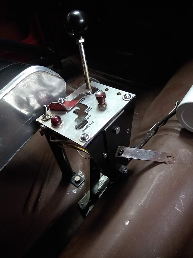

    for a manual shift slushbox. And it's legal for racing.
    switch and light are for the switch pitch torque converter, push****on and the relay that you can't see are to engage the Lay**** De Normanville overdrive, but only in high gear.
