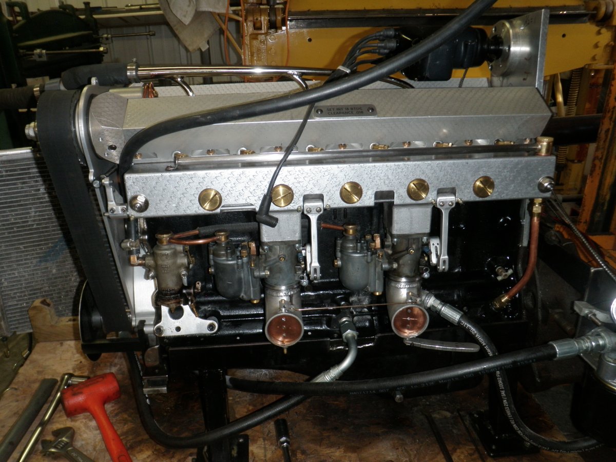

    It's together and running on the test stand with P1011208.JPG P1011205.JPG P1011214.JPG P1011201.JPG P1011200.JPG some changes to the Gilmer belt cam drives, tensioner, and water pump.
    Next is dyno testing, and ultimately installation in the as yet unfinished '30's dirt track race car.

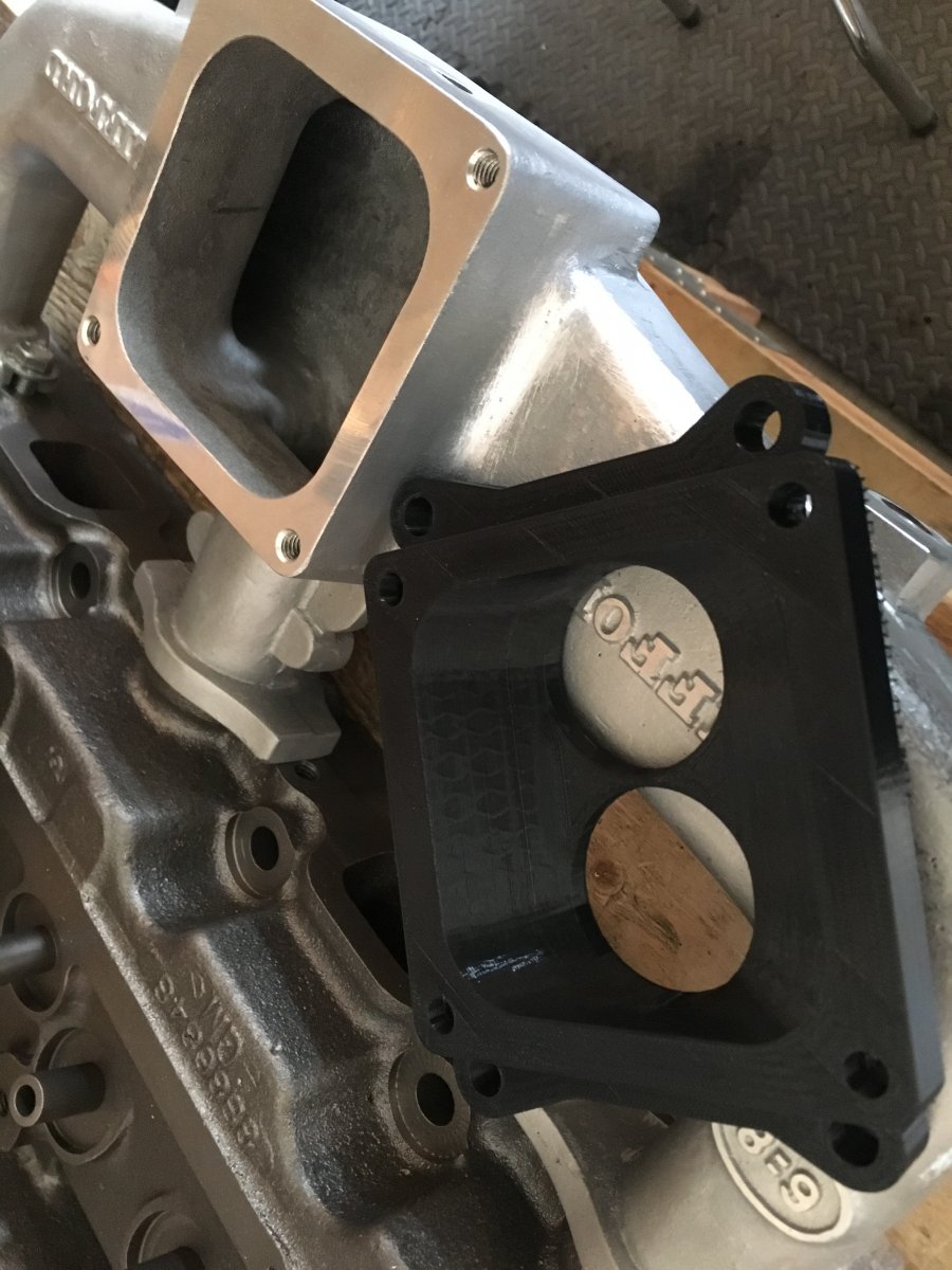

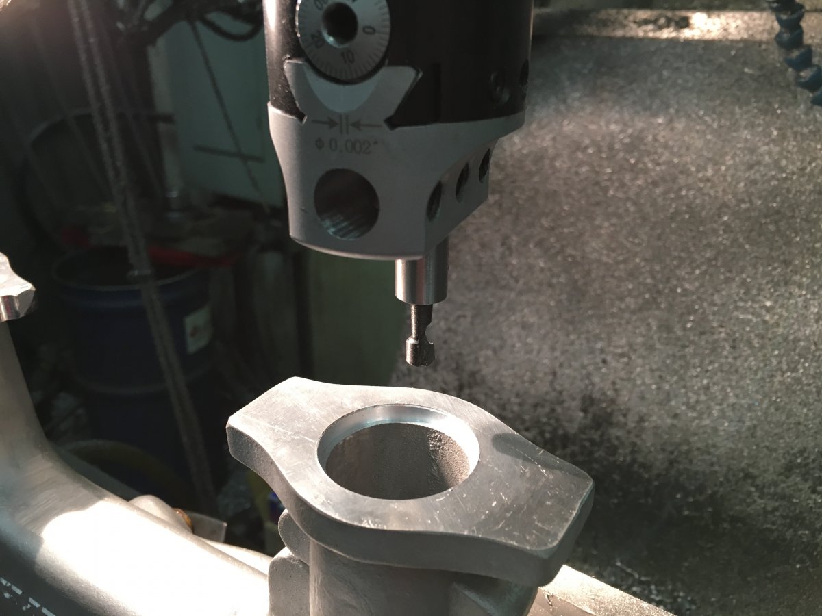

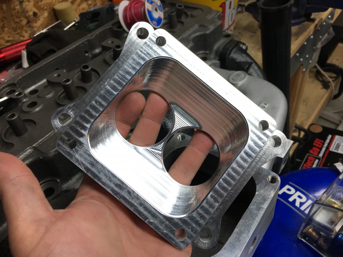

    The larger power glide valves will be a nice touch with the milling. You using the smaller chamber 848 head? I just ready to start my new 261 build up as im having a issue with the 235. I have the larger valves also ready for the new head work. Not sure if im going to mill it as that will also required the valves to be recessed but maybe someone might twist my arm just enough so I might just end up doing it. Spent early spring doing a few mods to the 235. Got a 2 barrel EFI setup. I used a Clifford Intake and modified it to properly fit the 235/261 heads as the way they sell them is kinda poor. Made my own adapter to work properly between the 2 barrel and the intake manifold. Bough myself a CNC machine for the garage and made up the adapter after I was happy with the 3d printed setup.

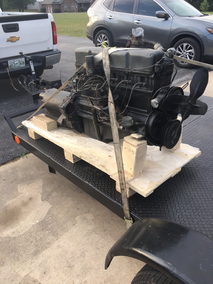

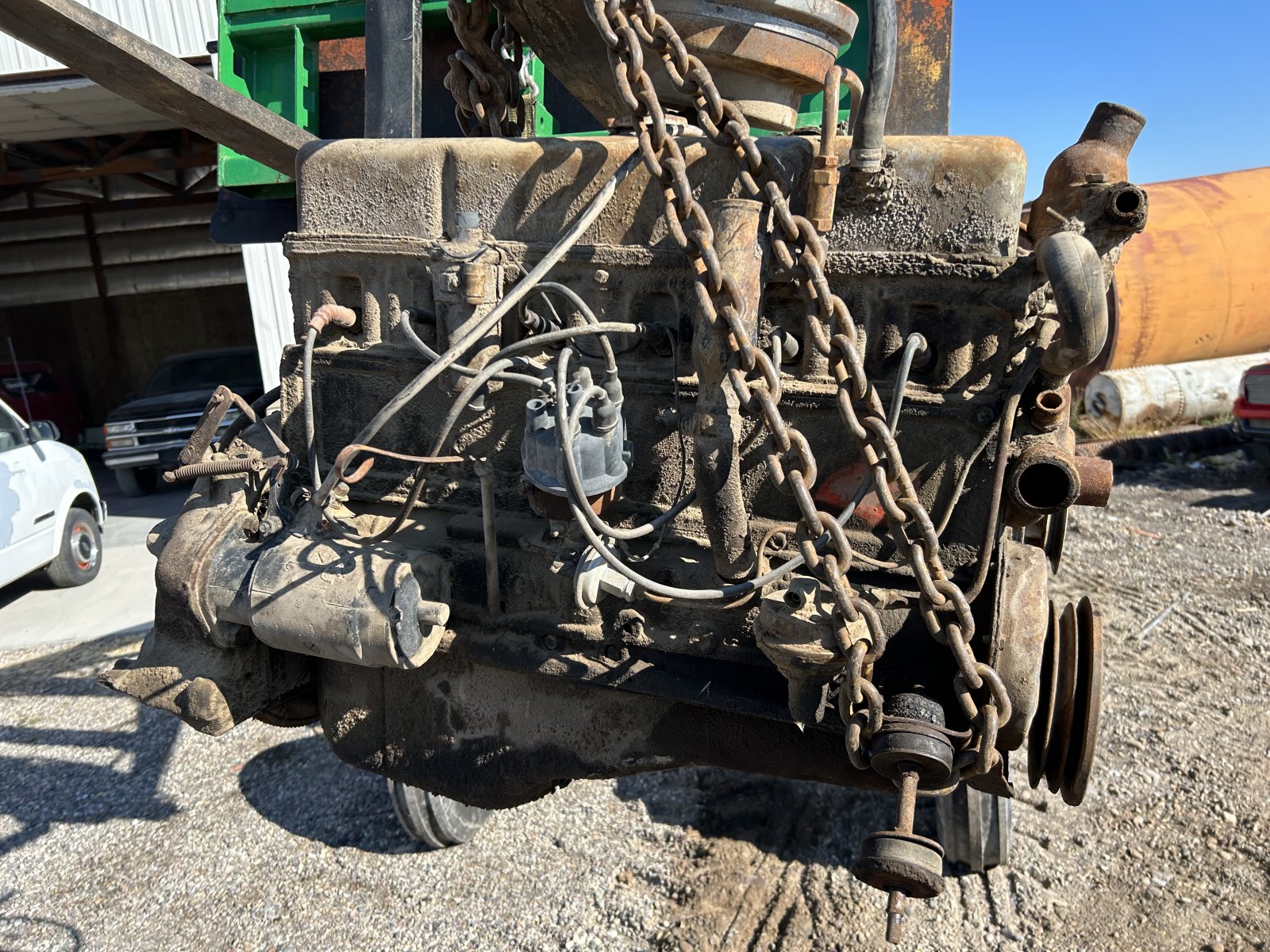

    Hi all, glad to be part of the 261 club. I just picked one up with a 1955 Hydra-Matic attached to it. Unfortunately I can’t find a start for it so the engine will be attached to a SM420 with a new rear end. IMG_3672.JPG IMG_3572.JPG IMG_3673.JPG IMG_3417.JPG

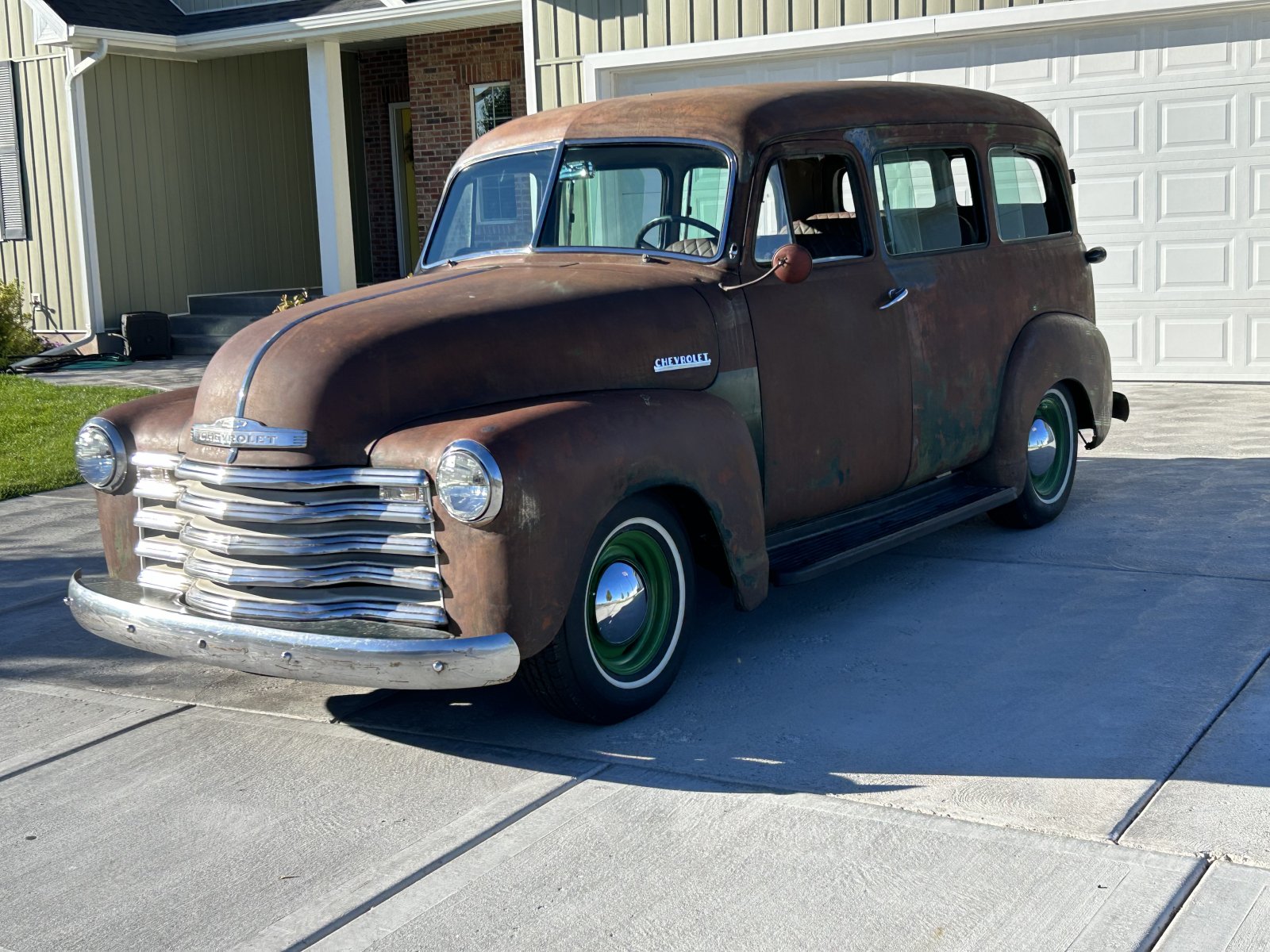

    Here's my 55 that the 261 will go into. I'm running the stock SM420, with the stock 4.57 gears, and I will be putting a Brownie Junior overdrive in it, which is 0.82:1. I have a set of 4.10's for it but I decided that with the 34" tires that by the time I get into OD that I'd be under geared. Anyone disagree with that? My plan is to do some mild work on the 261. I'll put a cam in it, and run a nice upgraded intake and exhaust. This thing isn't built for speed anyway, so that's not my concern. It's very hilly where I live so I'd like to be able to pull the grades around here and hop on the freeway and feel safe in the right lane on a weekend morning. [​IMG]

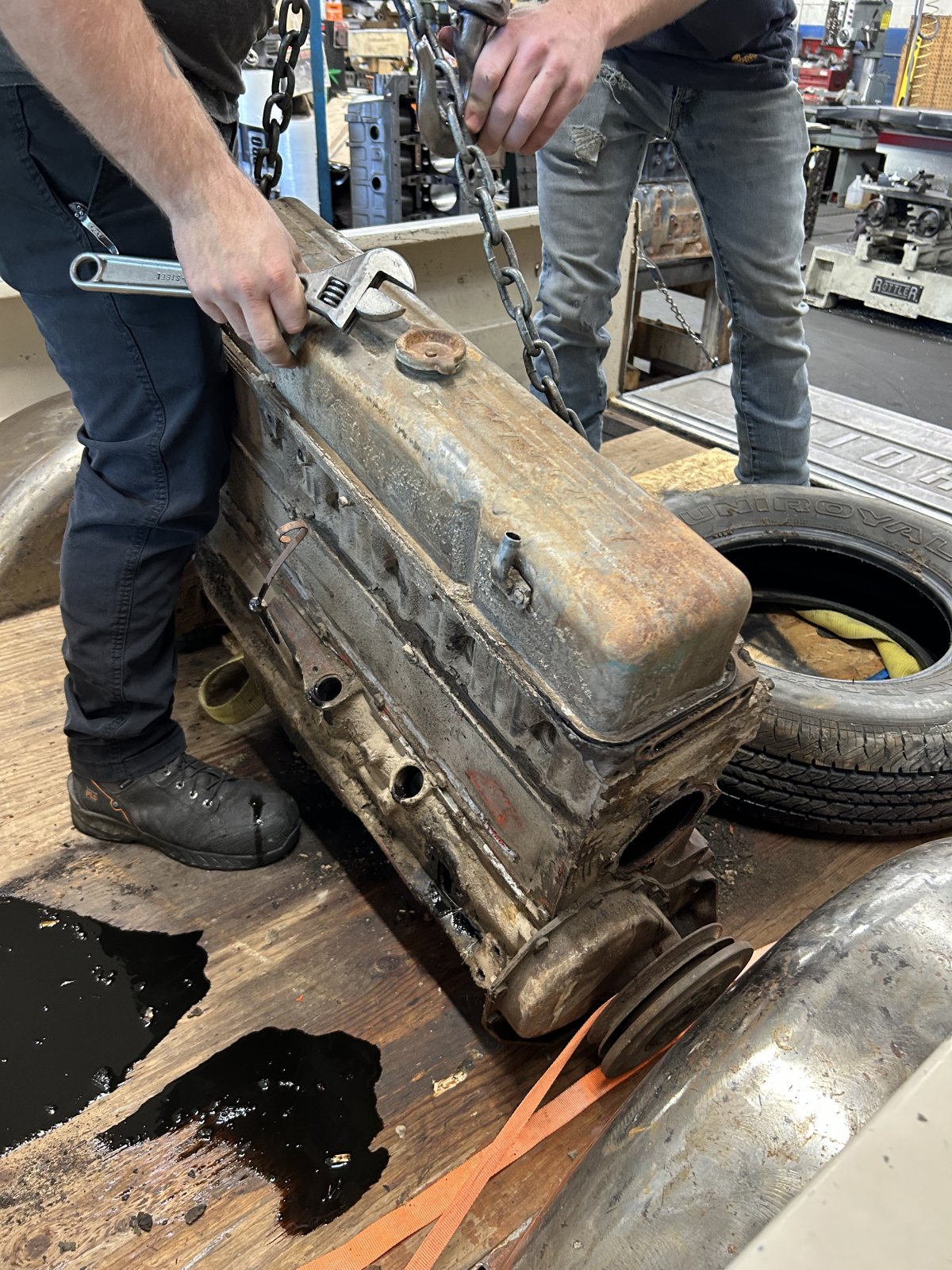

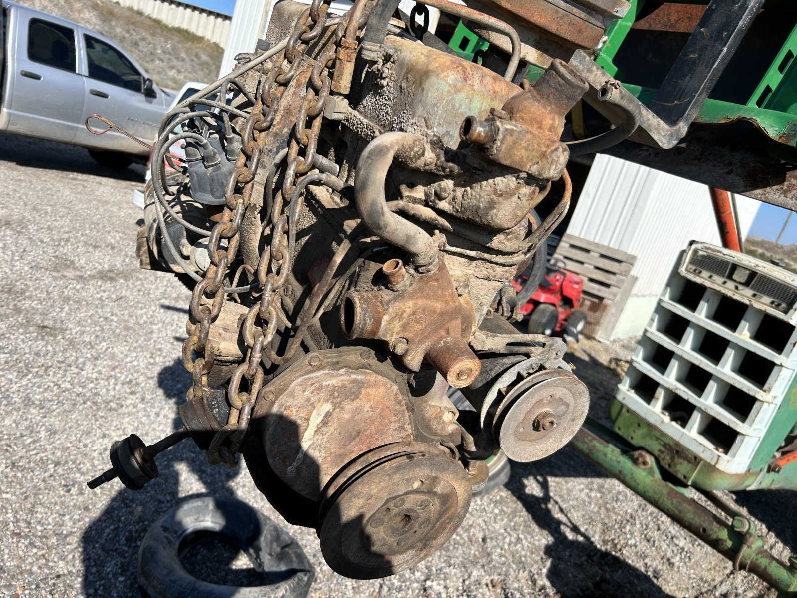

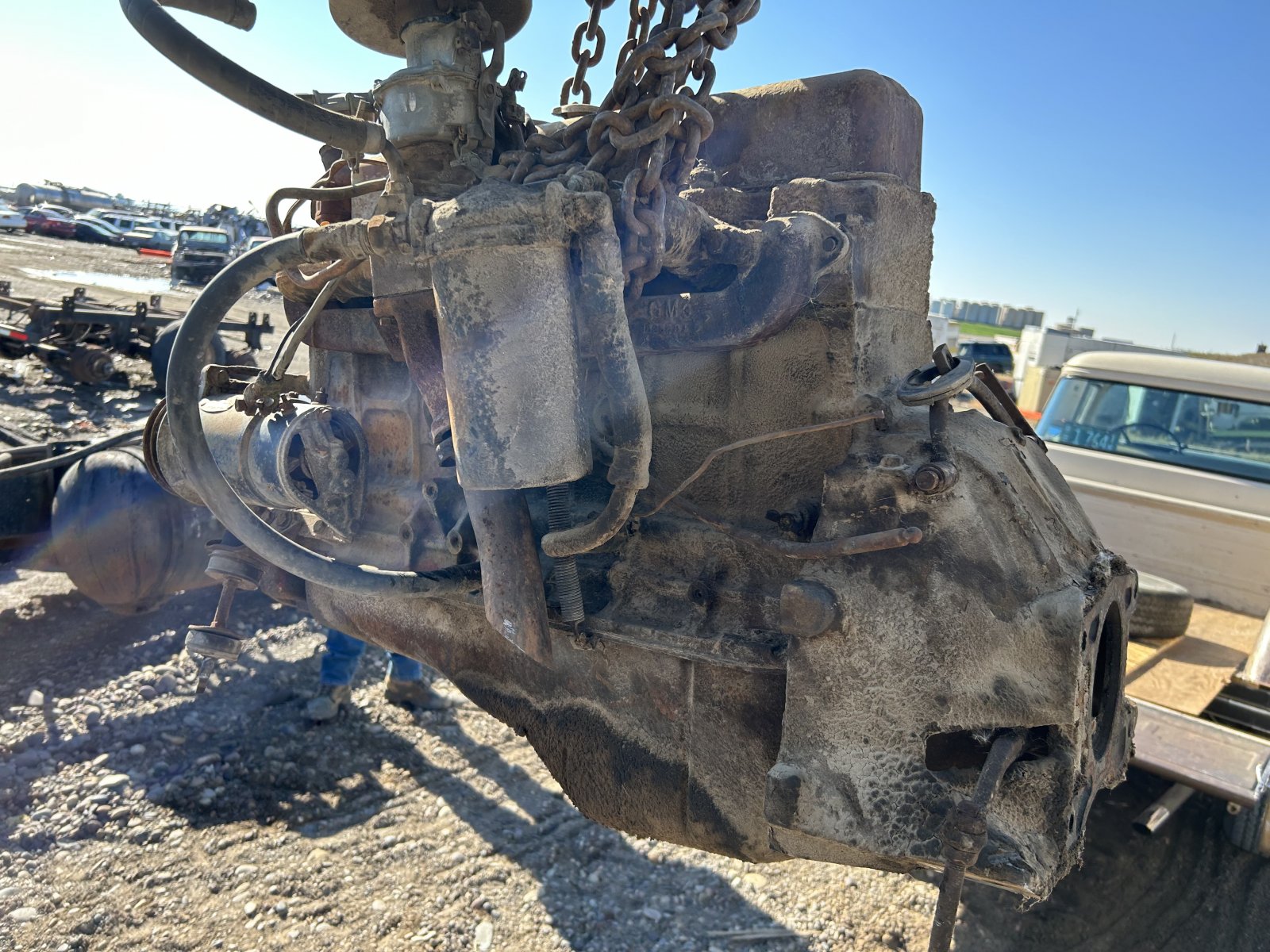

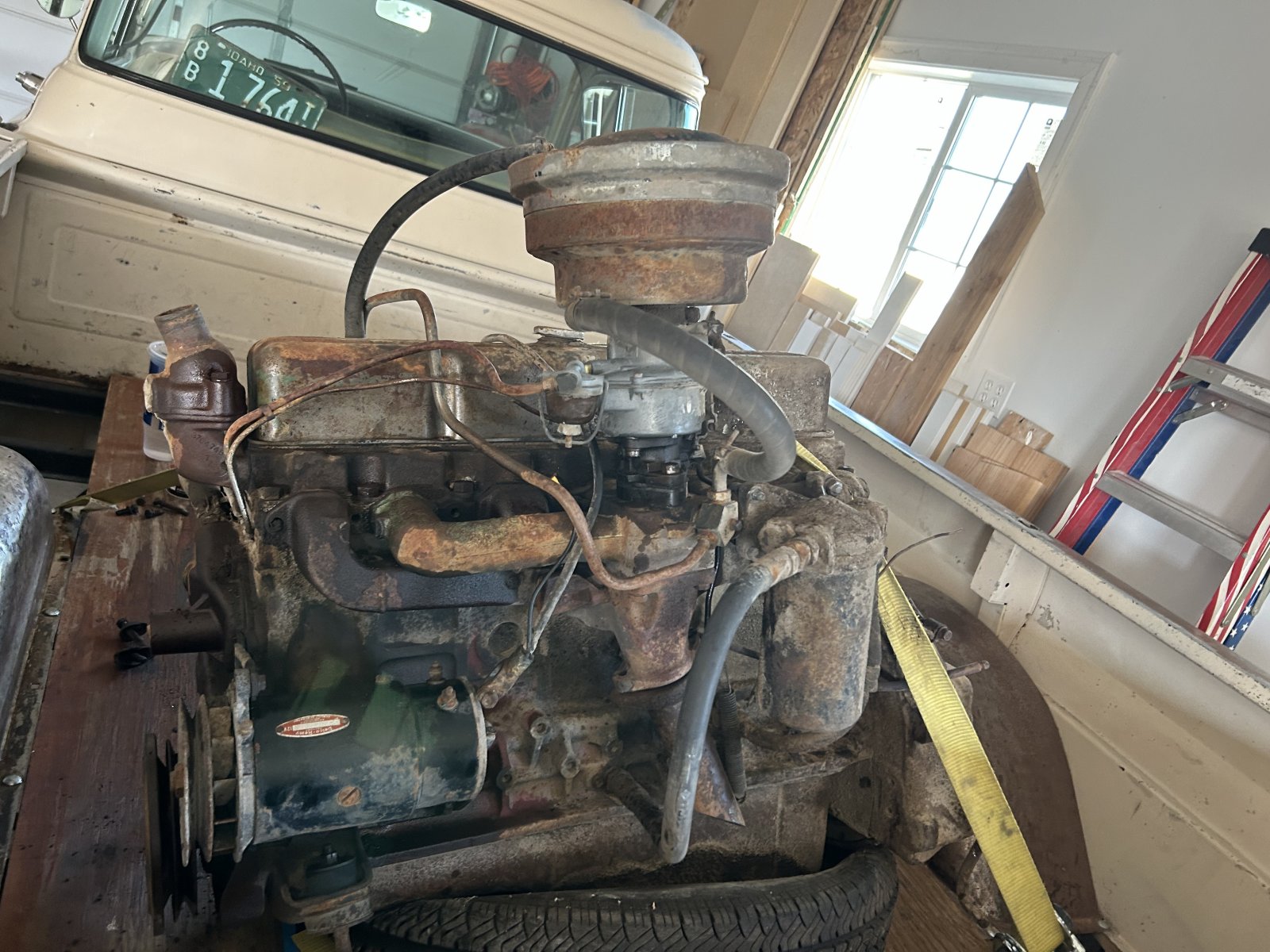

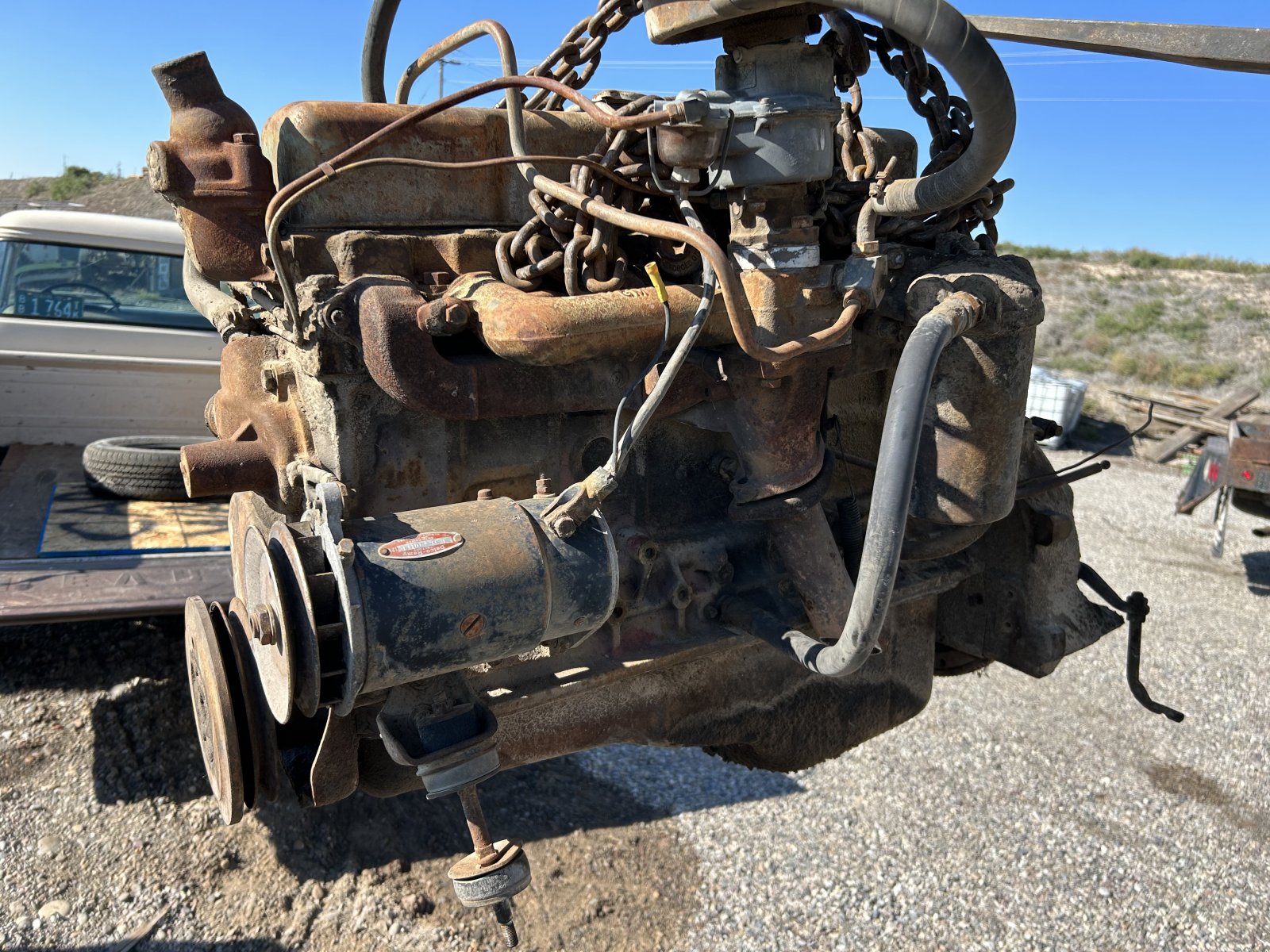

  28. D Newcomb
    Joined: Oct 14, 2020
    Posts: 484
    D Newcomb

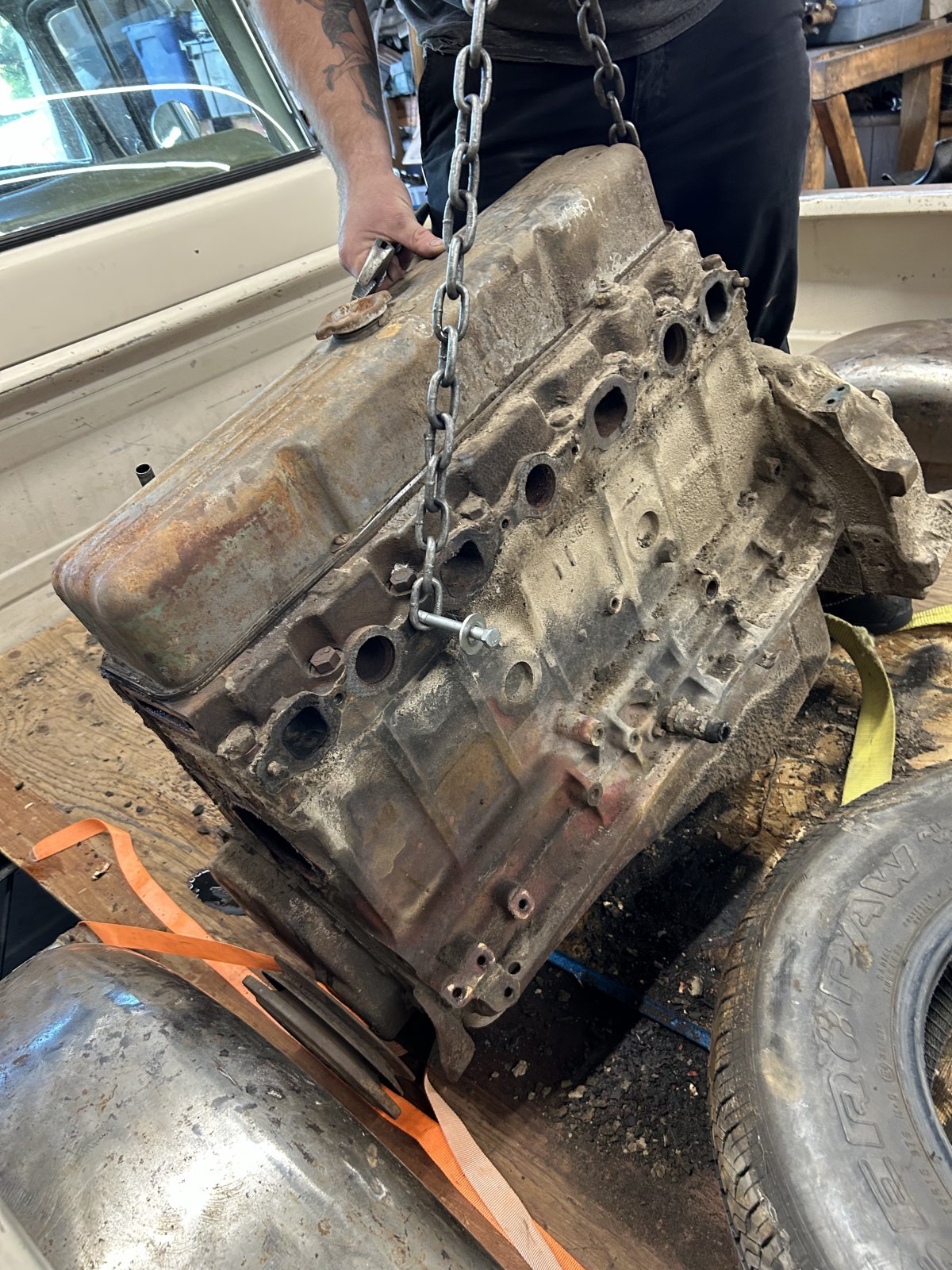

    Found two 261's both without crankshafts. Can A 235 crank be used with the heavy 261 rods and larger pistons?? Newc

    That 55 1st. design.......with NapCo 4wd.......with my favorite color.......takes my breath away ......love it.
