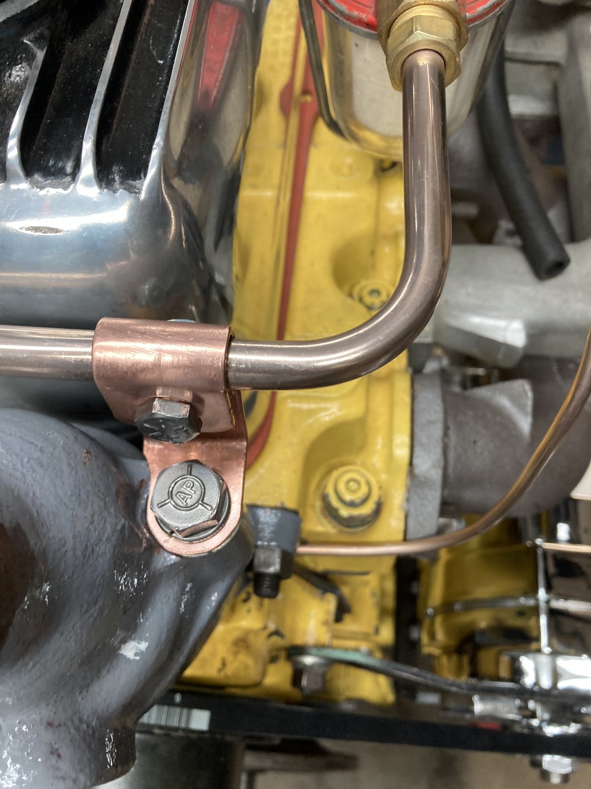

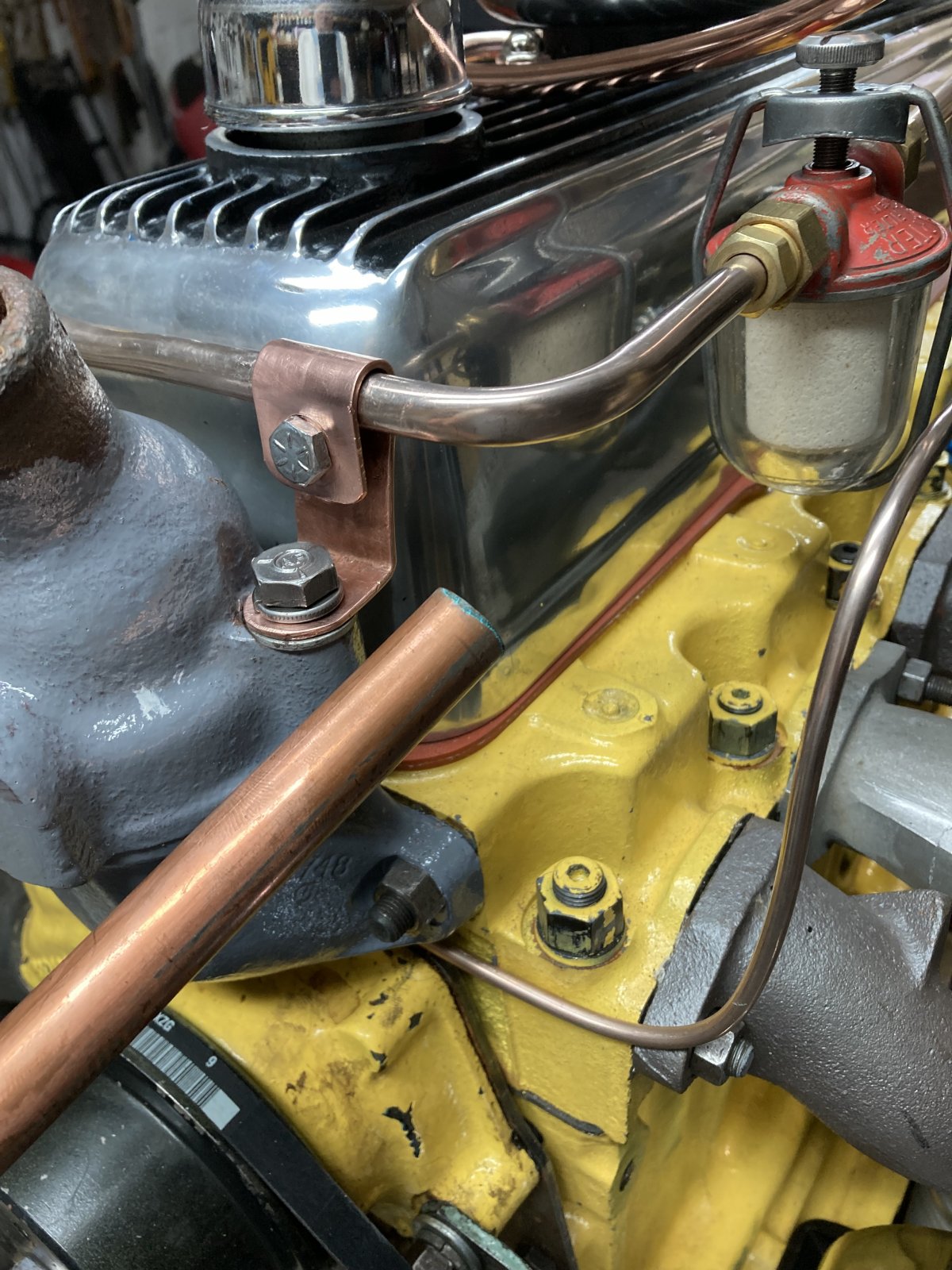

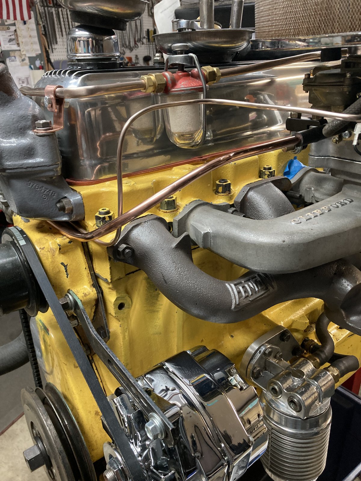

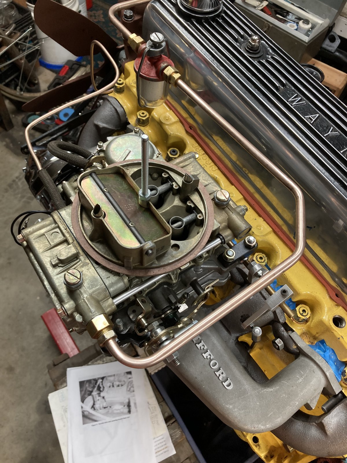

    261 set-up progress
    Fuel line to opposite side
    Fuel line bracket created from 1” copper pipe, flattened, drilled, formed
    Bracket approximately midway from pump to carburetor, supporting weight of fuel filter and less than rigid copper/nickel fuel line
    PCV, vacuum, and fuel lines, STILCO oil filter upload_2022-10-11_9-53-14.jpeg

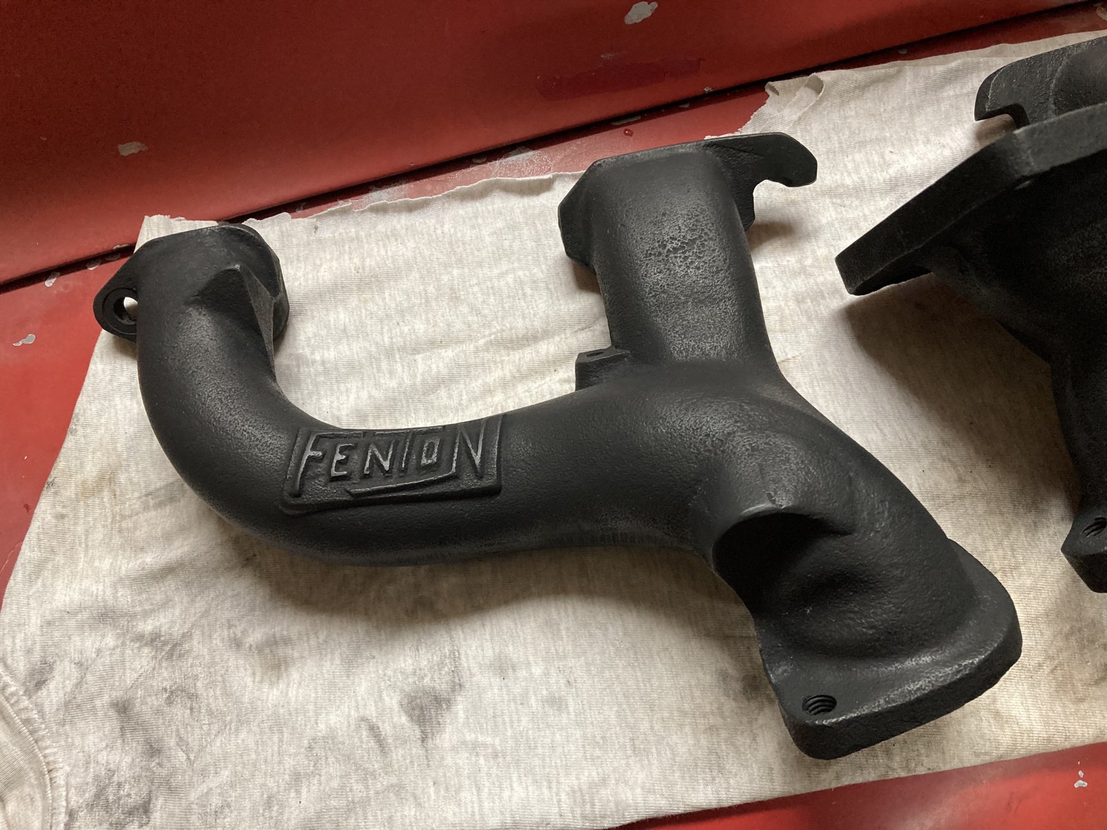

    Has anyone installed Williams headers? I had an original pair of Fentons I was going to install but one of them is warped too far out of flat to mill. I really don't want to use the foreign knockoff Fentons if I can avoid it. The Williams headers are made in Iowa. I've heard that they are very nice parts from a guy that saw them in person at a swap meet where they were being sold, but not from anyone that has run them. Current pricing on them is $295 a it says they are no longer drilled and tapped for the heat plate kit... So that'd be an extra cost. I feel like it'd be worth it though to buy domestic. Thoughts?

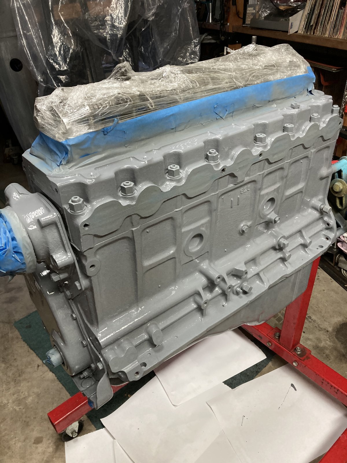

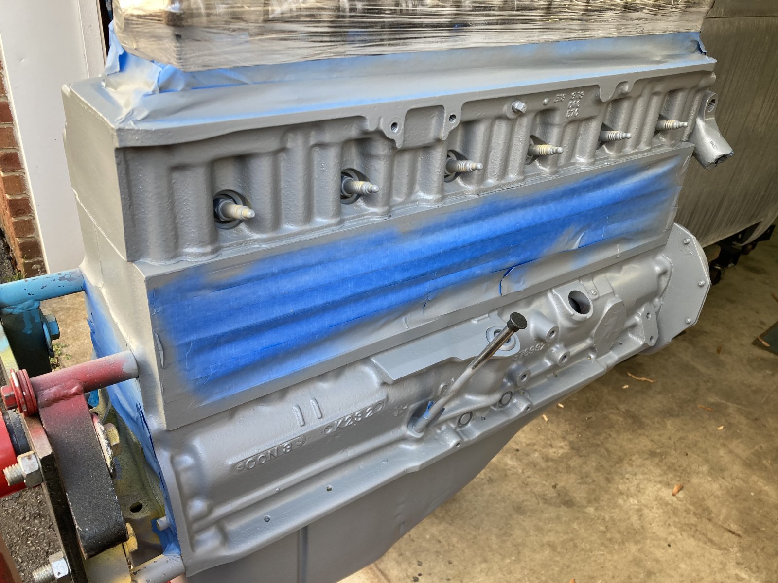

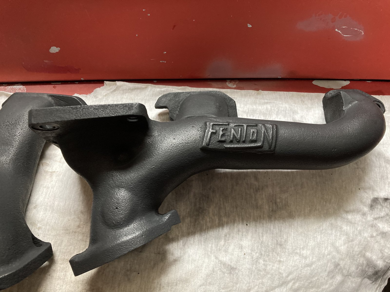

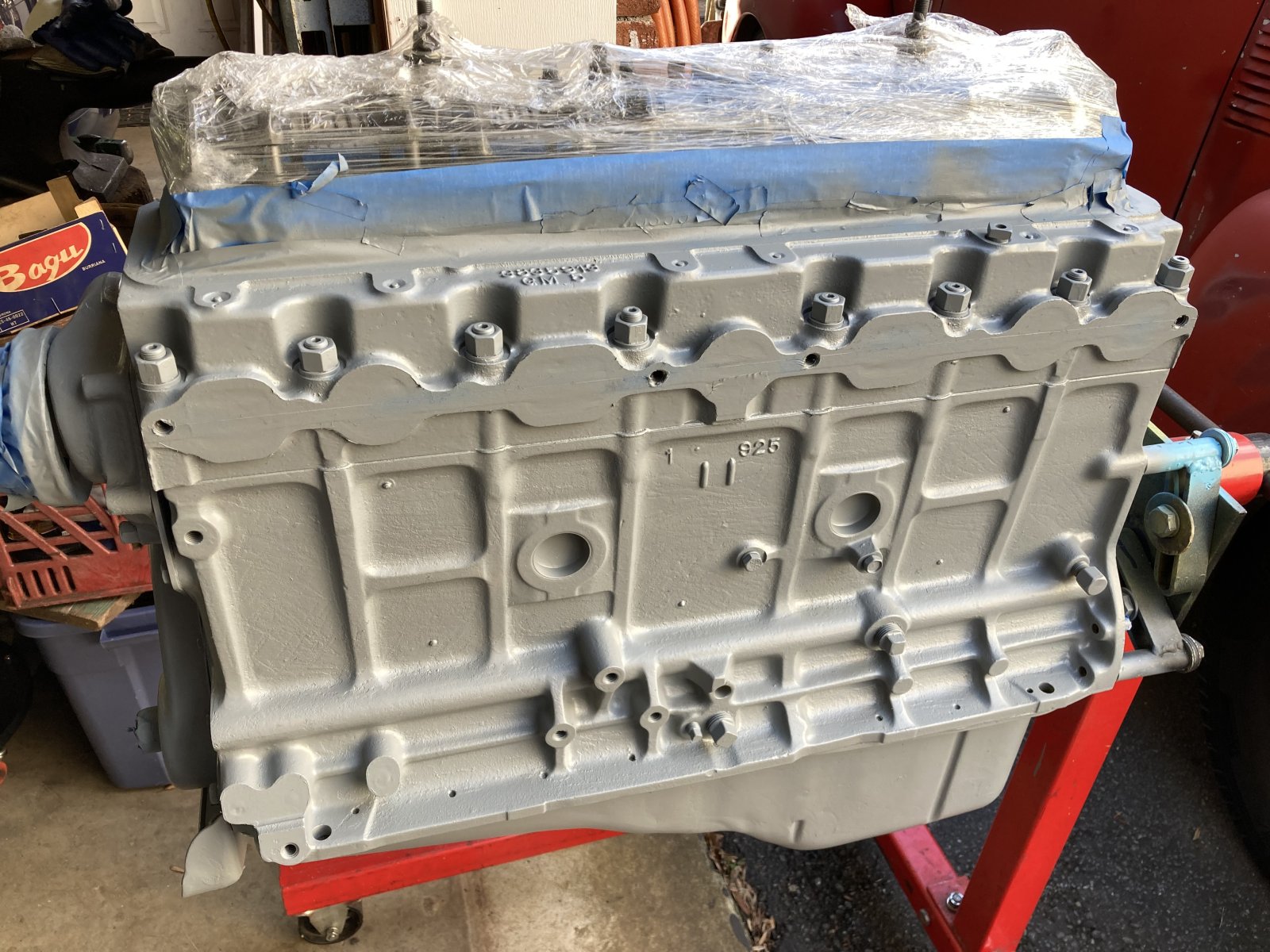

    upload_2022-10-31_21-28-44.jpeg upload_2022-10-31_21-29-12.jpeg upload_2022-10-31_21-30-18.jpeg
    Came out really, really well. 3x primer, light coats, 3x color light coats.
    Baked in the outdoor grill, 30 min 250, 30 cool down
    30 min 400, 30 cool
    30 min 550, (grill was making noises so I didn’t go higher) cool to handle
    It’s ON THERE!!!

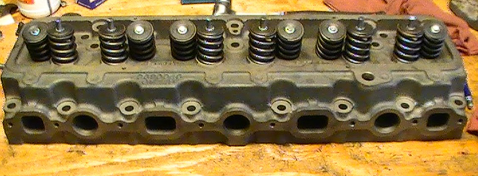

  11. I am looking for some information on this one.
    Does anyone know a what has to run modern roller rockers (I was told these are Big Block Chevy) on a BlueFlame?
    Does it have anything to do with the side cover on the left side?

  13. 270ci
    Joined: May 17, 2010
    Posts: 497
    270ci
    That's certainly not a 261 Chevy head with those roller rockers. The exhaust valves are not angled inward, as Chevy head would be. With straight valves and the head bolt arrangement, it looks like a GMC to me.

    Definitely a GMC. I’ve never seen individual rockers but there is a 1/2” plate on the other side of the springs for the screw in studs for them. There also would need to be guide holes in it the push rods. The 7 head studs on that side hold the plate valve gear. The cam drives the fuel pump and a belt drives the dry sump pump. Appears to be a Wayne cover with the name removed. I’ll bet he had time to measure rockers to fine ones close in length.

    I believe that is Bob Corbett's (out of Colorado) GMC in his dragster. He did make an adapter and a lot of work to use individual V8 Chevy rocker arms. He did do nice work and had that GMC on nitro running in the 8's at Bandimere Dragstrip. His billet headed GMC ran in the 7's.

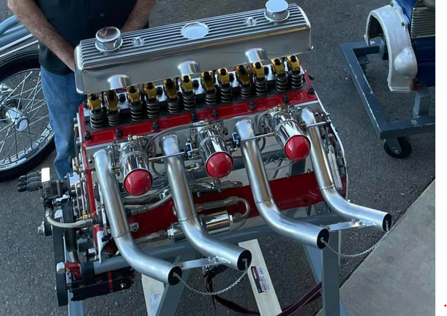

  16. A-ha I was very confused what was going on and how the valves weren't canted, I have never gotten involved with the G.M.C. I knew about the difference in valve arrangement between Chevy and the G.M.C the number of freeze number of freeze plugs.
    Stronger, less friction freeing up a little power and being an aftermarket hi-performance, the ratio is going to be right on the money
    Cosmo49 likes this.
  17. Gofannon
    Joined: Feb 8, 2007
    Posts: 1,013
    Gofannon
    Reduces side loading on the valves, so you don't wear out your valve guides prematurely. Chevy and GMC rocker geometry is not good for high lift cams. At the least, rocker stands need to be machined to correct the geometry.

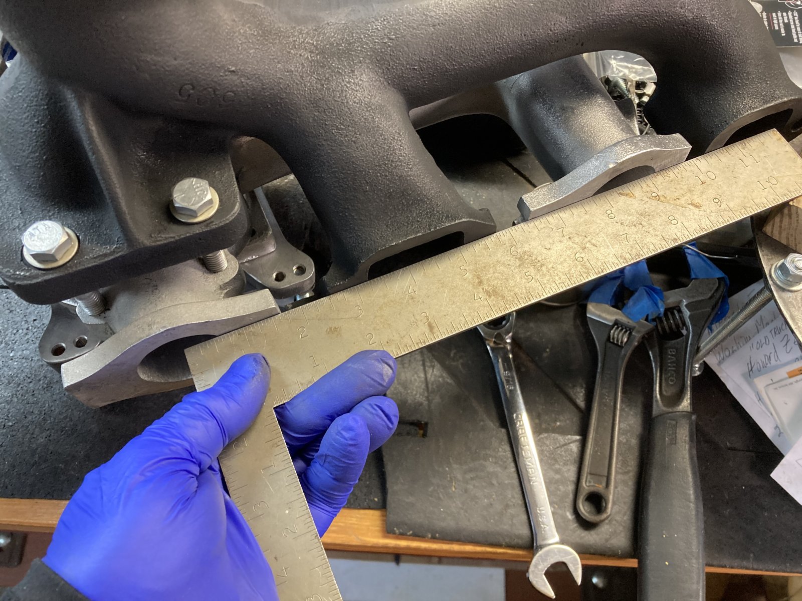

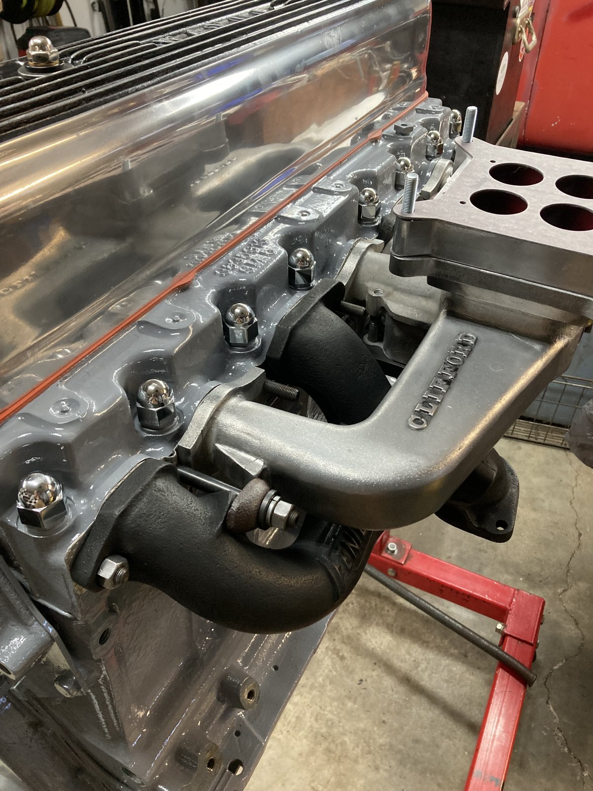

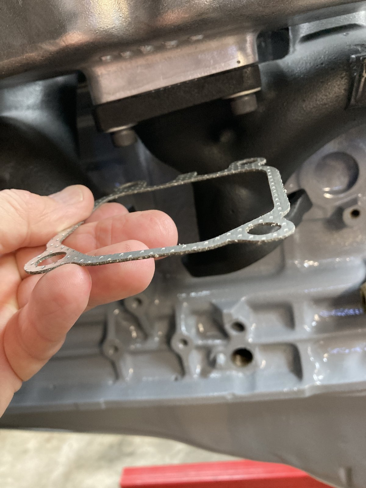

    I’m doing a few hours every day. I’ll do some touch up of chipped paint at the end, chasing ghosts while trying to make progress isn’t fun. I will be needing an XL horse shoe as a support on the carburetor side fender rod. The rod interferes with the carburetor, so the horseshoe will curve around it.
    My friend, ‘Pastor Grigg’ married Ms Clifford to Mr Fenton. Clearance to the width of this gasket which resides between the mated pair.
    Straight edge shows true alignment. I mated the intake to the right header with integral heat plenum.
