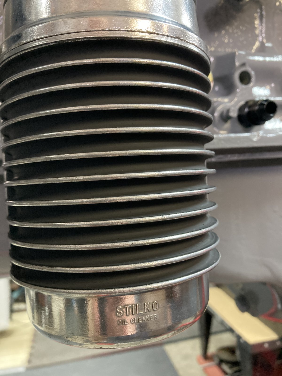

    Flat black spray and a quick wipe of the fins with acetone gives a nice pop to the STILCO toilet paper oil filter.
    Oil lines, finger tight, garage is getting cold.

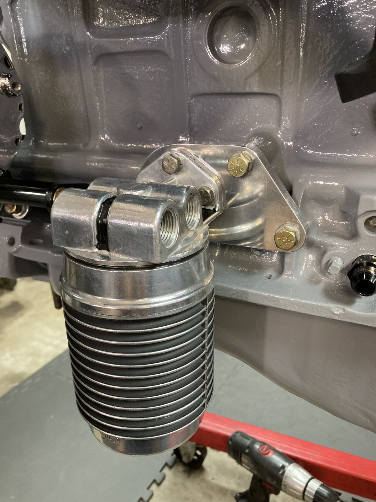

    Threw a little respect (polished) the aluminum oil filter bracket. Grade 8 attachment bolts are way overkill, it’s all I had in the size needed.

  13. I like the looks of having the oil filter on the block but is there room for your exhaust pipes to clear it? I mounted my finned filter to the inner fender wall on my 39 sedan,
    Also, they are called toilet paper filters, but I found a store bought filter to fit inside my can. I don't trust getting the correct volume flow with toilet paper. Toilet paper also louses fine particles of paper in the oil.
  14. Cosmo49
    Joined: Jan 15, 2007
    Posts: 1,615
    Cosmo49
    Yes, there’s room. I’m going to wrap the down pipes. They are close to the lines and I’d like to reduce heat. I’ve done many long distance trips and know it will help.
    There’s an old hand I know that was a distributor for these STILCO toilet paper filters back in the day. All that you said per toilet paper are rumors. He says that oil filters of today are good for filtering large particles, good only for capturing debris on initial start up. The toilet paper filters filter on a microscopic level.

    Modern oil filters ,big chunks, lol........Modern filters are in the 20-30 mircron range, about .0009 inches..
    And other than a brief periods of high pressure during a cold start, they filter full time....
    The 235/261 Chevy oil pump using a full flow filter is around 4 gallons a minute at 4000 rpm...you sure oil soaked "toilet paper" can p*** that much oil....Just wondering about myself

    Tony, hahahaha, I'm totally new to this filtration game, my '56 235 has never had one, 120k+ miles, changed oil 2x/year. The STILCO pictured is a byp*** filter according to a couple websites. It will filter all the oil in the by and by.

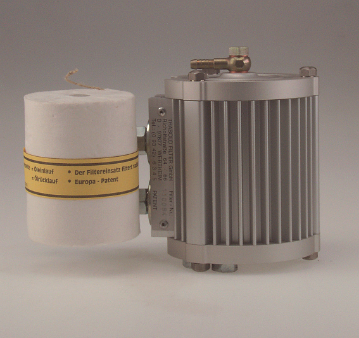

    I bought an original vintage Frantz Filter some years ago, but since toilet paper isn't what it was anymore (you barely can't find that greyish, thick stuff, that would double as a scotch pad) I bought a modern version that comes with special paper rolls made for it.

    Germany. http://trabold.de/v1/shop/
    But those rolls only fit Trabold filter housings, they are a bit smaller than typical toilet paper rolls.
