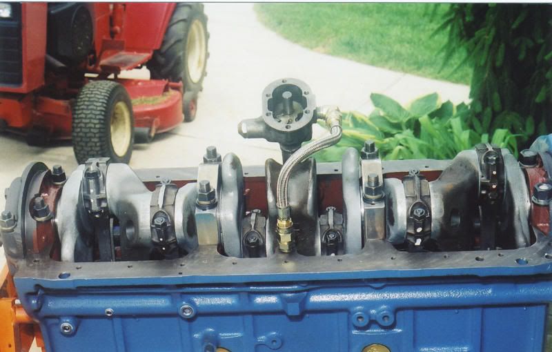

    Bob Arias custom pistons, '54 261 bored out to 280.
    GMC rods.
    GMC high volume oil pump.

    The man I bought the '54 from, a retired GM machinist, had this engine since, pause for dramatic effect, 1962. He had rebuilt it twice, the latest version around '00. He is a personal friend of Bob Arias, he said he poured a mold of the cylinders and sent them off to Arias and this is the result. Bored, stroked, ported, Clifford cam, Glyptal, ARP fasteners throughout, the man was thorough to say the least.
    I "found" this engine for sale on the Inliner's site, and I thought it was a great buy. The engine only has a few hundred local car show miles as the man is well into his seventies and went to a built-up 292 to go the air conditioning route, thereby freeing this one up for sale.
    I regret to say that this engine may be 'too much engine for me' as I am a true daily driver only vehicle guy and am mainly interested in greater 'punch on the on-ramp' over my present '56 235, 848 head, fentons, '62 3sp+od, etc. I am presently having the mill evaluated by a local old engine god for pump gas as George, the man I bought it from was a fan of aviation gas, readily available in his hometown of Flint, MI. I regretfully found this out after a 9 hour trip with a buddy to pick up the engine. I may be overreacting, but if it's too much of a process to go with regular I'll place it in the want ads as I have another 261 that I can go to that will fit my needs.

    Hey Cosmo, I meant to ask, does your oil pan still work with the ARP main studs? Does it interfere or maybe the previous owner modified it to fit? I'm curious to know.
    Secondly, how many cubic inches is this thing now anyway? Sounds like a beast!

    Mark - its 280 C.I. - .125 up of my memory serves me correct.

    Yes, he did modify the pan, but that was for the oversize higher capacity GMC oil pump. The engine is 280 cubic inches. I brought my dual deuces on the vintage Edelbrock intake out to Michigan to hear it run. Those white poly spacers were used because the intake would not work with the PO's home-made headers. We gravity fed the gas and it actually ran, but without the advantage of fuel under pressure we couldn't goose it to make the cut-offs rap. It did idle very smoothly though.
