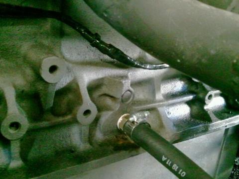

  5. 91whitestang
    Joined: Oct 6, 2009
    Posts: 232
    91whitestang
    from Wisconsin
    Here is what my pin looks like currently....
    Is that considered to be the IN position or OUT position?
  6. Snarl
    Joined: Feb 16, 2007
    Posts: 1,639
    Snarl
    It is in the out (flush with the end of the block) position, which is byp*** filtration. Moving the pin in about 1/2" to get full flow filtration is a big PITA. I've heard of guys breaking the block trying to do it. Your call.....

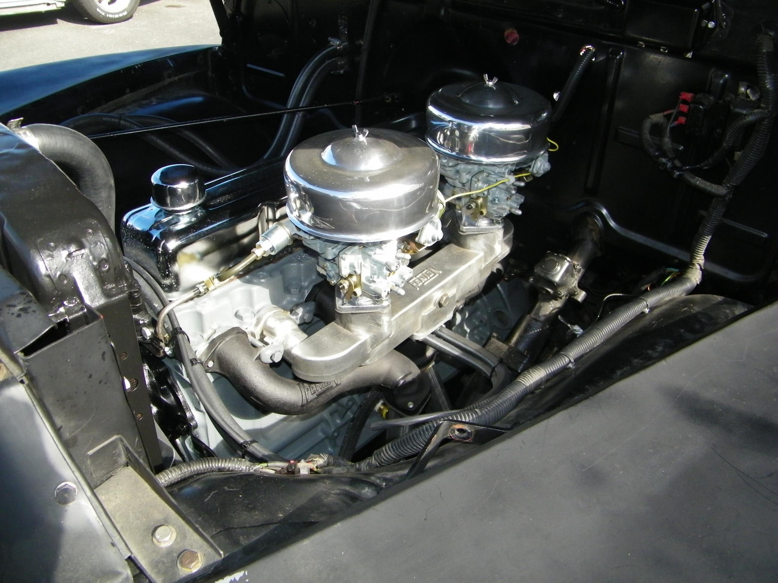

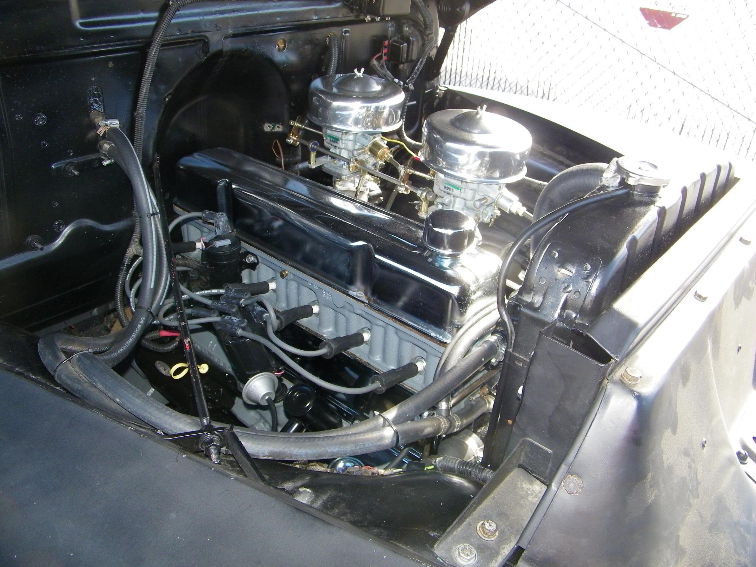

    Just finished installing a rebuilt 261 engine in my '55. Its now a great driver.
      457.8 KB
      387
      499.6 KB
      412
