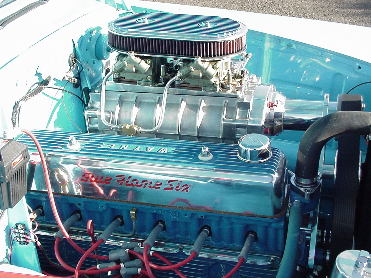

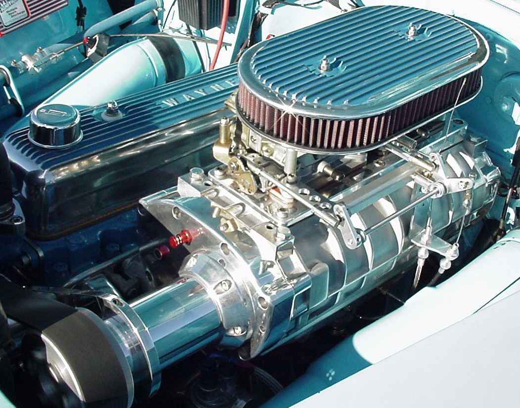

    This is a great thread!!...don't know why I didn't see this thread till now.
    YES, I put a blower on my 261. Basics: The blower is off a GMC 8V-53 that I reworked, then had to make the gear cover, snout, drive ***embly and carb adapter...oh and the air cleaner to match the Wayne valve cover (there's an extra 10HP, LOL). The blower manifold is from Larrowe, but it's reworked for the 8V-53 and I've got two Holly 500cfm "faucets" on top. The block is .060 over, uses Ross pistons set up for zero deck using GMC 302 truck rods. I m***aged the **** out of a 848 head to get better flow, good quench and bigger valves, which are tickled by a Reed custom grind solid lifter cam.
    The motor is under the hood of my 54 Chevy, with a Th2004R behind it and a posi rear end from a 55 out back. I don't have dyno numbers or 1/4 mile times for this combo, but it sure pushes my 3650lb car around easily as if it were a lightweight and surprises a lot of folks, especially when they find out she's an ole straight SIX!
    If anybody wants more detail or pics, let me know.
    6-bangertim likes this.

    Interesting supercharged engine....I see your engine has an external oil line for the rockers? Any special reason,or just because you can? :D

    Seemed to have weak oil flow through the internal p***age, so I added it.
