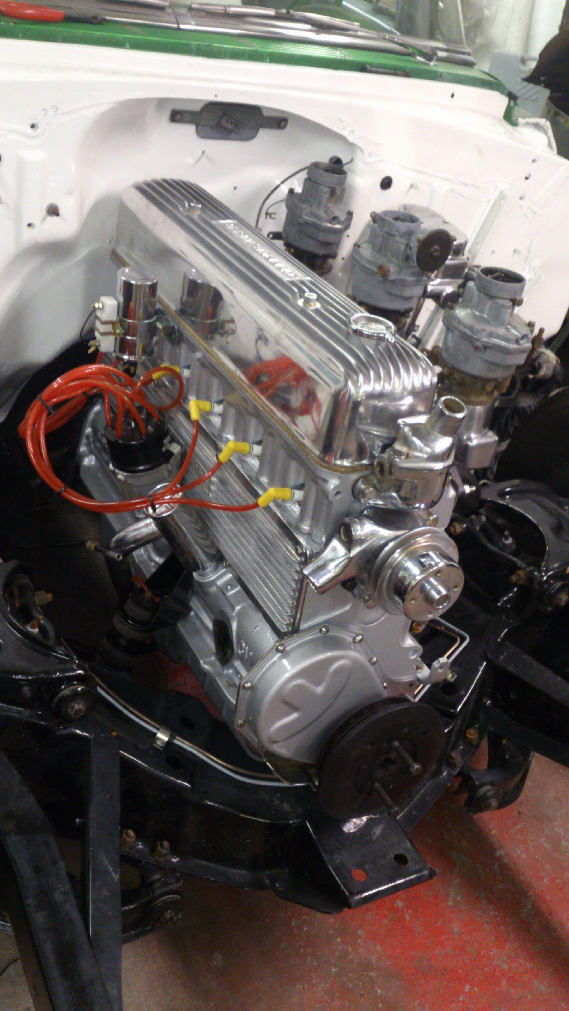

    Time to wake up this fantastic old thread and show my progress!
  27. man, that looks nice!!
