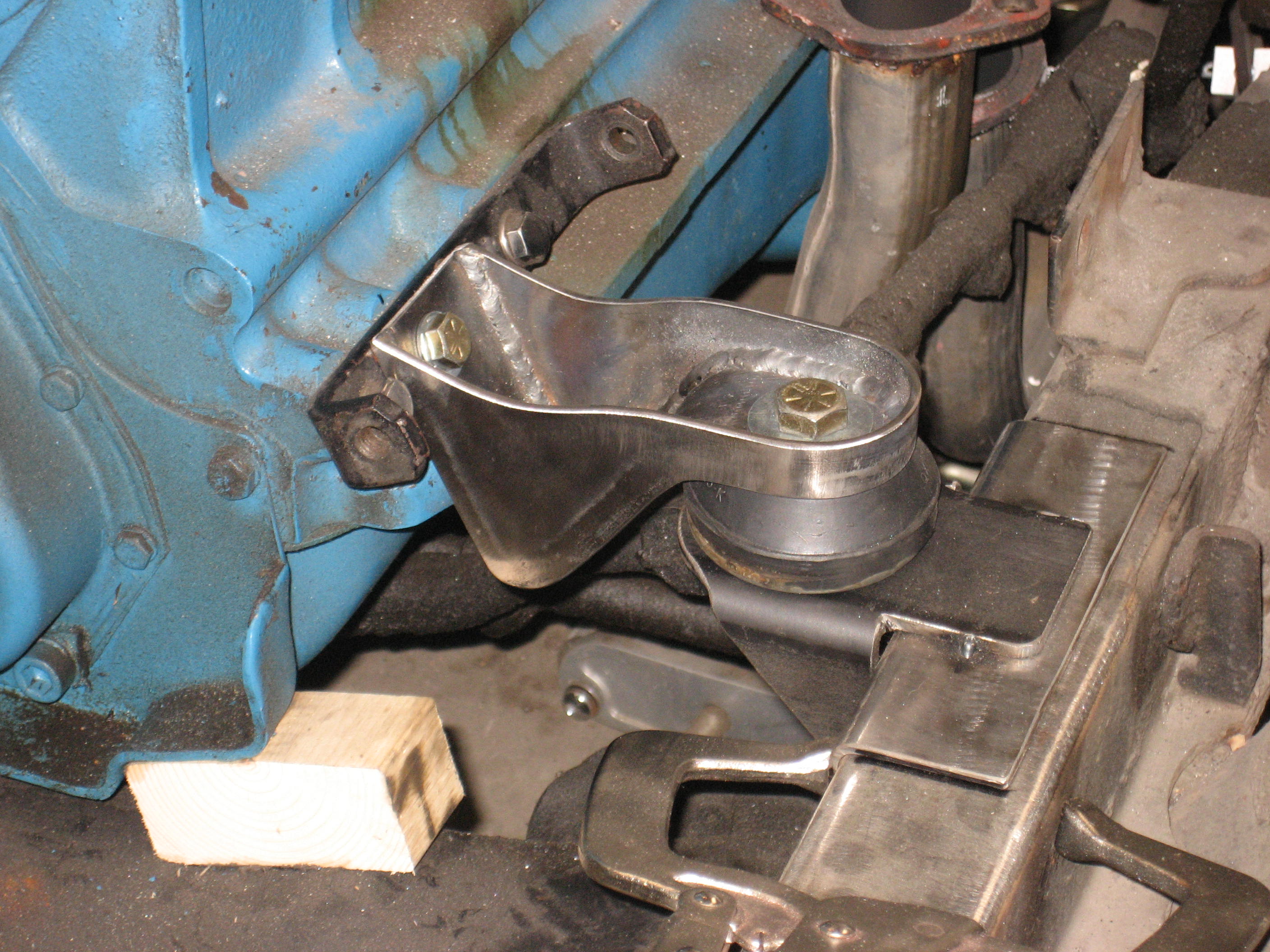

  11. I built the 261 for my '54 sedan, about 14 years ago. Since the initial build, I've gone back through the engine and made some upgrades.
    The initial build included re-grinding the crank, reconditioning the rods, boring and honing the block to .080" over, etc... The cylinder head is a completely rebuilt '54 power glide head with the steam holes drilled and some mild bowl and port work. I chose the Howard's "3/4 Race" cam and tubular pushrods, from Patrick's.
    After the first build, I was running an Offy dual intake with two Rochester single barrel carbs, and a pair of Clifford's shorty tube headers. I rebuilt the stock Delco distributor and put in a Pertronix conversion. The engine ran well in this configuration.
    A few years back I decided to make some changes to the car and figured that would be a good time for some engine updates too. The engine was completely dis***embled and cleaned, and I plugged/ drilled and tapped the oil p***ages for full pressure oiling. I machined the block to accept a Ford Power Stroke one-piece rear main seal, to eliminate the old rope seal. I also modified the Offy intake and added a spacer between the cylinder head and the thermostat housing, so I could run coolant through the intake. I ditched the Rochester carbs and bought a pair of Carter-Weber progressive two-barrels from Langdon's Stovebolt.
    I decided this would also be a good time to build some new front engine mounts. I had been using some crude mounts and hockey pucks. The hockey pucks are not very forgiving and transferred a lot of engine vibration through the entire car. The new mounts I built use cushion mounts.
    The other major change I made was swapping out the Saginaw 4 speed for a rebuilt S-10 T5 with mechanical speedometer.

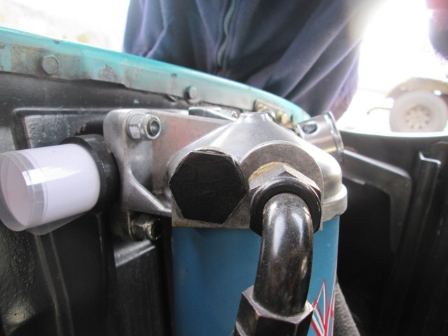

  29. This is a little off topic:
    I am in need of a 58-62 261 oil filter ***embly
    Full flow oil filter
    Uses same canister as V8
    See photos
    I have posted this in the wanted section as well.
