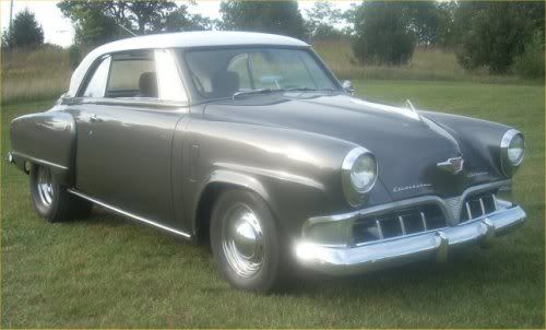

    Here's the car, a few projects left to do. I don't give a turkey what the MC looks like, I want a well engineered car. A plastic resivoir would not be the only HAMB unfriendly piece on it.
