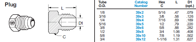

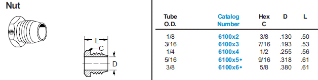

    Could he have used this? They both have the same thread size 3/8-24 for 3/16" tubing. The first picture is your threaded sleeve nut. The second is a 45 degree flare plug. Hopefully I am thinking along the same lines as you. :cool:

    That's really close to what I have! Mine just doesn't have the flat areas at the beginning and end of the threads. It'll would probably work! :)
    The only reason I got myself in this problem is I ****ed up one of my fittings while soldering it closed. :( I did find I can order the 6100x3 nuts from Fastenal. So, I can give the soldering another whirl! :D
